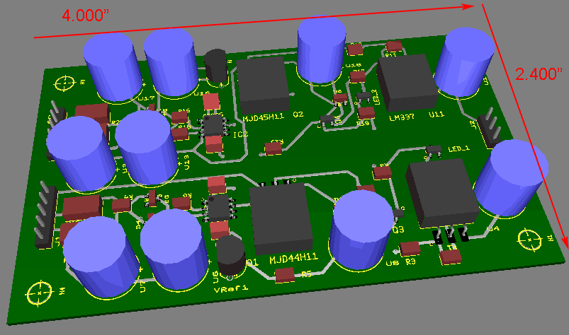

I have made a new super regulator board with a 4-layer pcb. I haven't had the opportunity to test it particularly much but so far it looks good in more than one sense.
Now the regulator can cope with 50 V in and 36 V out without too much trouble. It's also easier to trim the output voltage. The copper thickness is 140 um for the power traces since they go on both sides which have 70 um copper.

No, I got sidetracked with the LME49600 buffer design -- I think that one should be put to bed, fwiw.Has your design seen the day of light yet?
I want to do some more work on the PCB, ground plane etc. before I send out the design to be burned.
