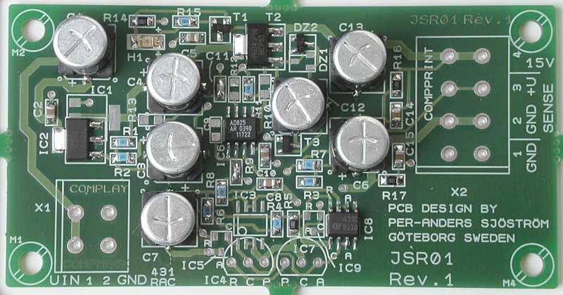

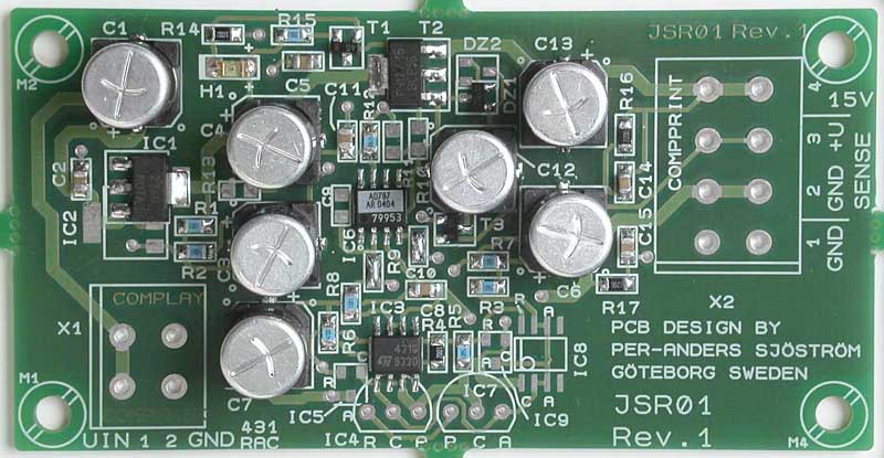

Somewhere here in this thread someone claimed that it was impossible to make an universal pcb for both positive and negative voltages.
http://www.diyaudio.com/forums/showthread.php?postid=268689#post268689
Parts which are doubled: LM317/337, the reference (not entirely neccessary) and the zener. Other polarized parts ahve to be turned around, caps and LED. The only thing you may fear is the 431 which is displaced quite a bit in the negative version but you can always choose an another reference.
Isn't this task rather easy when you see the pictures?
This is the positive regulator.

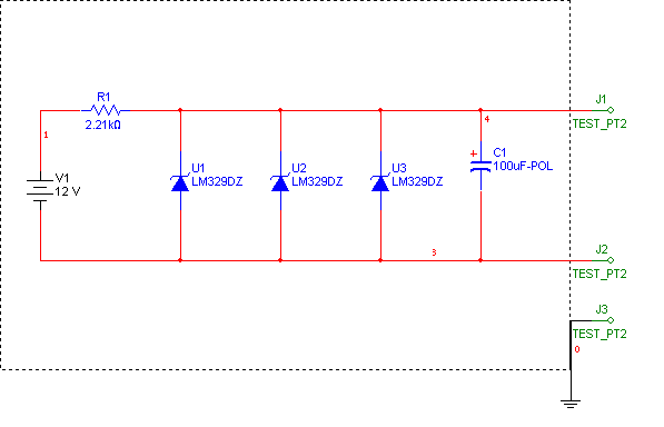

why the multiple references? -- before filtering a single LM329DZ has noise of about 30uV, two in parallel bring it down to 20uV -- a third is overkill, perhaps about 1uV effect.

I read that articles on your several permutations of the super-regulator -- I have nothing against the LM431 -- it just has to be compensated or it will oscillate.
Here's the setup I used to measure the LM329's -- the devices are housed in a cookie tin, balanced outputs are fed into my r.m.s microvoltmeter via Pomona RG58 cables. the tin itself is grounded to the voltmeter. with the inputs shorted inside the container the ambient noise is less than a microvolt.
with 1 diode the noise is ~31uV, with 2 it is 27uV, with 3 it is 10uV.
if you have a bunch of LM329's however, the noise will vary -- I don't think that this device was built like an REF-01 which has highly repeatable characteristics among a "bin" of devices.
I will repeat the tests with LM431's, REF-01's.
