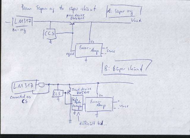

here is a conceptual sketch of my idea. If there is some interest in discussing it, it might be best to split this into a new thread, if not, its a footnote...
Please note that my circuit is not the ALW circuit, but the 2002 jung-didden circuit.
Is my thinking correct, that we need an additional 'beta-booster'?

@Per-Anders: I tried a simple one-fet amp with LTSpice, but even don't get the DC-operating points, let alone square wave response or the like...

You must also have a DC source. Right know I don't remember if you can get AC+DC from the voltage source or if you have to fix it with some addition.
Please do start a new thread.

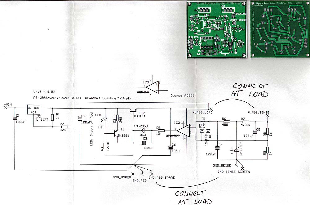

i use the attached board. It is very similar to alw's version, but it does not have the extra driving transistor for the pass device, T2.
I had a ztx450, so I added this transistor in the place of R5 (10R) and changed R3 from 249R to 100R.
It is the almost the same circuit now. but it does not work, I get 6Volts out instead of 15V.
What happens there?
Rüdiger
What happens there?
Rüdiger

aos' boards are cheap and no support is included what so ever (this is clearly stated but not very good when support is needed
Have you checked the pinning of the small signal transistor?
American types are E-B-C, european model C-B-E

hard to believe that this thread has gone dormant -- my super regulators with through-hole devices work just fine but the version i built with surface mount components (substituting MJD44H11 and MMBT5087, smt leds, zeners and clamp diodes etc.,) suffers from the "false-start" syndrome -- the footprint is 3.5 x 2.5 inches for one board with positive and negative regulators.
peranders said:
Anything to show?
yes, the output voltage is 2.19V, just as Mark Kovach had written in Audio Electronics -- i suspect I made a mistake somewhere -- for the through-hole devices I get +/- 13.775V.
Here's a picture of the negative side regulator -- this is a proto with no silk, and I think I will go to SMT LM337's -- the size can probably shrink by 25% or so -- I've provisioned for the +/- SENSE wires but they are jumpered here:
Can't see but have you an emitter follower down to ground from the opamp output? The zener arrangement should create 7-9 volts at the output in order to give supply voltage to the opamp. Have you as a test tried to feed the opamp from the unstablized side (after the LM337)?
PA -- I found the problem -- the positive connection of the capacitor (C7) connection to the AD825 IN+ was faulty. It won't start if this connection isn't secure.
