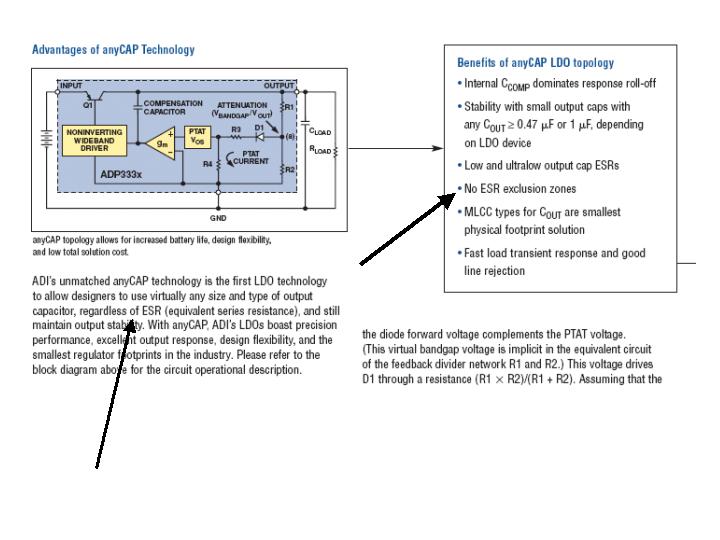

Well, Millwood, I noiticed that your quotes, although you give the impression that they support your idea that ESR is not needed, don't address ESR. So, I'm at a loss what this is supposed to mean.
Since you seem to have unbounded trust in Application Engineers, how about this:
http://www.analog.com/UploadedFiles...541217020958034433123764LDO_BrochureFINAL.pdf
I just cut out the first mention of ESR in the attached jpg. Have fun.
Jan Didden
Jan Didden
Jan, you couldn't have been more wrong in your impression of my position on ESR. You are advised to read earlier posts of mine where I clearly stated my position.
My attempt at presenting the National paragraph is to highlight the fact that we shall not rap scientific theories into supporting our conclusions (aka the high esr/ esl combination).
Not to mention a certain statement made earlier by someone with regards to the number of application notes on low ESR caps is not supported by National.
I could not get why are you all mill the wind with ESR.
We need a zero in loop gain, and we get it either by finite ESR or by other means.
From AN-1148: "National Semiconductor does have LDO regulators like the LP2985 and LP2989 which are specifically designed to work with extremely low ESR capacitors like surface-mount ceramics. This type of capacitor can have ESR values as low
as 5-10 m, which will cause most typical LDO regulators to oscillate.
To make the LP2985 stable with such low ESR values, an internal zero is built in which takes the place of the ESR zero previously provided by the Tantalum output capacitor. The effect of this is to shift the stable ESR range downward. A typical LDO with no added internal zero might be stable ESR range from about 100 m to 5 (well suited for Tantalums but not ceramics). The stable range for the LP2985 extends down to 3 m, and has an upper limit of about 500 m so it can be used with ceramics."
The app note references being quoted seem to all apply to the monolithic low dropout regulator, where the pass transistor is operated in common emitter mode and is a lateral PNP for the positive regulator case. This is really a somewhat different problem than the super reg topology. For the low dropout case, the open loop output impedance without the load capacitor is on the order of tens of kOhms, while for the super reg topology the open loop output impedance without the capacitor is on the order of tenths of an Ohm. Also the low dropout regs have a second pole at a few hundred kHz due to the lateral PNP, while the super reg uses a pass transistor deliberately chosen for high ft, avoiding this issue. The analysis of the low dropout regulators seems to neglect the series inductance of the load capacitor as well. The OnSemi app note quoted earlier shows in figure 5 a unity loop gain frequency of 100 kHz or so. We're looking at numbers more like 1-10 MHz for the super reg topology. So whille many similar considerations apply between the two topologies with respect to the load capacitor, it would be a mistake, I think, to make a blanket assumption that what works well for one will automatically work well for the other. We have a factor of 10-100 difference in bandwidth between low dropout and super reg to consider, for one.
If I mis-represented you, I apologize. I admit that I most of the times don't re-read the whole thread. Sometimes your posts are really cryptic. Like the 2nd part of the quote above. What the hell does that mean???millwood said:Jan, you couldn't have been more wrong in your impression of my position on ESR. You are advised to read earlier posts of mine where I clearly stated my position.
