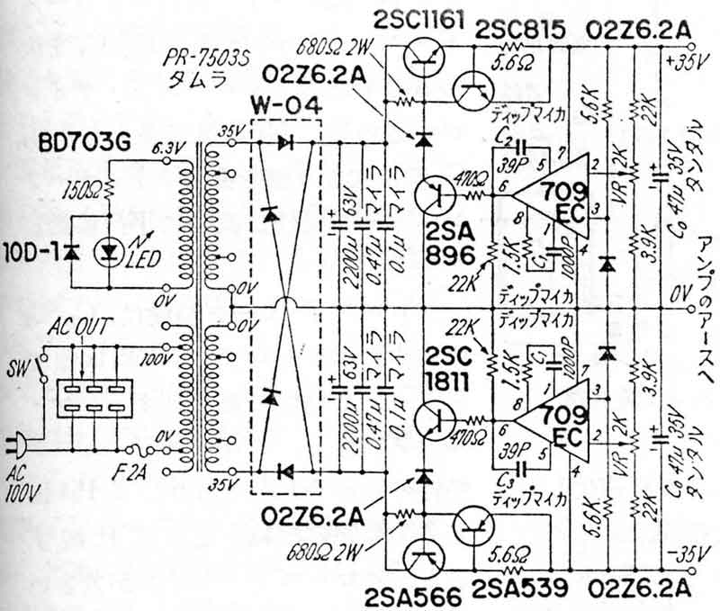

While reading here http://tangentsoft.net/audio/opamp-linreg.html, I noticed the 2000 Jung revisited version is different from the EDN one.
One notices the extra PNP (for positive version) driven by the opamp.
Any reading material on this development; why was this extra bjt included (error is multiplied with even more gain) ?
Q2 allows the error amp to bias the pass transistor very fast, improving the ripple and dynamic performance. As the load varies at the error amp inputs it will change the current flow for the base of Q1.

"Q2 allows the error amp to bias the pass transistor very fast, improving the ripple and dynamic performance. As the load varies at the error amp inputs it will change the current flow for the base of Q1."
The additional follower does drive the output with a lower impedance than the open loop output impedance of the op amp alone helping to move the additional phase shift from the output transistor to a higher frequency. It also increases the linearity of the op amp since the impedance that output of the op amp sees is higher by a factor of the Hfe of the buffer transistor. "In loop"buffers have been used for audio op amp circuits for quite some time now to decrease distortion by greatly increasing the impedance the op omp
output stage has to drive.

Fred Dieckmann said:The use of a high Hfe pass transistor or even an additional follower between the op amp and the pass transistor is worth investigating ( big hint.......fet). The less output current the op amp has to deliver, the more linear the regulator is and lessit modulates its own supply voltage terminals

The original idea from Mr Jung I believe, was low noise AND low output impedance and a mosfet has higher output impedance than BJT. I'll guess that you also get a slower output stage so the benefit of a "electronic" capacitor will be less. An advantage though, it's easier to get more current out of the regulator.
A more original is from Kaneda 1977 and he used parts which were available at that time. 1977 the 709 was "hot" but he had also 741 to choose from. 😀
If you compare Walt's design with this earlier you'll see small enhancements but important ones.

I think the main difference between those two is the output stage.
Mr. Kaneda's circuit is exactly as Jung's excluding the improvements. I'll guess you are joking?Fred Dieckmann said:I think the Sulzer design is a much more solid foundation to build on for very good regulator design than Mr. Kaneda's implementation
