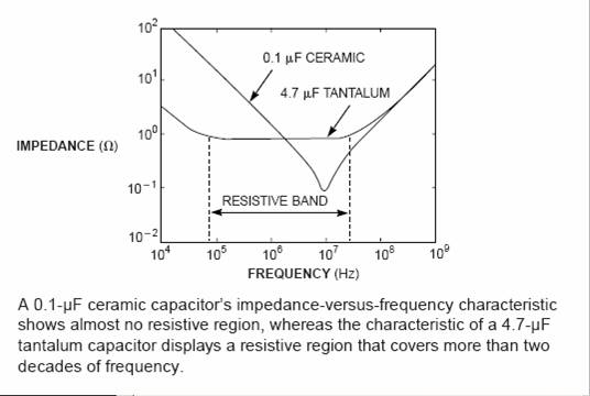

Empirically, throwing a big old crummy cap into these situations often greatly improves stability. In an EDN article, Bob Pease looked at this situation in a daisy chain of ICs, each locally bypassed with a ceramic, taking into account the inductance of the daisy chain; his recommendation, if I remember right, was to stick a tantalum cap on about every fifth chip.

I don't think those numbers are realistic for a 3300uF cap. It's hard to find good cap data, but I did find data on the Rubycon web site for a 100 uF cap similar to what ALW uses in his super reg. In the voltage rating I was looking at (which happened to be 160V), the series resistance was about 0.25 Ohm, and the series resonant frequency was about 100 kHz, which comes out to be about 25 nH series inductance. Cornell-Dubilier has an applet which gives capacitor parameters for their big cans, but I haven't looked at the data.
The problem with very low ESR is this. At the series resonant frequency of the cap you get a pure resistance Resr. If we assume a resistive output impedance Rout of the emitter follower, then the loop gain will be attenuated by -20 log(Resr/(Resr+Rout)) dB at the series resonant frequency of the cap. If this attenuation is more than the value of the loop gain without the cap at the frequency of the series resonance of the cap, the notch from the series resonance will force the magnitude of the loop gain to be equal to one (0 dB) at a frequency somewhat less than the series resonant frequency of the cap. But at a frequency less than series resonance, there can be considerable phase lag from the cap, 50 degrees in our example. This can and will destabilize the circuit. Even if it doesn't oscillate, it will ring with transients of load current.
But as the ESR increases, the depth of the notch decreases and the notch becomes much wider. If you only get, say, 8 or 9 dB of attenuation at resonance, this may be enough to prevent the magnitude of the loop gain from crossing over 0 dB at or below resonance, and this is a good thing. Then it won't be until well after the cap becomes inductive that the loop gain crosses over 0 dB. This can be very good, since the inductance of the cap can actually contribute some phase lead to the loop gain right where the op-amp phase is getting a little squirrely. But if you've got a low ESR, you can't make it any bigger by putting other caps in parallel with it.
I liked Fred's earlier idea of an ultra-low ESR cap with a small series resistor of a few tenths of an Ohm. This way you know what your ESR is very accurately and can design your circuit for stabllity with that specific value in mind. I don't know of any ultra low ESR high-voltage caps (160V) which is what I would need in my power amp super reg.
The geometrical size of the cap has a lot to do with it resonance and ESR performance at a particular frequency. Most electrolytic caps turn into inductors at high frequencies so their very poor for knocking down HF noise, which makes them bad bypass caps. While it may be possible to make a circuit oscillate with a low ESR cap the value of the cap or it’s size in farads most certainly in most cases damped this effect again depending on the geometrical size. However, when using electrolytic caps out side their frequencies capacitance range it is possible to have surprises.
Most of the low ESR caps I have use are tantalums these are used to remove noise from switching supplies and digital circuits. Of course tantalum like electrolytic have their range over frequencies that they operate at and it is related to geometrical size of the caps. Even small value electrolytic and tantalums do not do well pass 5 to 10 MHz.
Anyway, for these type of bypass to be effective at higher frequencies they should be bypassed with a ceramic caps if the noise spectrum is broad and with HF energy

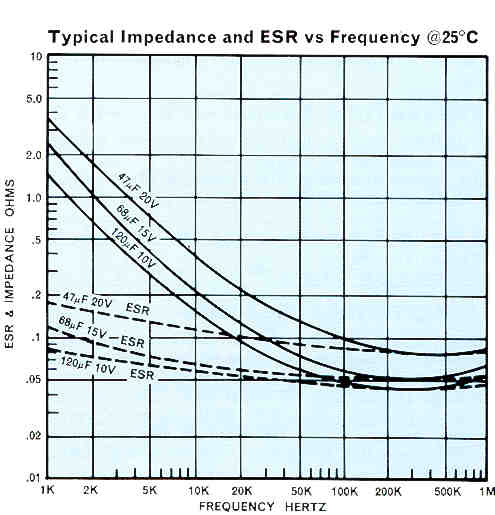

Well I added a 68uf low ESR tantalum in parallel with the 47uf that in the circuit and no oscillation. Its’ time like this it would be nice to have that 10u volt per division amplifier that Tektronix use to make for their 7000 series scopes. I only tried this on the negative supply where he opamp runs in inverted.

jewilson said:Well I added a 68uf low ESR tantalum in parallel with the 47uf that in the circuit and no oscillation. Its’ time like this it would be nice to have that 10u volt per division amplifier that Tektronix use to make for their 7000 series scopes. I only tried this on the negative supply where he opamp runs in inverted.
Is this a super reg topology? Anyway, you really had me stumped there. I'm not real familiar with the properties of tantalum caps, since my own searching was for a high-voltage regulator where I needed 160V units. Anyway, I dug up this 1998 article from EDN here http://www.reed-electronics.com/ednmag/archives/1998/102298/22ms402.htm. I've attached a picture from it. I haven't been able to find impedance plots for any 47 uF tantalums though. But judging by the plots below, the tantalum caps aren't low ESR at all. In fact they look like a really excellent broadband resistive impedance, just perfect for this application. The plot of the ceramic looks almost exactly like the Kemet pic.
Ahh, nice picture! So it looks like the unity loop gain frequency will now be above the series resonant frequency of the cap in the 47 uF case - which will give a stable circuit. Thinking about it some more, the "low ESR = bad" is really an oversimplification. The lower the series resonant frequency of the cap, the lower the ESR you can get away with.
Thanks for posting that. I couldn't find the graphs on the Cornell-Dubilier web site.
