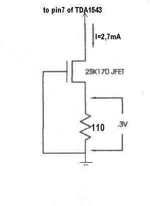

This is the CCS proposed by Stefanobilliani, but the current drawn is too high , since Ibias has a maximum of 5 mA and Ibias = 2* Iref.
I'd suggest the use of a CCS with a current of 1.5-2mA
Cheers
Andrea
Cheers
Andrea
When you use this current source is important to note the voltage across the resistor and choose the resistor by consequence , since 0.3V is a "typical" value and vary between devices.

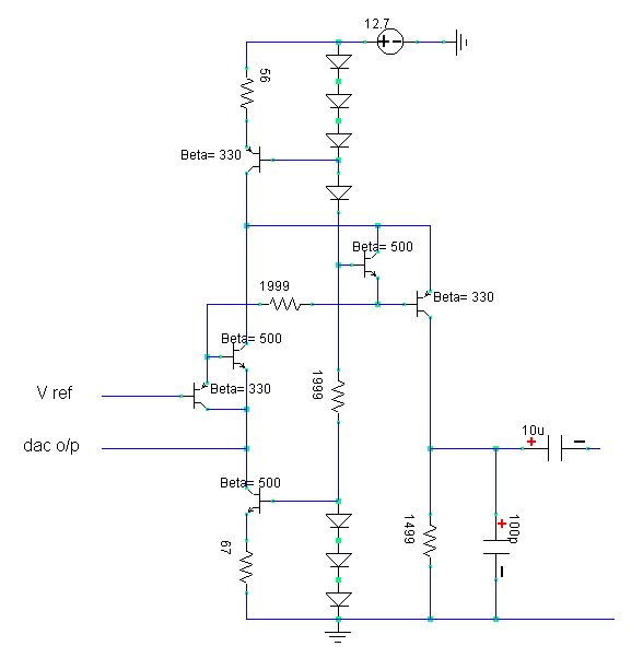

12.7V version for 1543/3 ?
I worked out this version for my 1545 that I think will work for 1543 aswell.
I wanted something that will run from a 12 volt battery
As I need a cap on the o/p anyway to protect my transformer volume control from even the tiniest amount amount of DC I just settled on a big offset at the output.
It measures very well in simulation.
What do the experts think ?
does it pass ?
any drawbacks ?
