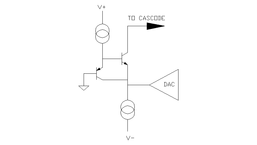

I will use a neg supply! I'm talking about the circuit Rudolf posted on this thread (not the single supply one, the folded cascode one!)
To attach a file, when you're typing your message there's a "Browse" button, just over the "submit Reply" one. Attach a file with it. As peter said, not all file formats are accepted. You have to limit the graphic and file size too, I think it's 800*600 and 100kb.
I'm not sure I understand your answear. The reference schematic is this one, what modifications should be done to put I-dac on 0V?

Hi Bricolo,
OK, all is clear.
To move virtual gnd to 0V just omit D2, D3 and R1. Base of Q2P
will then be grounded. Emmiter Q2P = +0.7V so Emmiter Q2N
goes back to 0V.
Note however that the VBE of Q2P and Q2N will not be
exactly the same due to different voltages across them.
However this will be cancelled out to a degree because
Q2P is run at much less current than Q2N.
My guess is that it will be within 20mV of gnd.
Terry
In my simulations, it's not within 20mV of ground, but rather 50mV
And the TDA1541A has a voltage compliance of 25mV 🙁
That's why I wanted to be able to ajust it precisely.

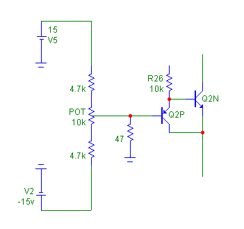

Would it not be OK to have resistor chain between the rails, two fixed values to the rails with a variable one in the middle that covers the critical area with a cap from the wiper of the trimmer to earth to deal with any noise and a connection base of Q2P also to the wiper of the trimmer.
This is a very simple possible solution - are there any drawbacks ?
Of course it will need to be carefully set initially but I think it should be OK if the cct's are left switched on.

Finally a solution 😀
I would do something like this (capacitor from wiper to ground can be added):
That's what I proposed some posts before (except from the 47R resistor and the cap)
But this would have a much higher impedance voltage reference than the diodes. Isn't this a problem?
Bricolo said:That's what I proposed some posts before (except from the 47R resistor and the cap)
Bricolo,
Stop simulating, stop worrying, start soldering
What is the problem with 47R at base of Q2P?

For your info, it does simulate fine, for as much as we can rely on distortion numbers from a simulator...
Real life measurements showed about 35mV for VBC(Q2P)

I don't know what's wrong with it.
My question was if it is better to have a low impedance voltage reference from Q2P's base to ground.
I think it is (but maybe you have another opinion), so the voltage divider isn't optimal 🙁
Bricolo,
47R is absolutely OK from base to gnd. Believe me! 🙂
Now build that damn thing
