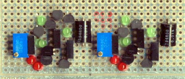

jean-paul said:I only see 4 LED's on the PCB, that's why I ask. In your schematic I see 5 LED's ( 3 green ones and 2 red ones ).
BTW since the servo is omitted maybe it is better to use an output cap + resistor to ground after it ? Could you repeat the adjustment procedure in this thread for those that don't know the Search function ?
edit: I checked again and I now see that there are 2 LED's D3 in the schematic ...

Peter also has 3 green leds
It seems that the other D3 is a green led

Who needs an eye exam ?!?! In the schematic there are 2 red and 3 green LEDs per channel, OK ? Then I look at the pic of Rudolfs PCB and I see 4 red and 4 green LEDs total. Mmm that should have been 4 red and 6 green ones if the schematic is right. Scott, you say that you clearly see 8 LEDs on Rudolfs PCB. I hope you agree with me that that should have been 10 in total for both channels according to the schematic.
Check for yourself please if what I am saying is right. The confusion became bigger after me asking what diode D3 is because there are 2 pieces D3 in the schematic....
Peter has 6 green and 4 red LEDs on his Veroboard
He probably followed the schematic like I did.
Confusing to me, maybe to others as well. I don't care about schematics but the picture confuses me.
I think I'll stick with opamps
Maybe one of the LEDs was hiding behind a capacitor on the picture
Indeed, I suggest to stick to opamps or passive, much better and less confusion
BTW, for more confusion, the current board has:
8 red LEDs
2 4148 diodes
