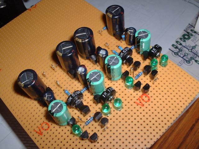

The one I built has some small differences with Rudolf's schematic (mostly because I had difficulties to find some parts)
-the 1st caps are 680uF (the green ones will be changed to 470uF when they'll arrive)
-transistors are BC550C BC560C, except for the 2 japaneese that are 2Sc2547 and 2Sa1085
-the 2nd CCS is cascoded with a J309
-I/V resistor is a Dale CMF-55 1.24kR
-output cap (LP filter) is a 1nF styroflex
-the LM334 is replaced with a J309+110R (5mA) (the i/V is 100% discrete now 😎 )
-it will be used with a TDA1541; so D2 and D3 are replaced with a 47R resistor. Maybe I'll add a 100uF on it

I've built the IV some months ago, but it didn't work properly. After a couple of days trying to have ot work, it layed somewhere until today.
Now, I spent all the afternoon with it, still trying to make it work. But nothing helped 🙁
I still have a big (3.2V) offset at the output, the pot seems to be here to tune the offset, but with the pot at 100% (1k) there's a 3.2V offset
With the pot at 0, the leds shut down, and the offset goes up to 5V
But never zero inbetween
Does anyone have an idea, please?

OK, I found my error: I put the BC550 instead of the 2SA1085 and the 2SA1085 instead of the BC550
It certainly couldn't work this way 😀
But now, this thing oscillates like mad 😡
At powerup, it's 32MHz 3Vpp
When I touch some pins with a screwdriver, it becomes 64MHz 300mVpp
And back to 32MHz 3Vpp when I touch some over pins.
The oscillation even "goes back" to the psu, it's clearly visible on it. (my psu is made of 6 9V cells in series) I assume that the regulator isn't effective anymore at such frequencies, and that the caps aren't neither (I only use lytics, like in the schematic, no bypassing)
It seems VERY sensitive! When I touch the board, the DC offset changes. When I move my hand near the board, it changes too. I can even see the curve move on the scope when I'm placed 1 meter away and move my arms 😱
The DC offset isn't stable either, sice it changes with my hand's position it's hard to tune it with the pot. But even worse, if I switch it off and on again, the DC changes also a lot (a few hundred of mV)
One problem is solved, another shows up 🙁

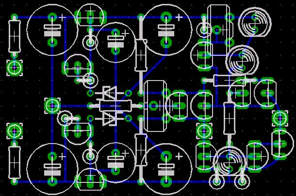

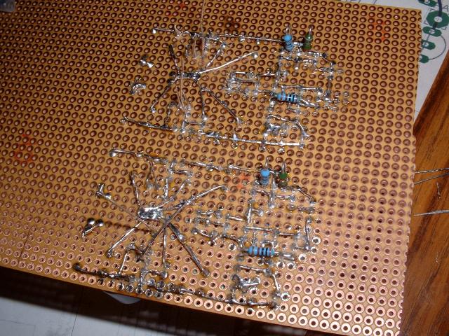

Here's my layout for the veroboard (IV resistors and capacitor aren't shown)
