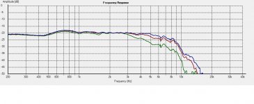

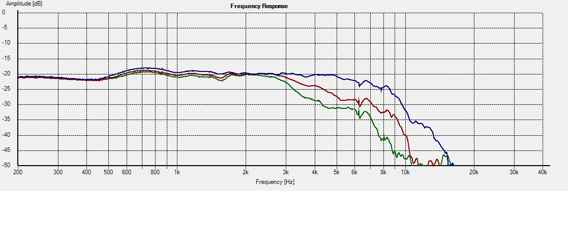

I would avoid any mid that has resonances in the 3~5 kHz range - sure, these can be equalized, but after equalization, there are still noticeable colorations, particularly in comparison to a ribbon tweeter. When drivers break up, strange things happen to dispersion (thanks to multiple emission surfaces on the cone that go out of phase with each other), and equalization cannot correct for dispersion anomalies.
Yes, I fully agree and that’s why I have chosen the ScanSpeak 15W/15M as the midrange for this project. Besides that it sounds absolutely wonderful it measures like a dream without any visible cone break-ups and it has one of the smoothest roll-offs I’ve measured. Picture 1 & 2 shows my measurements of the ScanSpeak 15W/4531G00 on an 8.5” baffle. I think these Scans could be one of the few drivers that has a chance to marry well with the RAAL:s.
Picture 1: No smoothing , Tweeter-axis, Blue=0deg, Red=15deg, Green=30deg.
Picture 2: No smoothing , Tweeter-axis, Blue=0deg, Red=30deg, Green=45deg.
