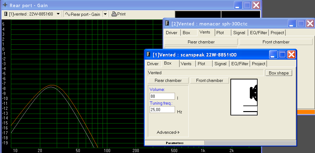

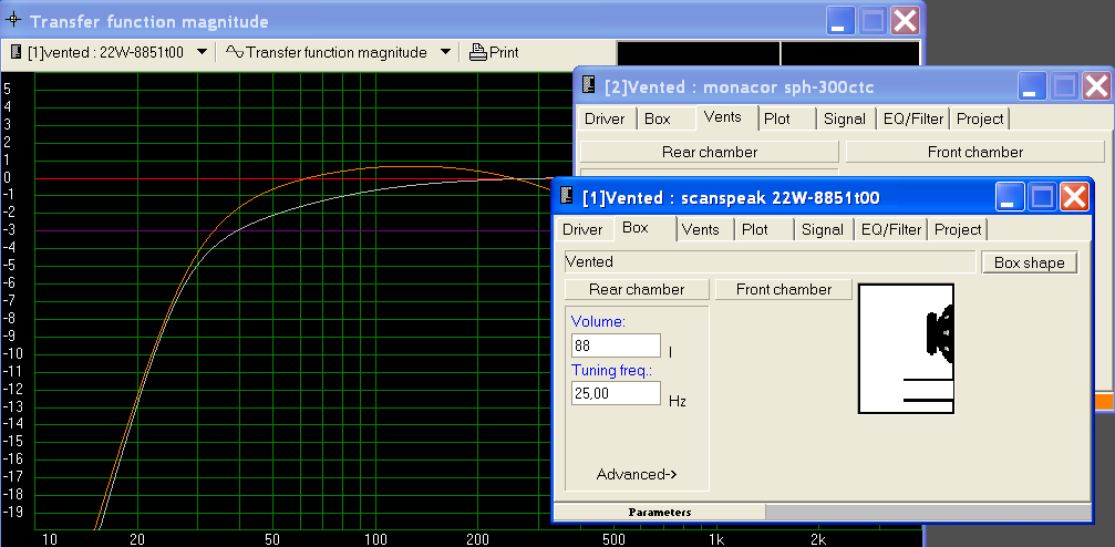

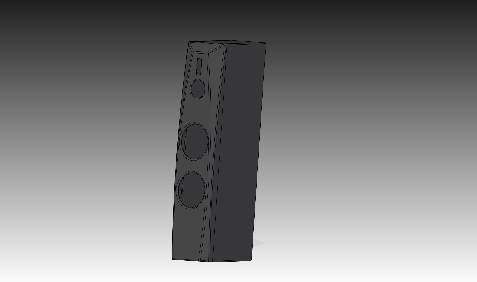

This is about how far I have come in my design sketching so far. I shall begin some box simulations for the above 3 alternatives based on the T/S parameter I have so far found in my research.
I will post the box simulations as soon as I can.
Regards
/Goran

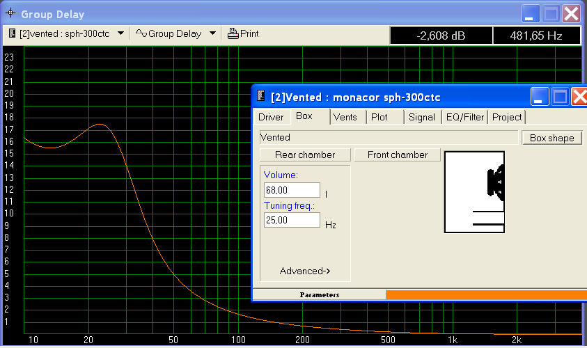

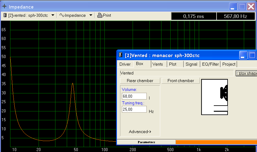

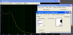

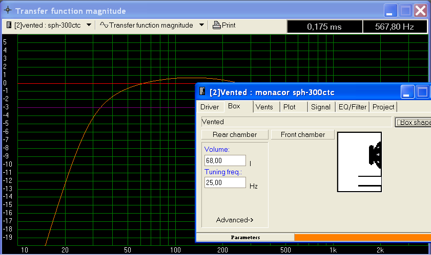

If it is gong to be "super high end", then the group delay, the impedance irregularities and all other weaknesses of the bass reflex enclosures should be excluded from the design, thus excluding the bass reflex option.
According to people like Linkwitz and E.J. Jordan, the best option is in wall speakers, second best is the aperiodic enclosure, third best is the closed box and OB or dipoles are as good as any of the three with some well known shortcomings. This is very generally speaking, but it's like this.
I would choose the sealed box option and use it with active crossover, separate amplifier and Linkwitz Transform equalization. Such enclosure can be very small, but then the power requirement would go sky high, 20 hz @ -20 db would require 100 times the power needed for equal SPL at the first frequency outside the equalized region. So with 90 db/w/m if 1 watt at 100 hz is enough for 90 db, at 35 hz you will need 10 watts and at 20 hz, you will need 100 watts for the same 90 db SPL. - The example is of an actual system that I design right now (12 in 35 hz Fs in 50L).
In my case, doubling the enclosure size (50 to 100L) nearly halves the power requirement and with the same power the system would be able to reproduce 16 hz at 90 db SPL instead of just 20 🙂
But if you use another driver, for instance 15 inch higher Qms, heavier cone, lower Fs (16.6 hz Fs to be specific), the power requirement goes even lower and now the same power is sufficient for 13.5 hz at 90 db and the enclosure is only 65L. That system would require only 20 watts for 90 db@20 hz and it is of the same size, but has much more headroom with 2.4 mm excursion at that level (2.4 out of 8mm total).
Such decision on the bass section design would require bigger midrange, but I better stop now or else I will redesign your system 🙂

Hi T101,
Thanks you for your extensive comments and calculation examples.
I’m aware of that the word “high-end” is a cliché word which means different things for different people and I might have used a to strong word “super” in my post title, but what I’m trying to do is designing a “high-end” speaker, at least by my standards. 😉
My reason for having the closed box alternative as an option is because I have the possibility to do both digital EQ and room correction in the low frequencies with my DEQX pre-amp.
The alu version of the 8” driver seems to be more suitable in a closed box alignment than the paper version. However the alu version do seems to require a larger enclosure. My idea is to reduce the box volume by approximately 20% in order to achieve the same internal box volume as the 8” paper version and then apply some EQ to achieve an extended low frequency.
That’s fine as long as I use some sort active electronics, but I also want to eventually build a passive version of the loudspeaker and without using e.g. the DEQX hardware. That complicates things a bit. Therefor I will probably build alternative 1 or 3 with the 8” paper cone. It’s more flexible in this way. First I could build a bass-reflex version and then if I feel for it, stuff the bass-reflex port and apply some Digital EQ etc. and then ”magic”, a closed box version 🙂
I haven't done enough research and simulations to be able to decide yet, but your comments were very insightful reading.

Yes, thank you. I've seen it and it looks like the design I might do, but with a different tweeter.
I must be realistic in what I can hand-build myself and the Sony enclosure design seems doable. 🙂

I'd be inclined to build it as a 2 part enclosure - the 2-way top section, and the bass enclosure.
It will make the build easier to deal with and also makes future upgrades easier.
I use the Scanspeak 15W in my surround speakers and enjoy them tremendously.
The Scanspeak 26W revelator I used in a previous design was also beyond reproach. My newer speakers use the Morel Ultimo which is getting into subwoofer territory.
My thoughts are that in the scheme of things, given the amount of time and effort put into a design, the driver cost is small.
You cant go wrong with the Scanspeaks.

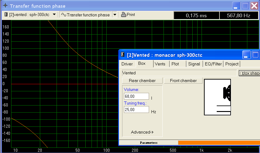

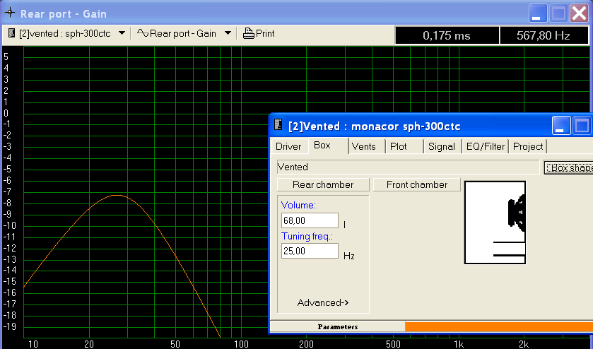

If you like real bass I mean subbas. A closed box will never be high-end without active correction.If it is gong to be "super high end", then the group delay, the impedance irregularities and all other weaknesses of the bass reflex enclosures should be excluded from the design, thus excluding the bass reflex option.
You can design a BR with group delay around 20Hz You cannot hear that, and have much better bass-response as you can get closed. I think closed box lovers confuse sub-bas with less controlled bas.
Here a example of a high-end carbon subbas monacor sph300ctc as you see the comment on the impedance and phase is wrong. Higher group delay as closed box only below 35hz. with the port placed on the back you get subbas down 20hz in 63 liter.
To make good basreflex you need a big port 30% or >Sd.

Here a sim of two 22w-8851t00 in a BR compared to the sph300ctc. As you can see they are quite similar.

This Monacor looks and sims pretty well, it might be a good candidate for the system discussed here since it has so modest enclosure volume claims.
But again, this impedance peak just below 50 hz frightens me. After I have listened to sealed, aperiodic and H-frame dipole bass, the reflex enclosures loose their appeal to me more and more.

- Super High-End 3-way floor-stander
