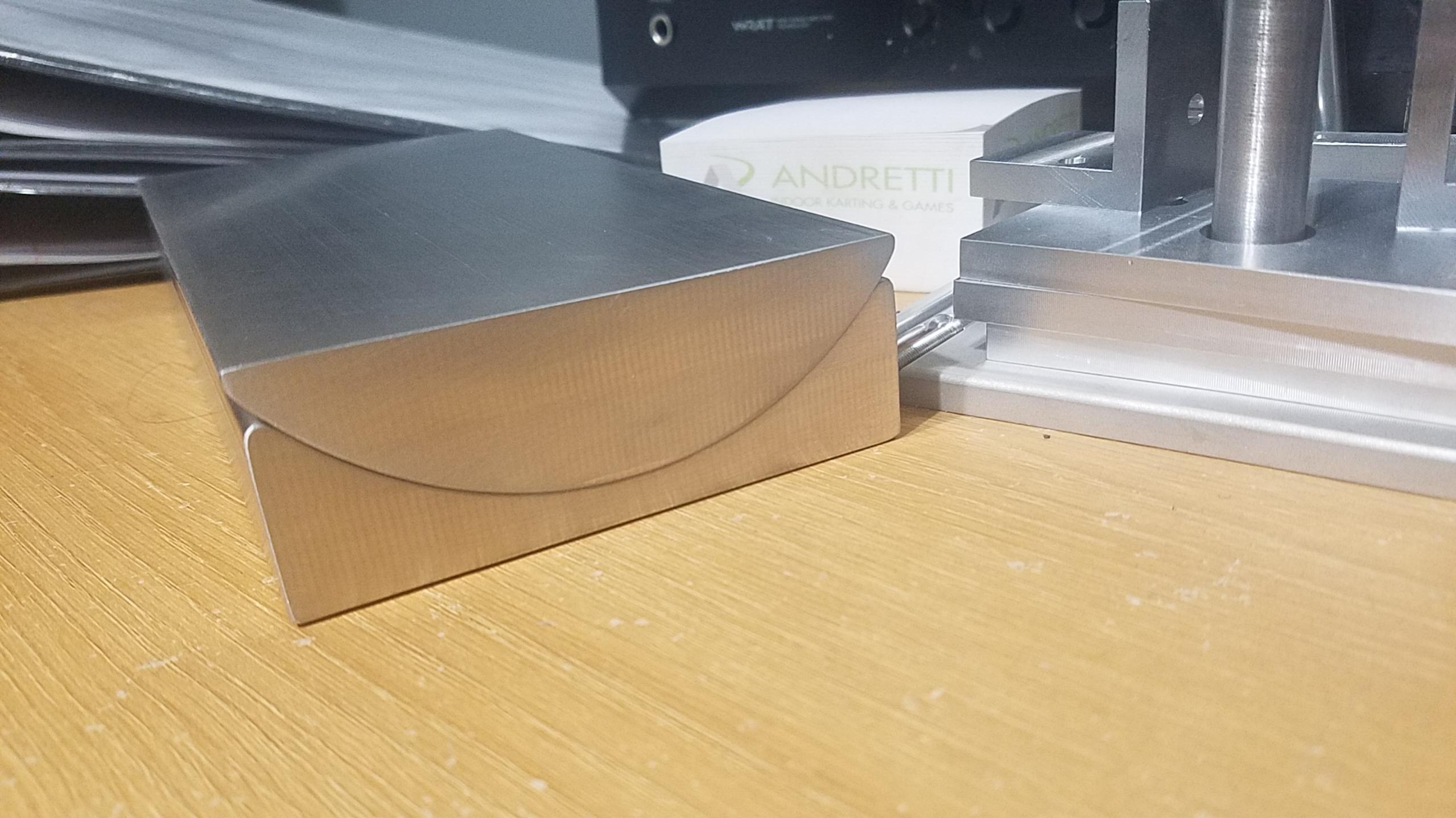

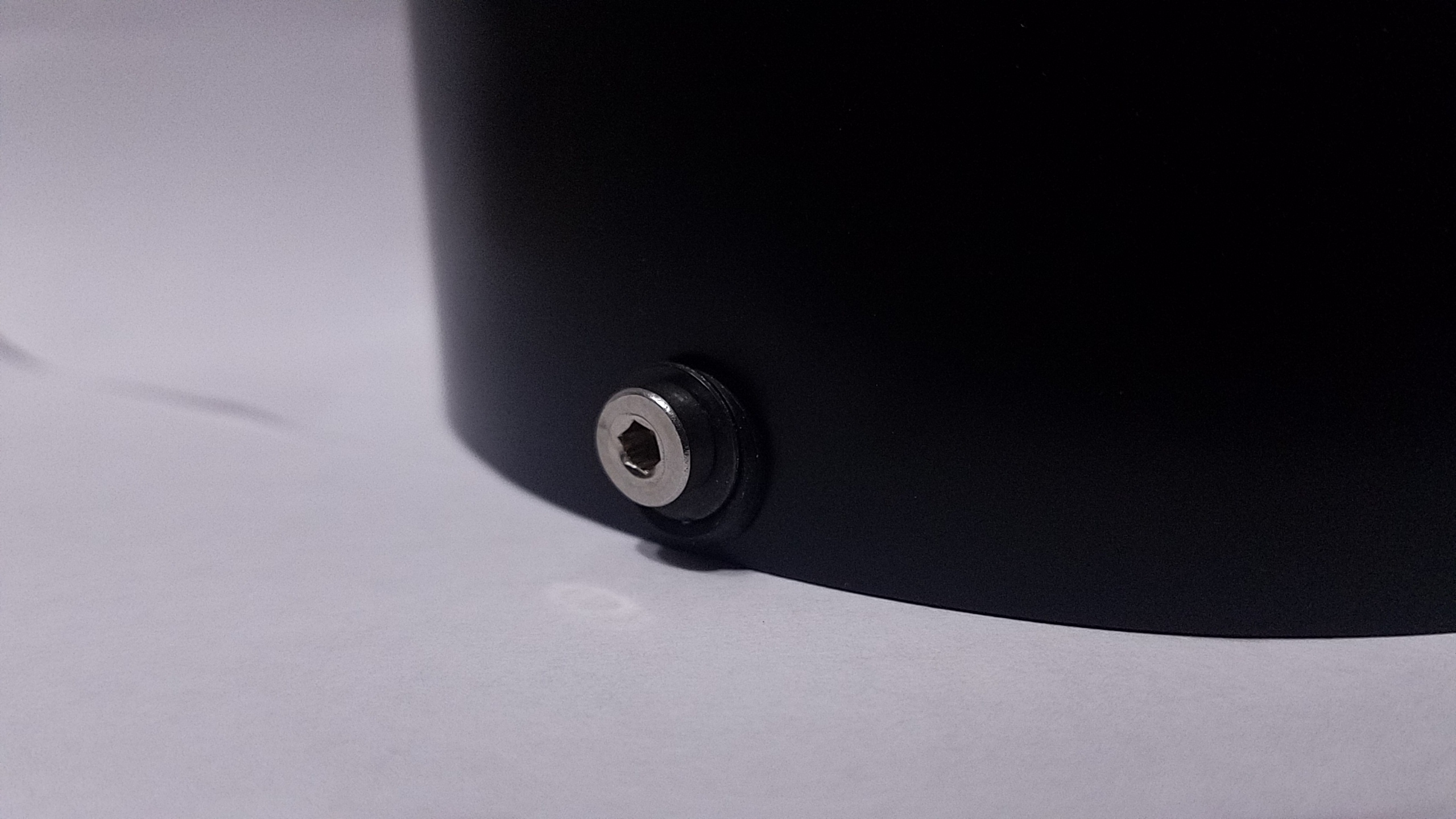

Thought so, just wanted to verify. Too smooth for powder coat, and I can see 'skid marks' in the visible countersunk hole. Normal for alum...
That's what happens when one has had his nose rubbed into materials a lot....you notice the 'fiddly bits' of minimal consequence. *L*
Unless the bit is 'newish' and is precisely the right speed, the alum 'smears' like butter right from the fridge. I've dealt with people that have noticed such. Wanted to slap them. Thousandths of an inch, doesn't effect fit, and they see That. You pick up on the anality of it, and people stop inviting you to parties. Industrial disease.... 😉

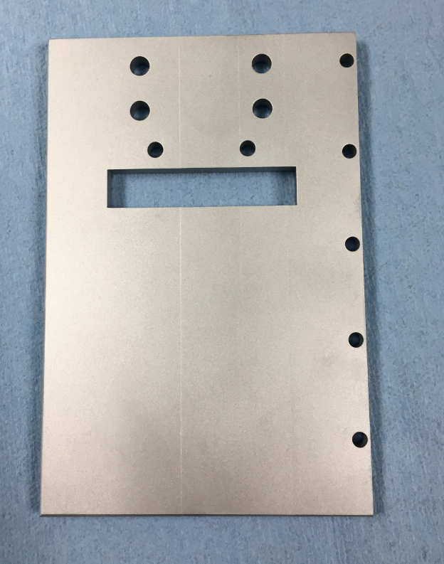

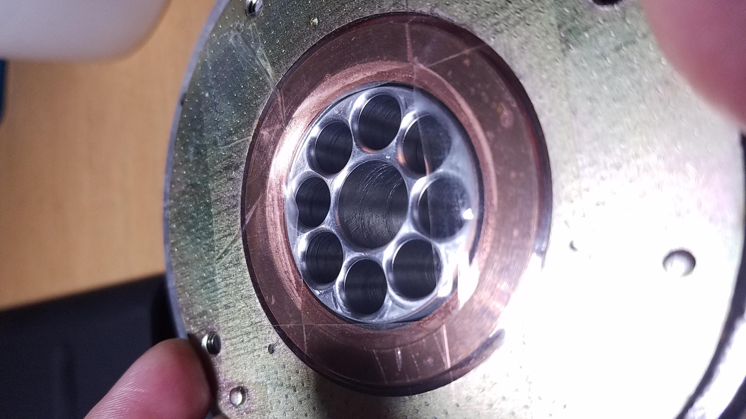

Inner Diffuser
More metal magic. This is the inner diffuser. finished metal components are in the works.
Beautiful....*L*...but it starts to look like a sonic revolver, 'bout 22 caliber...
"Stand back...these speakers are killa. See those holes in the floor?" 😉

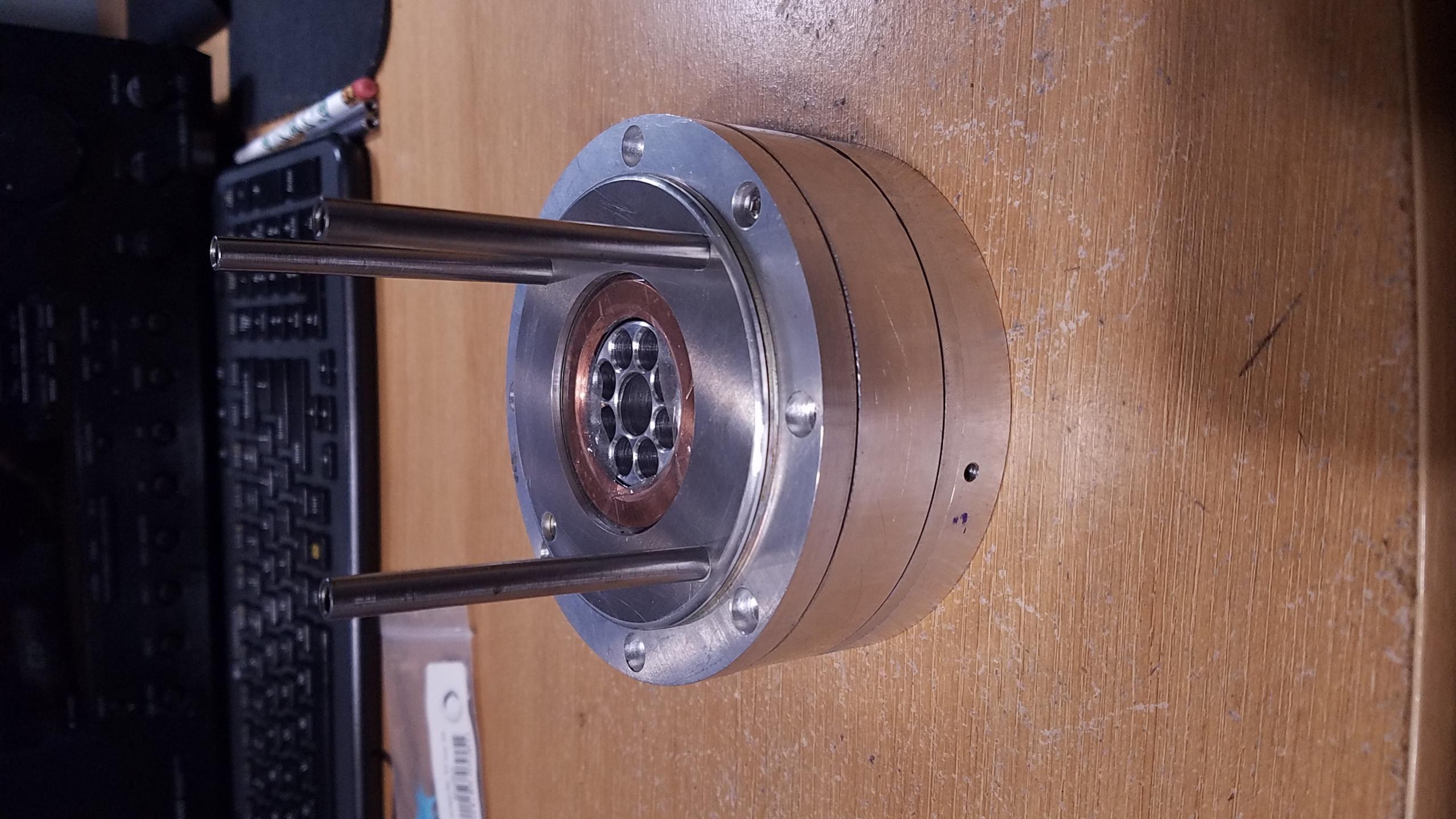

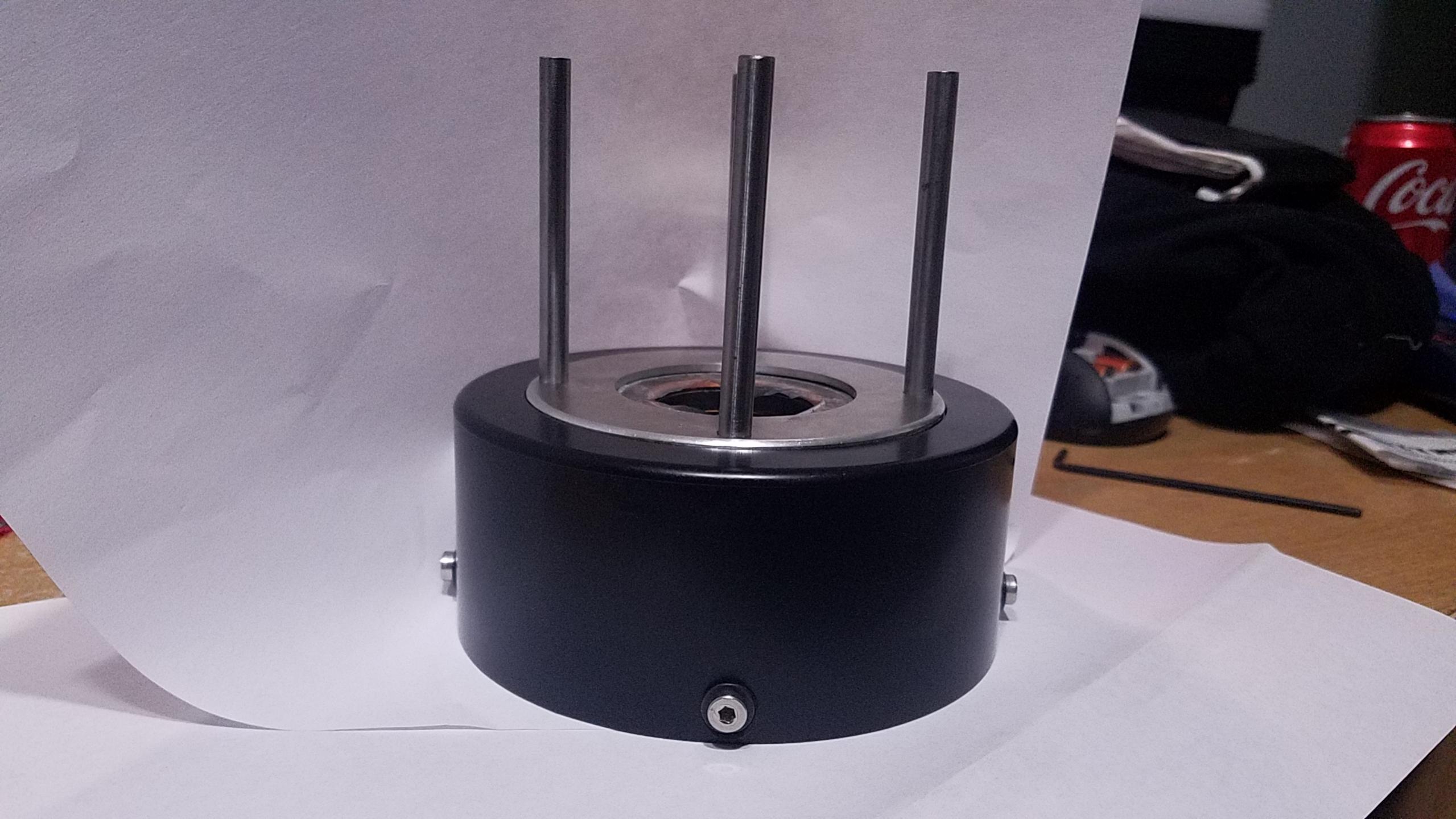

Complete Metal Fab
Here I have the completed metal structure for the mid-range. here you can see there is a lot of metal and the bottom fits flush accurate so far.

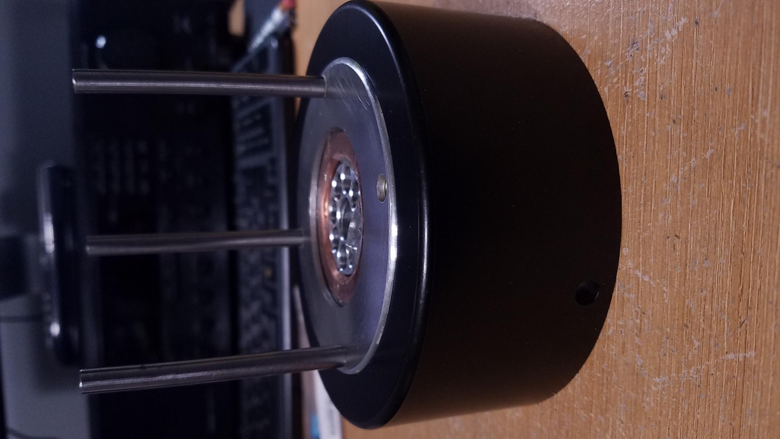

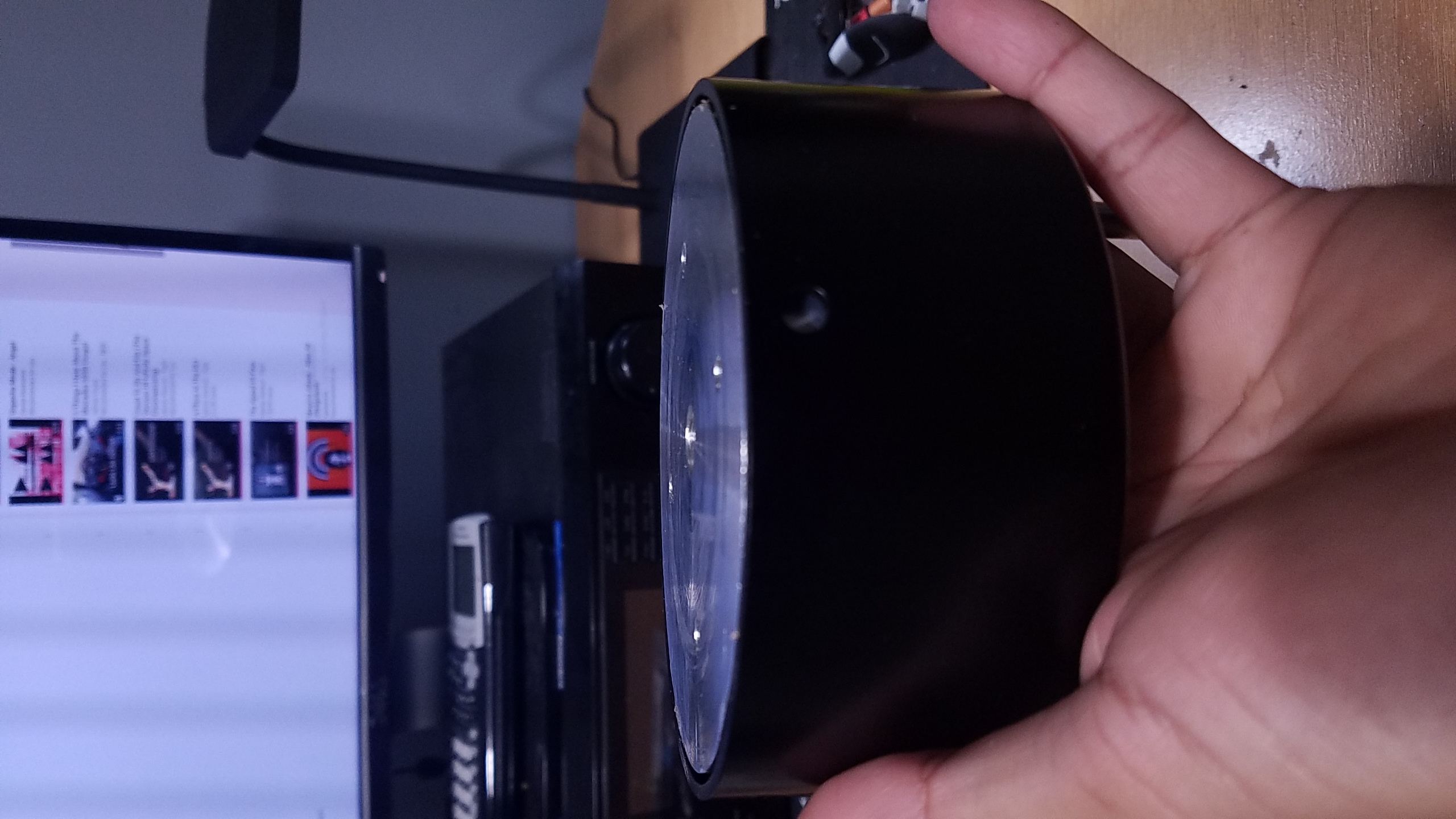

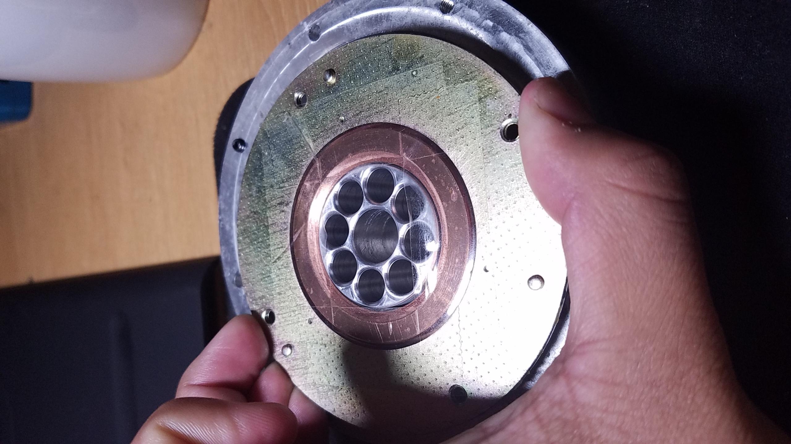

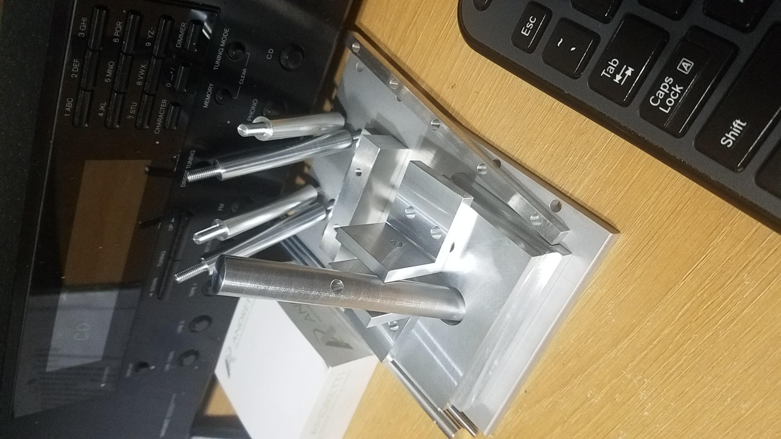

very small update
All i did was bore out the existing threads in the motor so that the threads to the chassis didnt cause the motor to rise and not make flush contact. Also the bottom piece where the metal casing bolts are attached to where not properly done which did not allow me to use my existing screws I found some that worked just as well and now we know what it looks like assembled at last the biggest thing left is making a high quality lamella process and molds

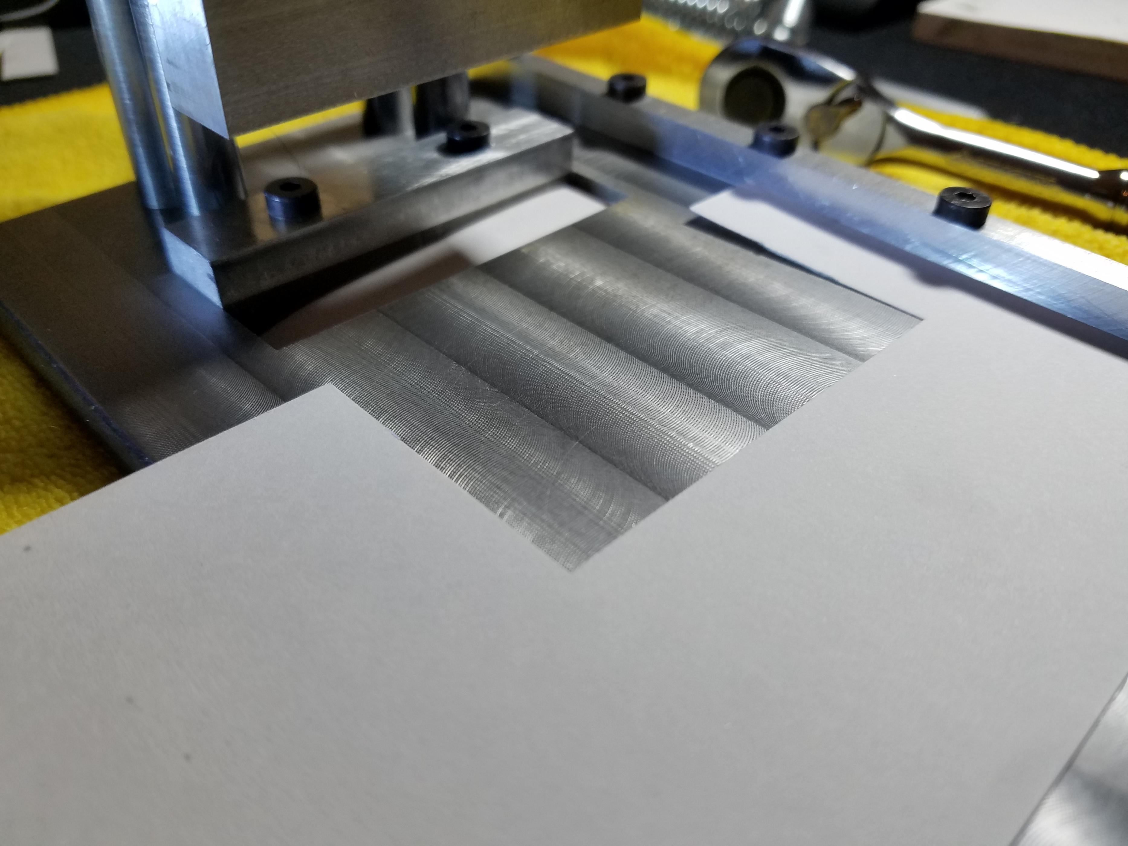

I've had the bases for my project CNC'd to make the end result a tad less 'garage DIY'. I've spent a lot of time considering a better approach to forming cones, as 'hand forming' yields variations that I'm trying to avoid. A small slip roller would be ideal, but they're not made small enough 'off the shelf'. So I'm working towards making one that's 'purpose built' for the goal...

I've been struggling with that simple yet effective means of rolling materials for cones in a predictable fashion. I finally arrived at an approach that has those answers; more on that as I cobble together 'the widget'. 😉

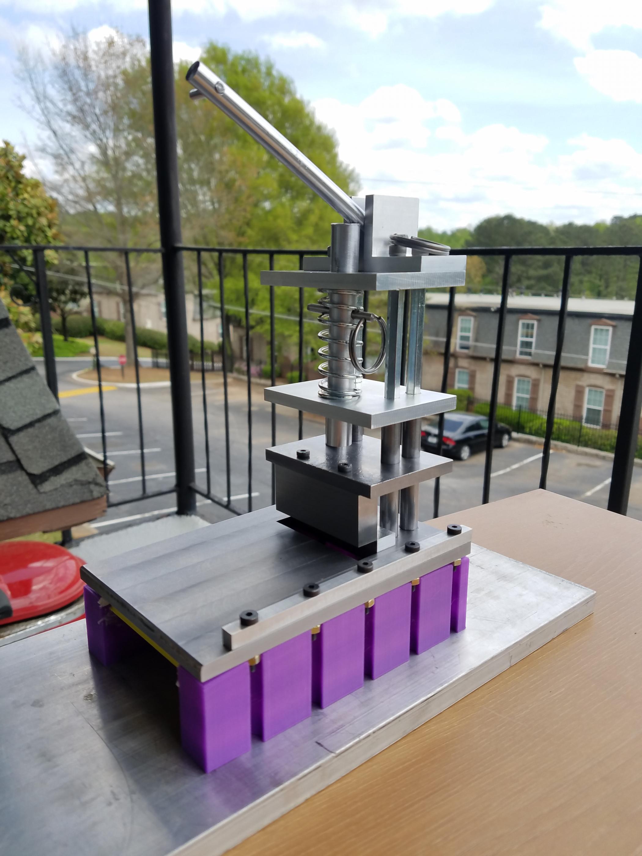

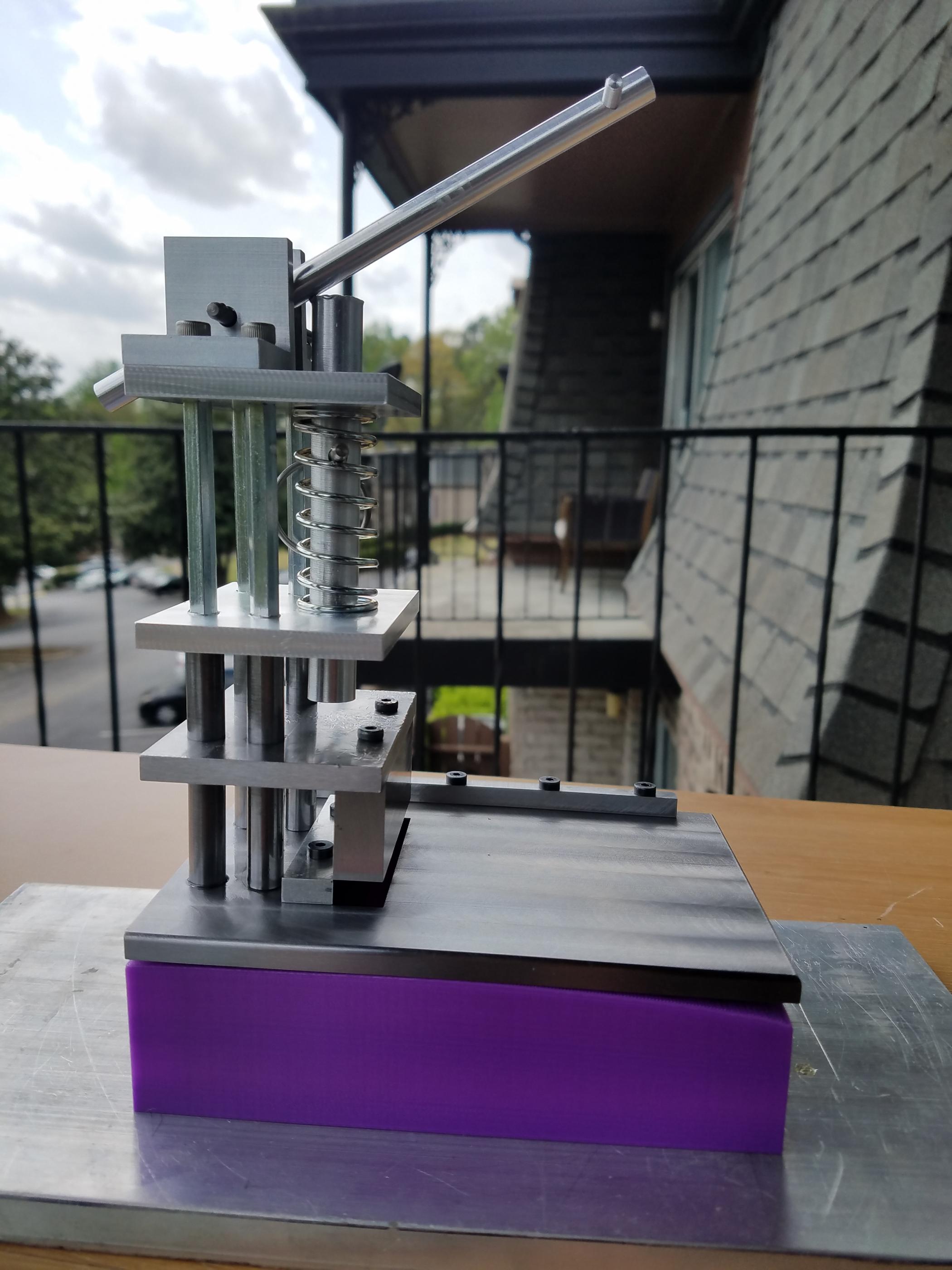

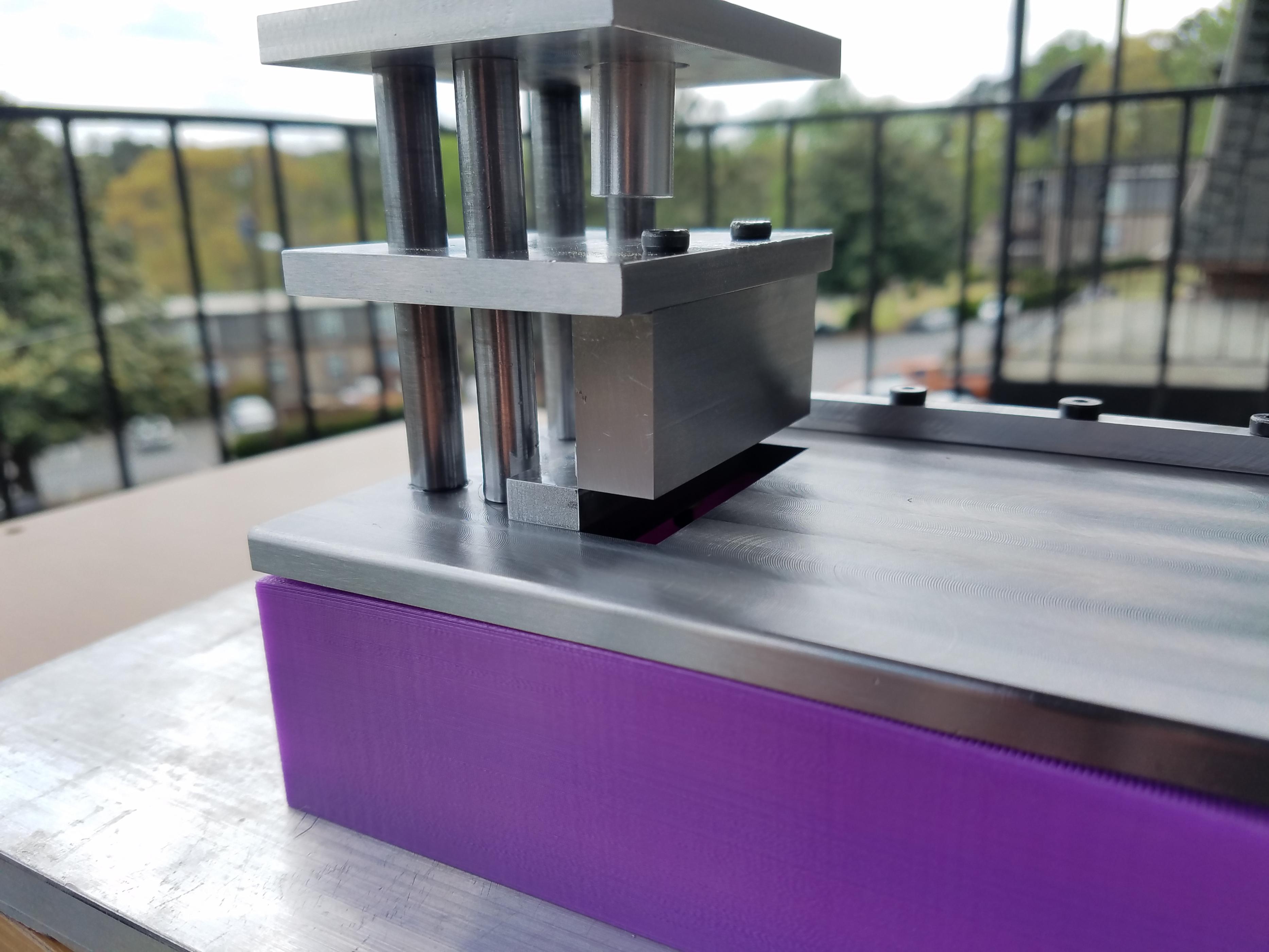

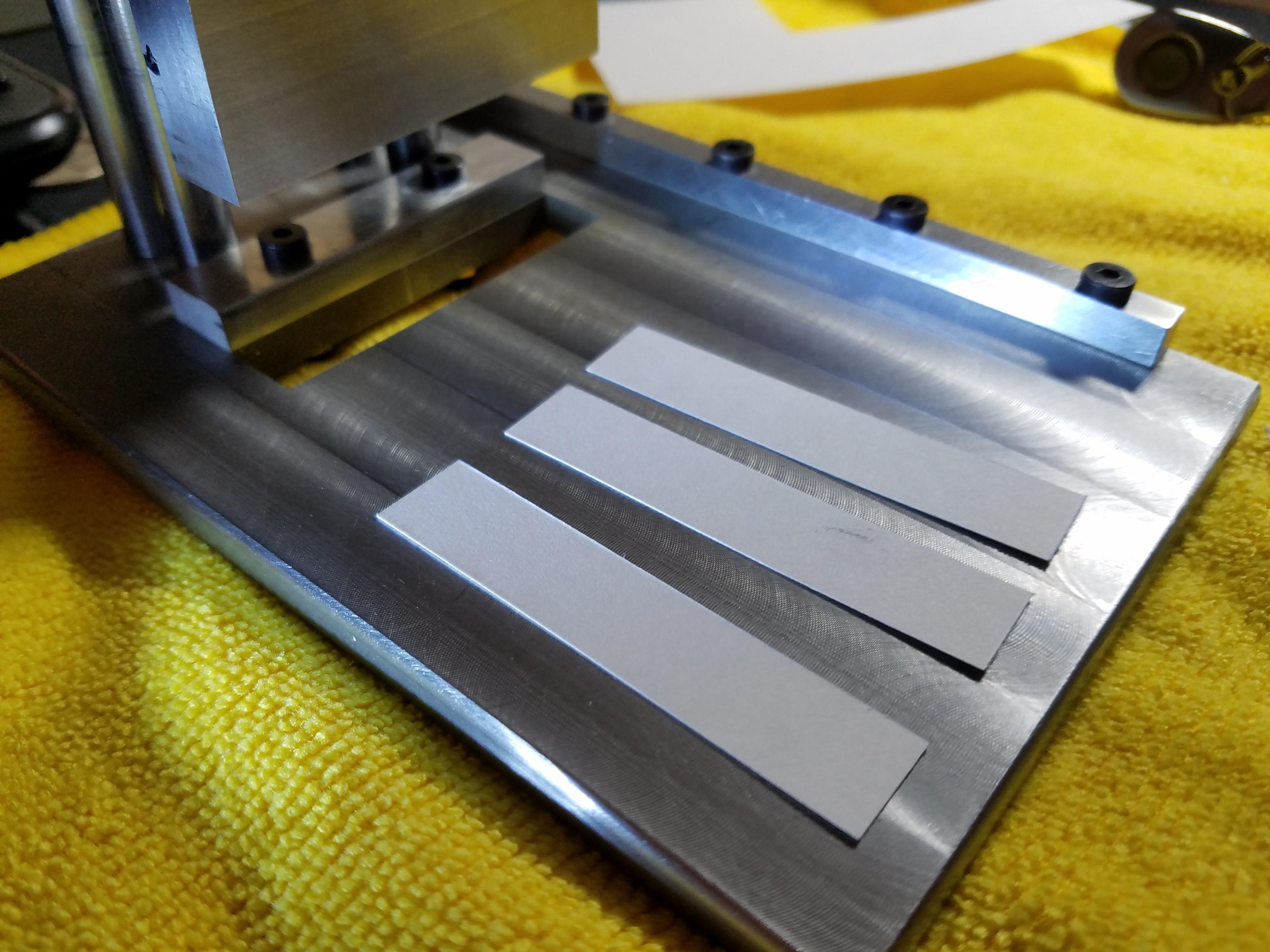

My very own Cutting machine
Stil needs some adjustment this thing should usher in a new era for me 🙂
