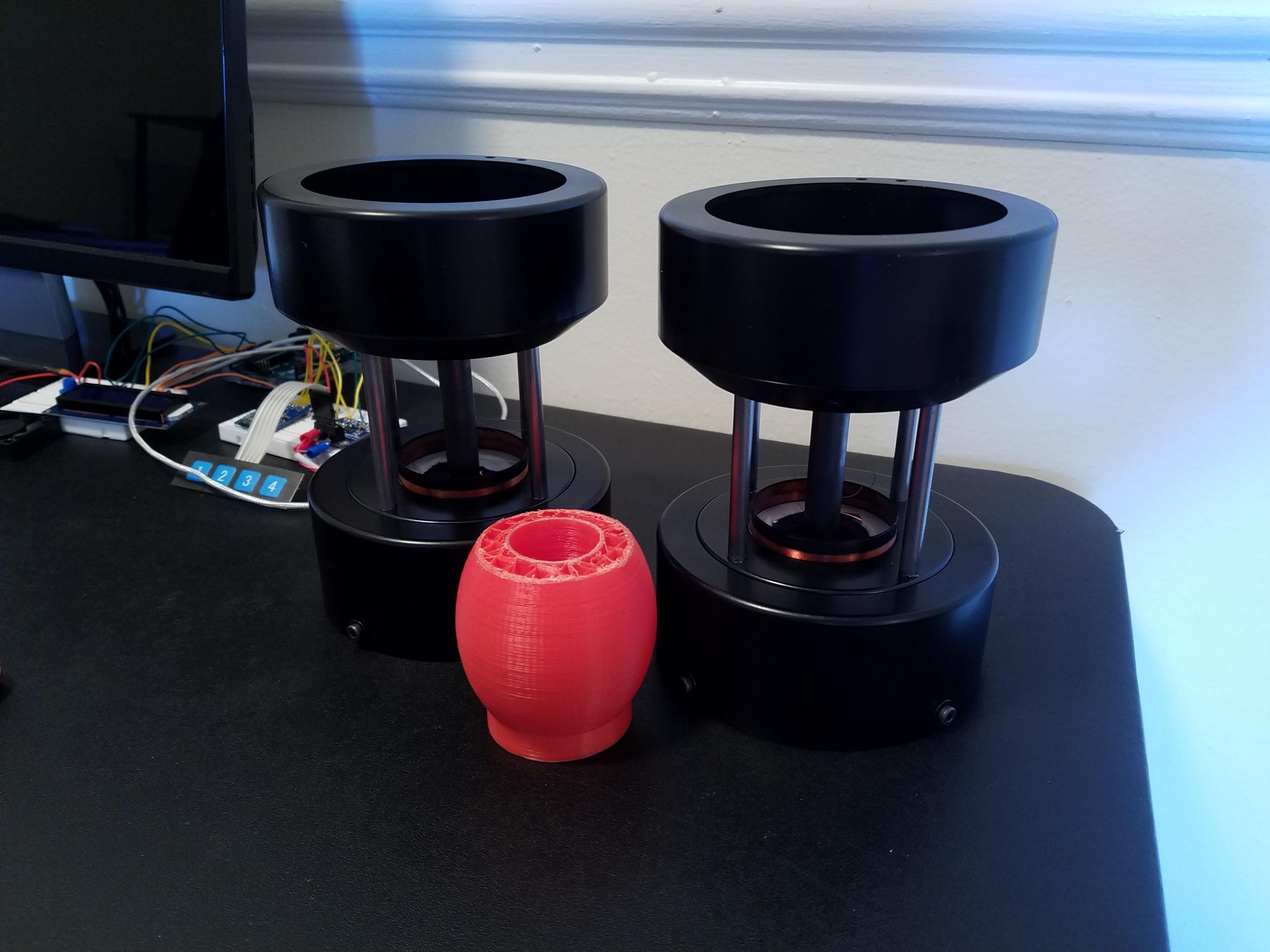

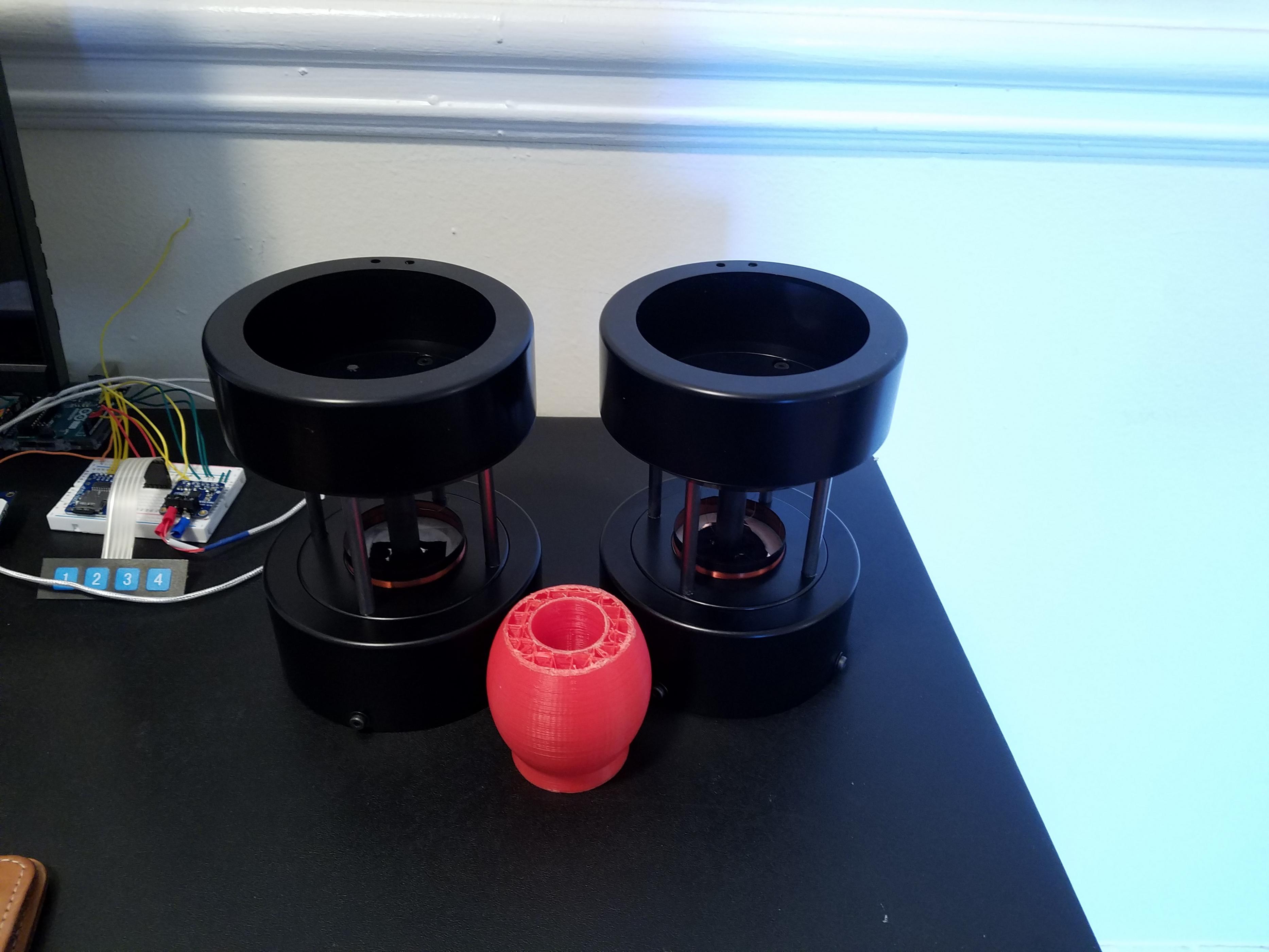

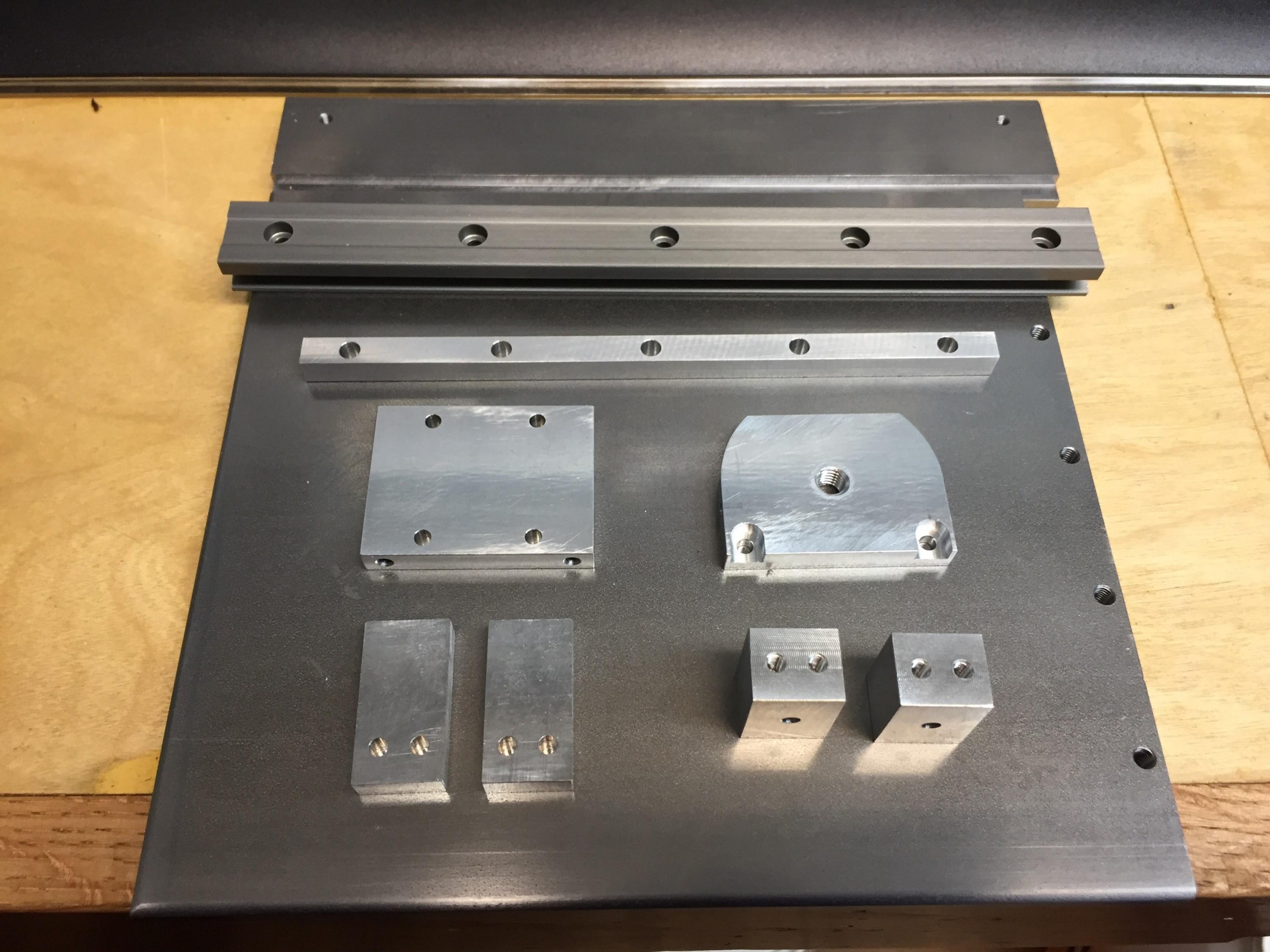

The current plan is to commercialize the completed drivers and full-sized monitors. I do not think I would sell anything smaller than a completed driver.

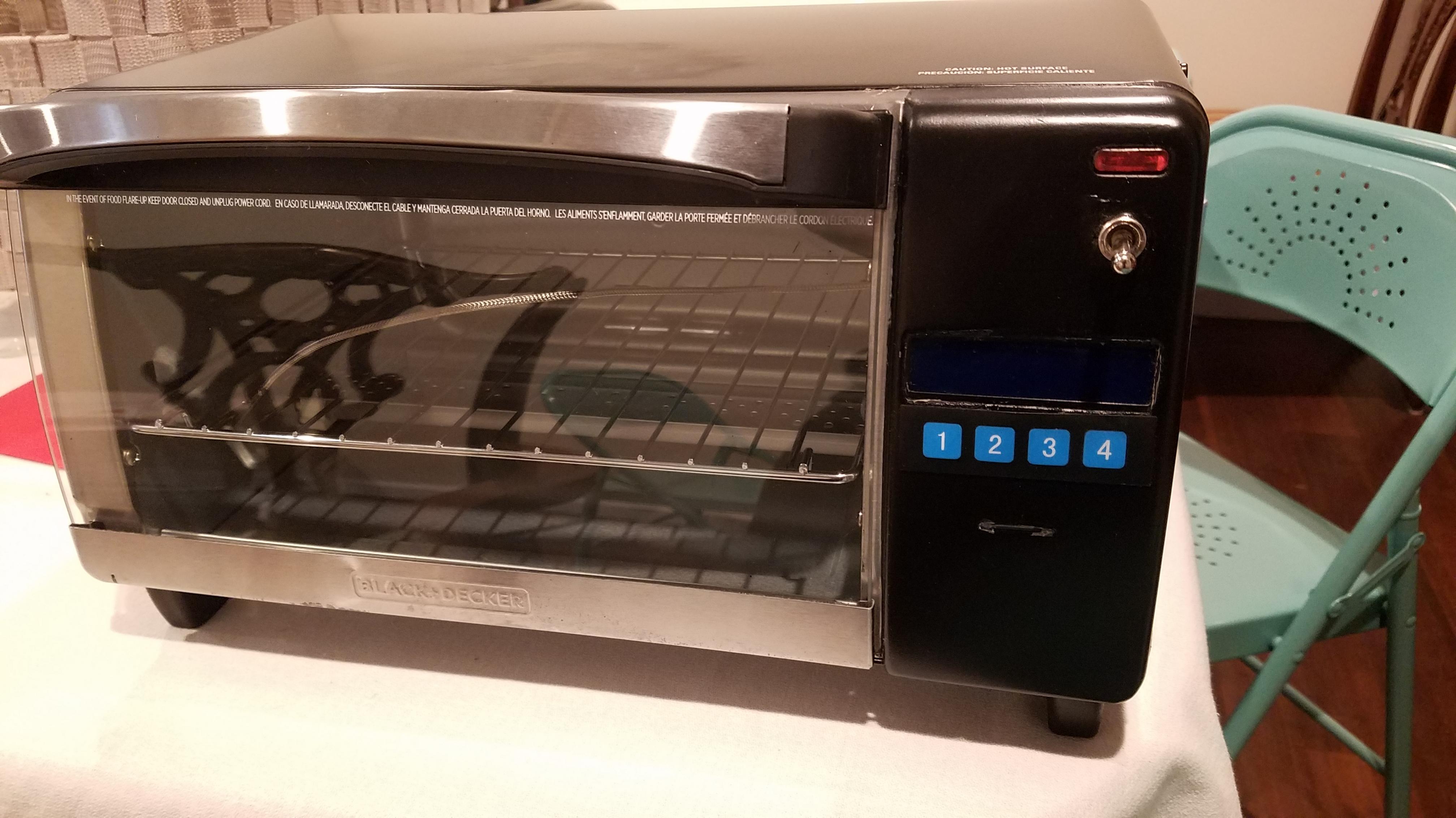

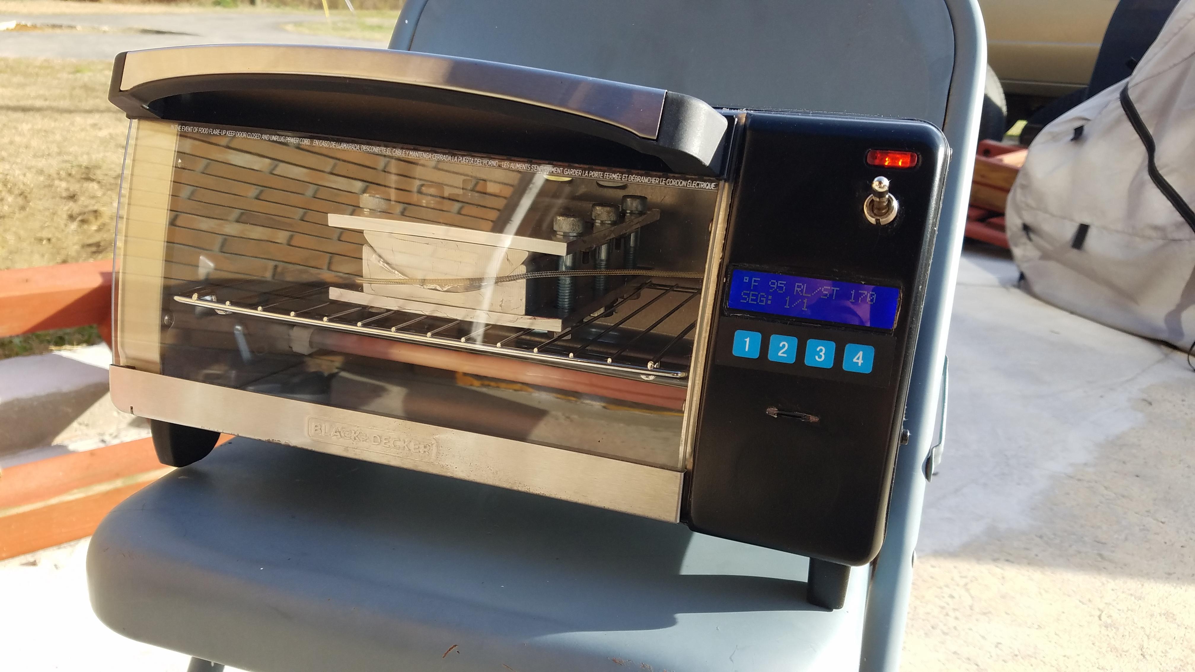

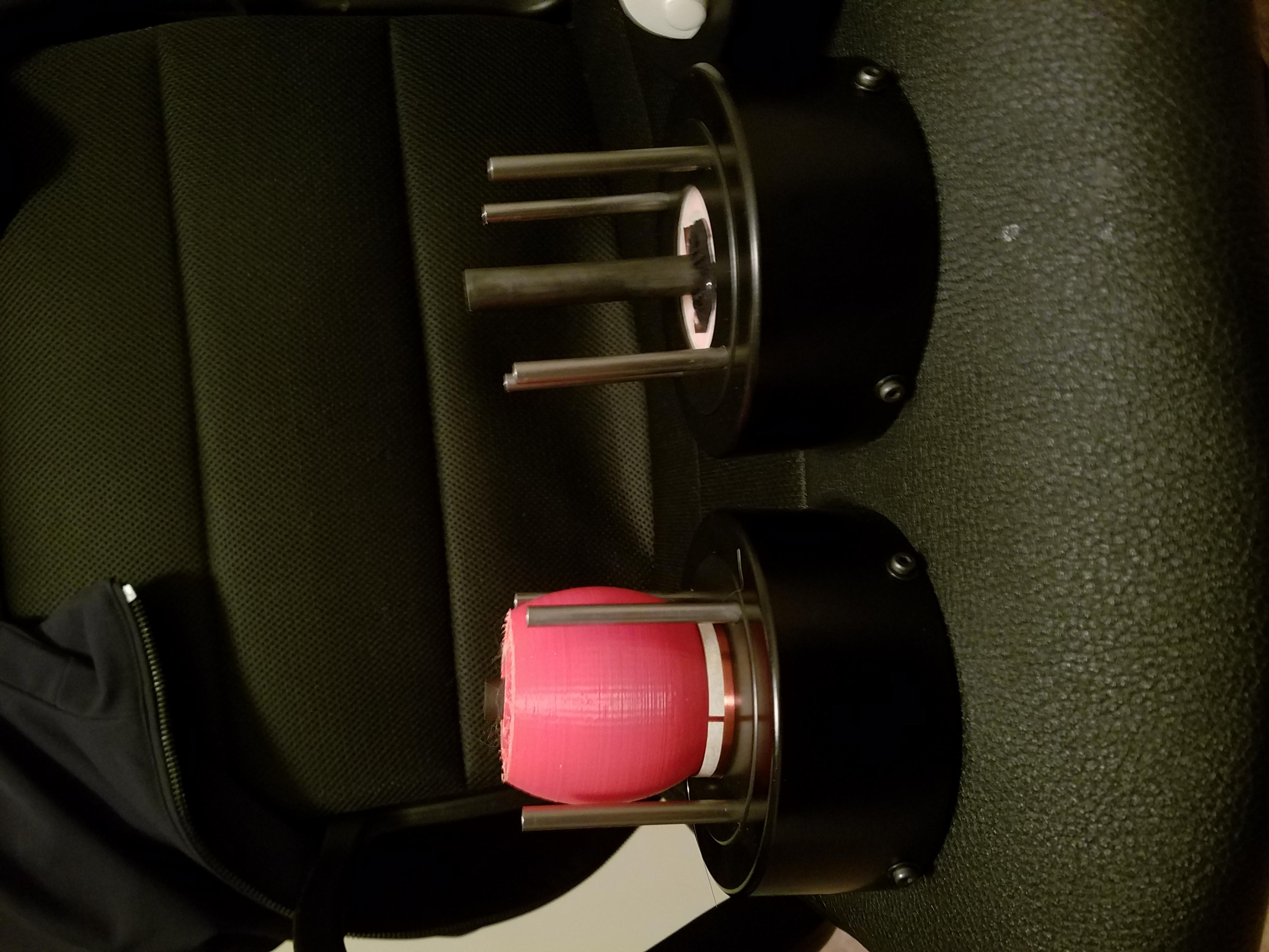

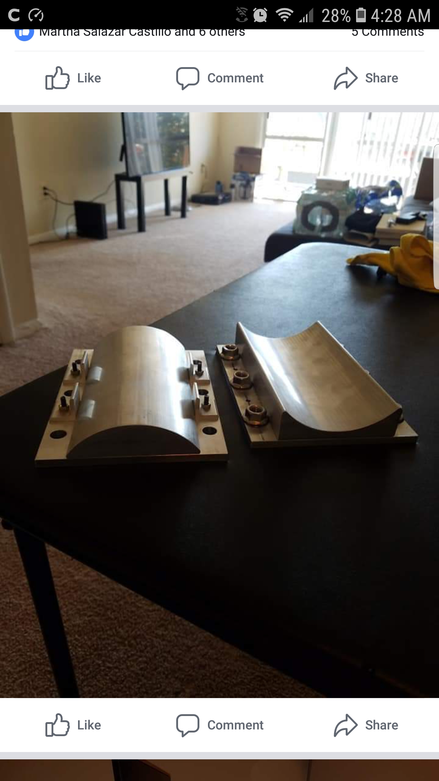

Thanks I will post regular updates and this forum will be among the first to know when the monitors or drivers are ready. Here we see the completed motor assemblies and housing. To the left is a oven controller I am working on for the carbon fiber petals. I have included a picture of the mould. No holds barred

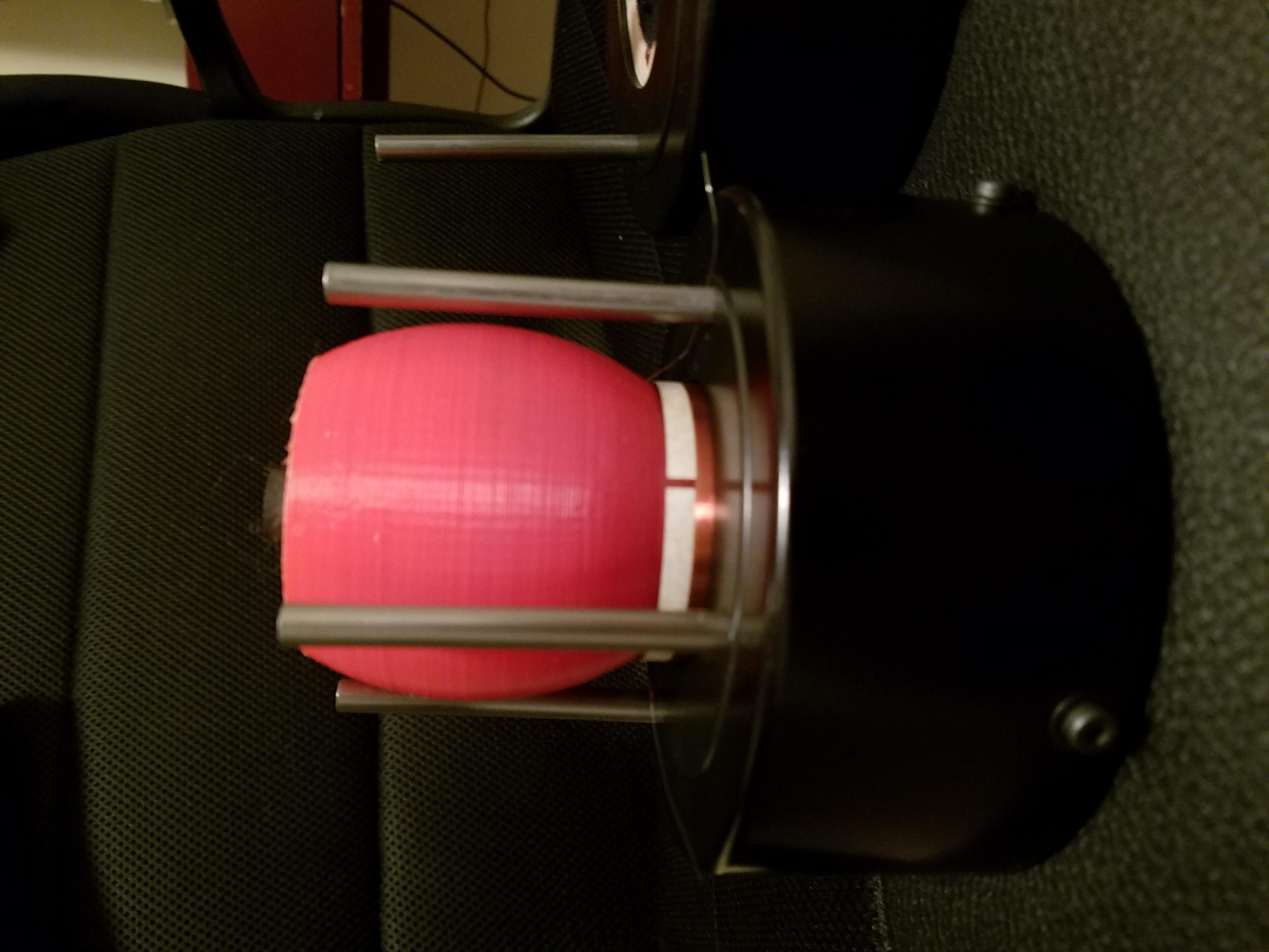

The question I have, after watching the many videos on the MBL's and looking through this and many other threads is... is the "melon" truly sealed? The spider is like all spiders, mesh (holey), and the VC gap would technically leak the air from the inside of the melon through the gap and out the spider. Minimal air to be certain, would ferrofluid be required to truly seal the VC gap, or some membrane that goes from the VC to the rod running up the center? Superior work by everyone in this thread, really blown away by the attention to detail and great execution!

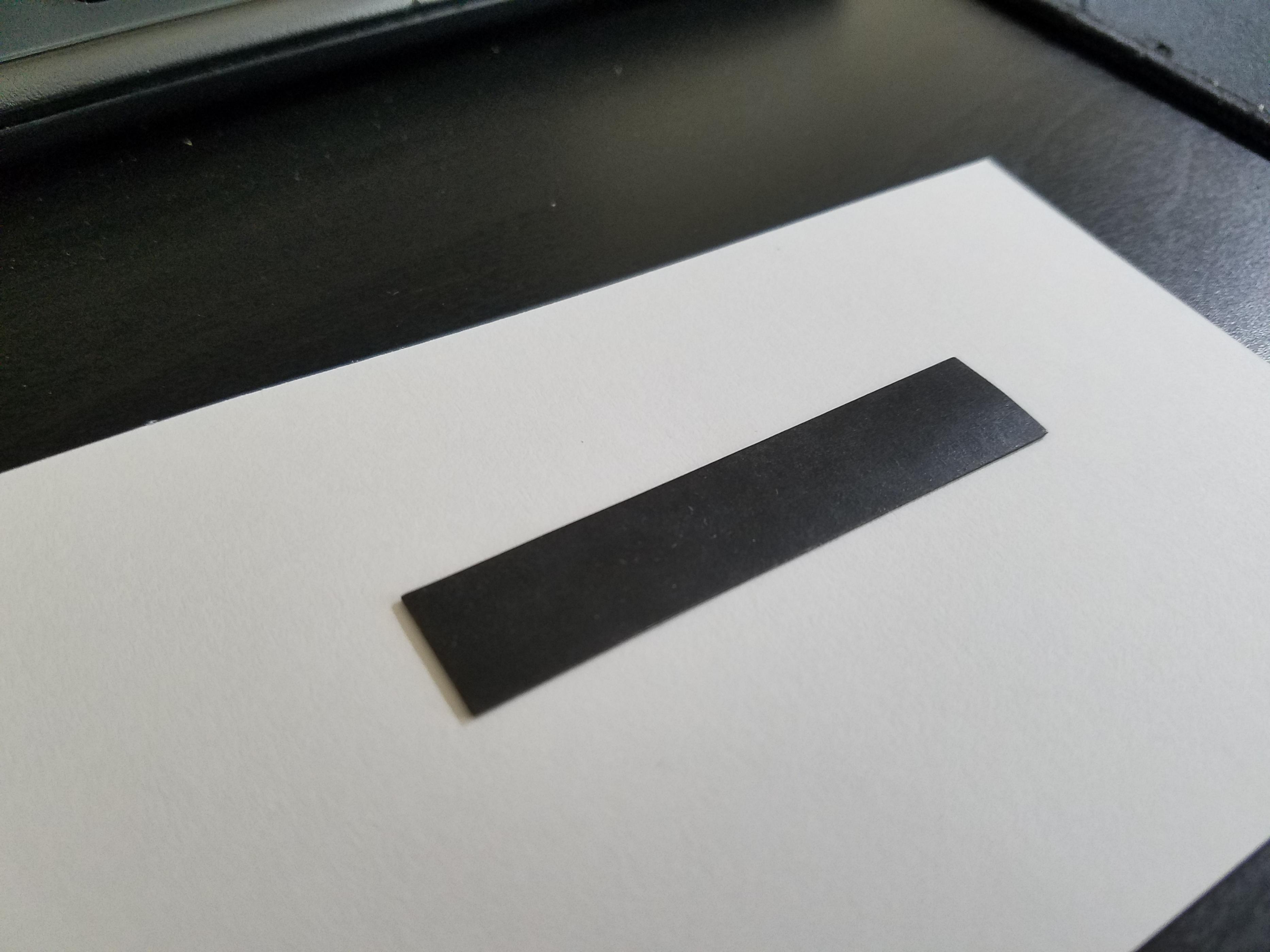

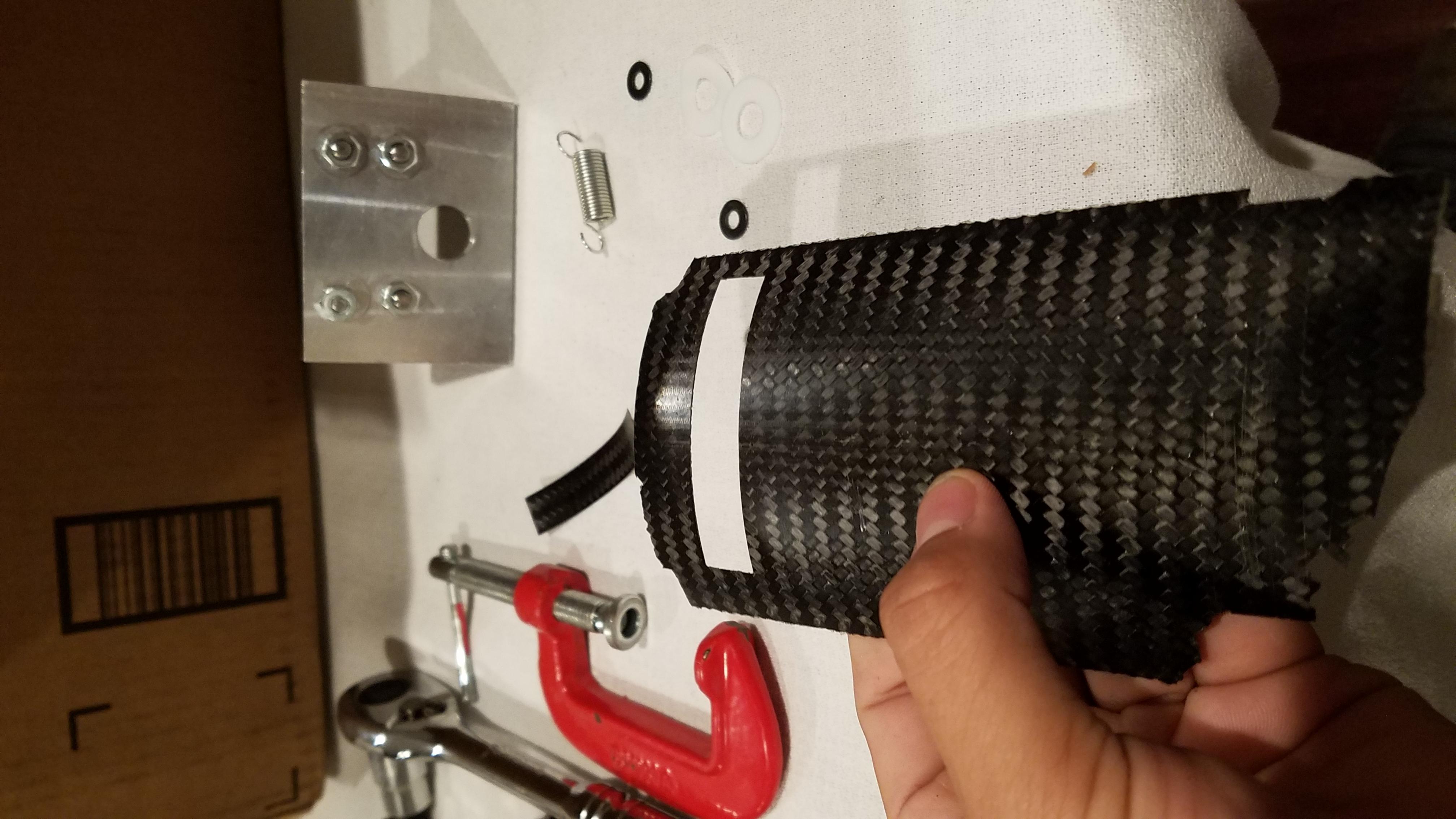

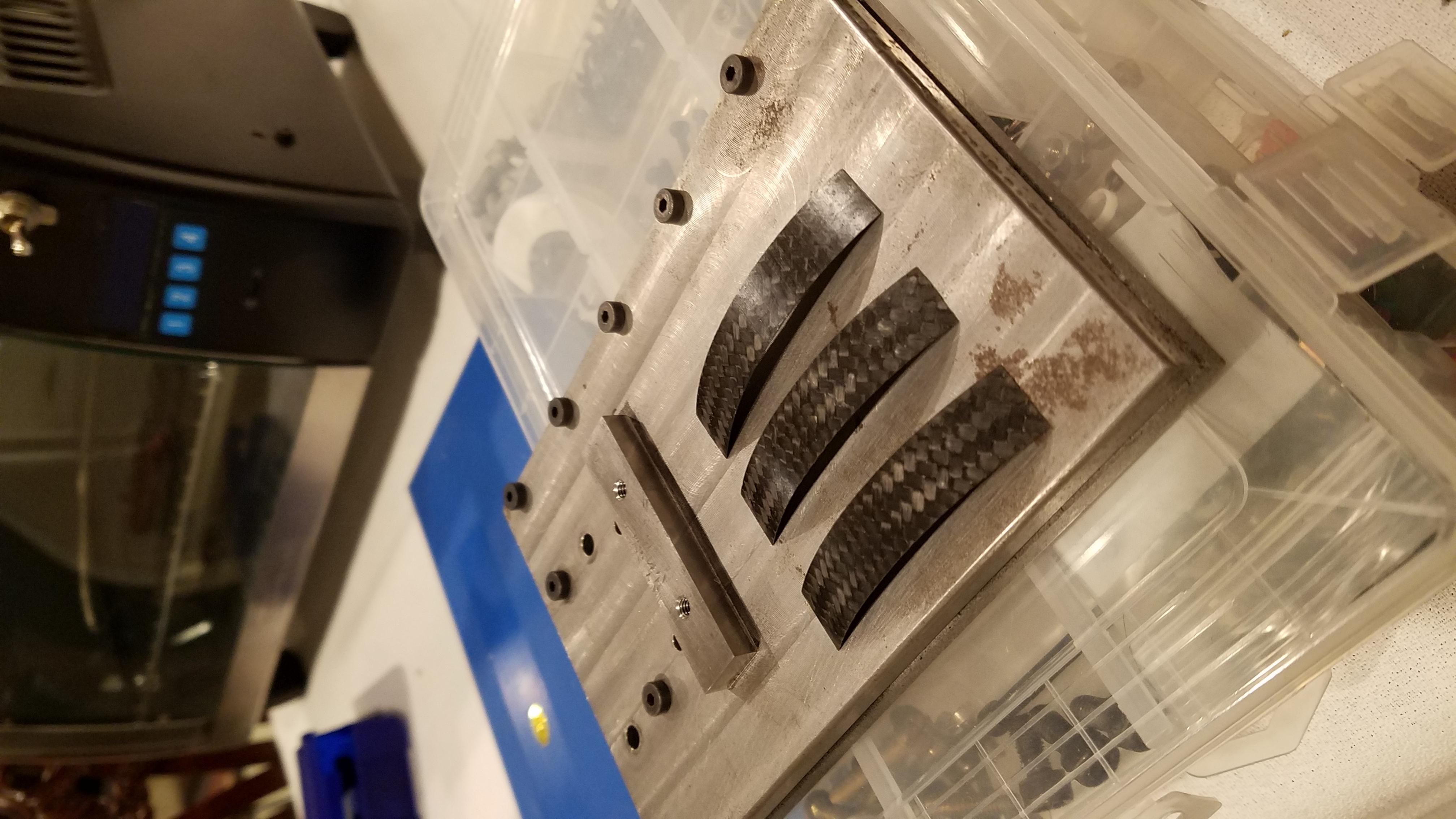

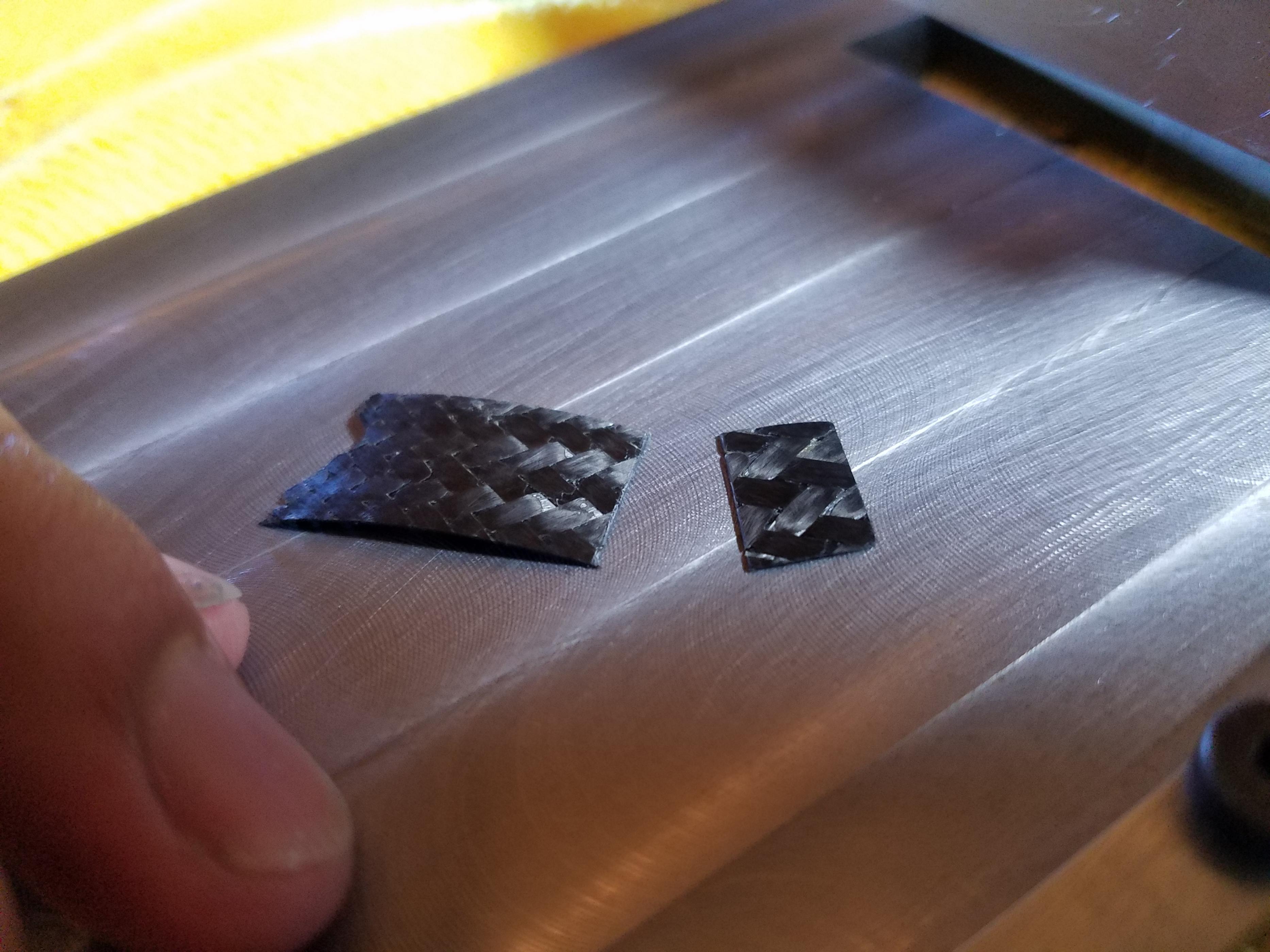

Punch press results changing out the ram for an arbor press.. much easier than the small punch press I made. The first picture is the result of the oven and mold system.
