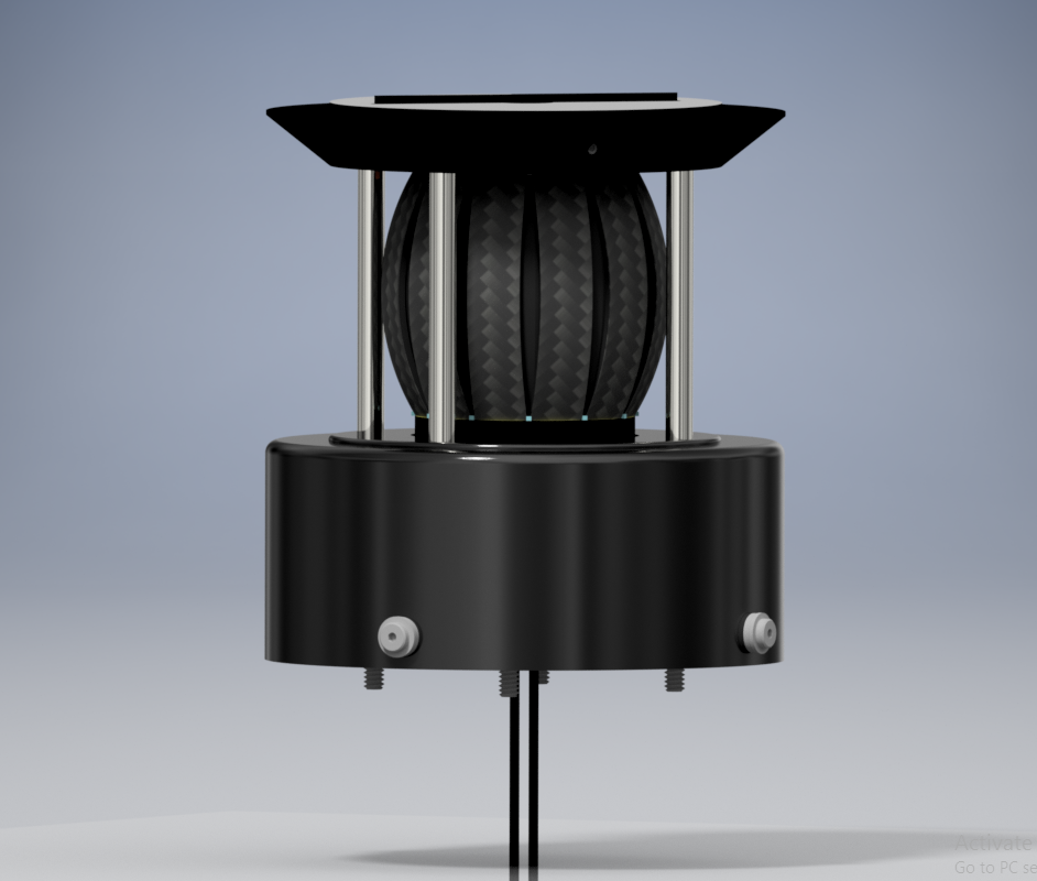

Wow...great drawing of what I assume is the bass driver.....
That would be the tweeter or maybe the upper midrange me thinks.
I believe David's already done the midrange, and the tweeter was in progress a few pages back. The scale of it suggests the woofer, but since I've never been lucky enuf to see an MBL IRL, I'm just uneducated guessing...

I have heard the MBL Radialstrahler several times and wasn't tremendously impressed, I bet Magnasanti's diy efforts probably sound significantly better, and don't underestimate your Walsh if well executed.
Like Kevin said I wouldn't underestimate your clones as long as the execution is good and there is no audible distortion. The drawing is in fact for the mid-range showing the internals.

A mid-range, hmm... as was noted, the magnet structure is a bit unusual, but....it's an unusual speaker, so that kinda follows....*G*

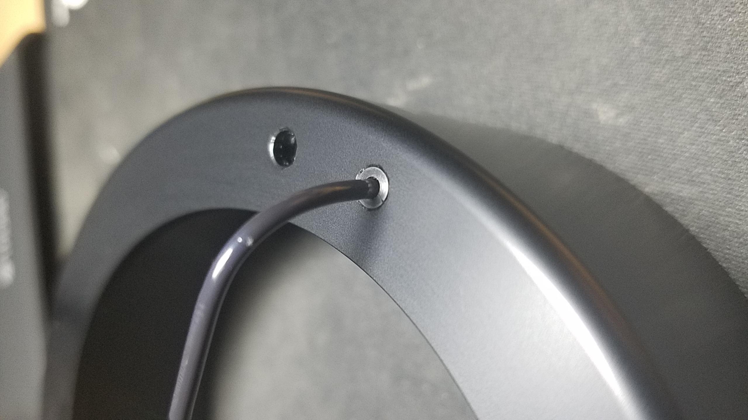

Small update

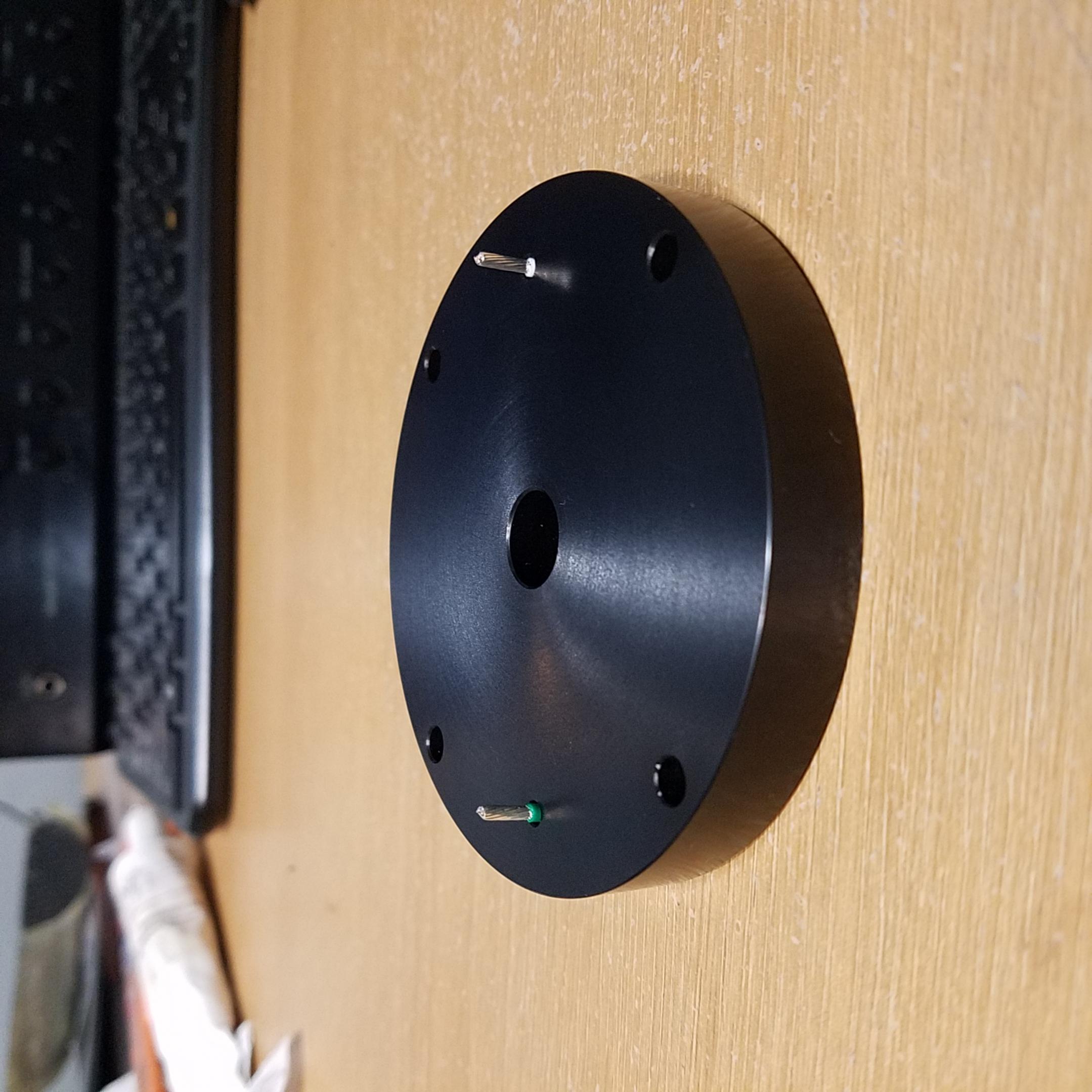

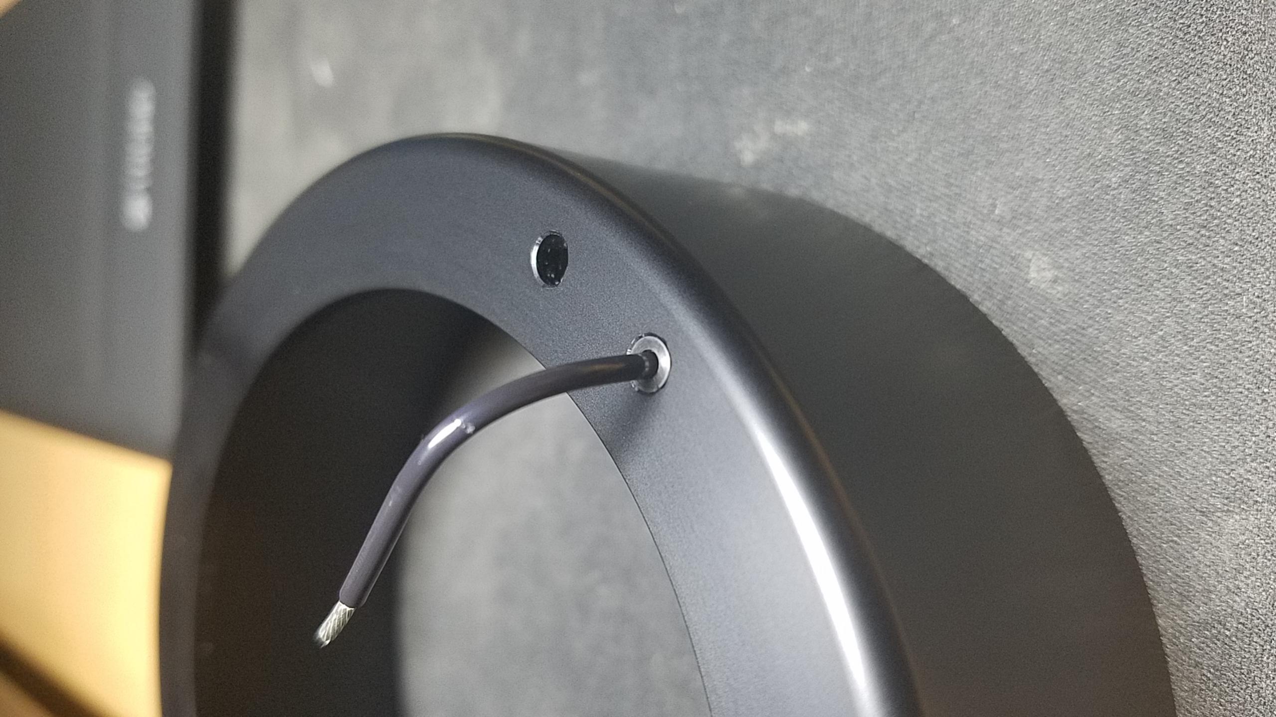

Finally gaining some ground. This little update includes installing rubber o-rings, finding the right connection wire, testing the new lamella alignment rig.

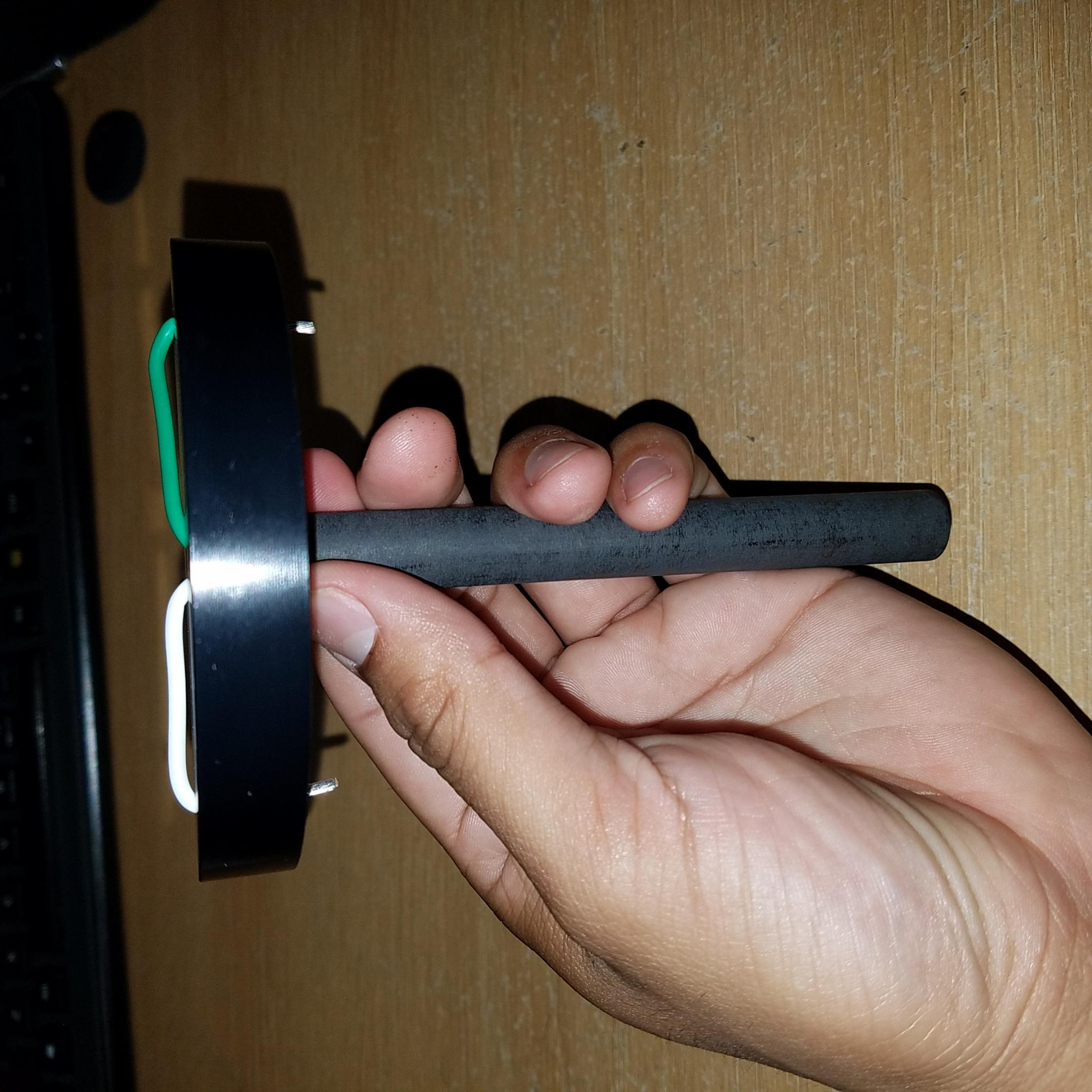

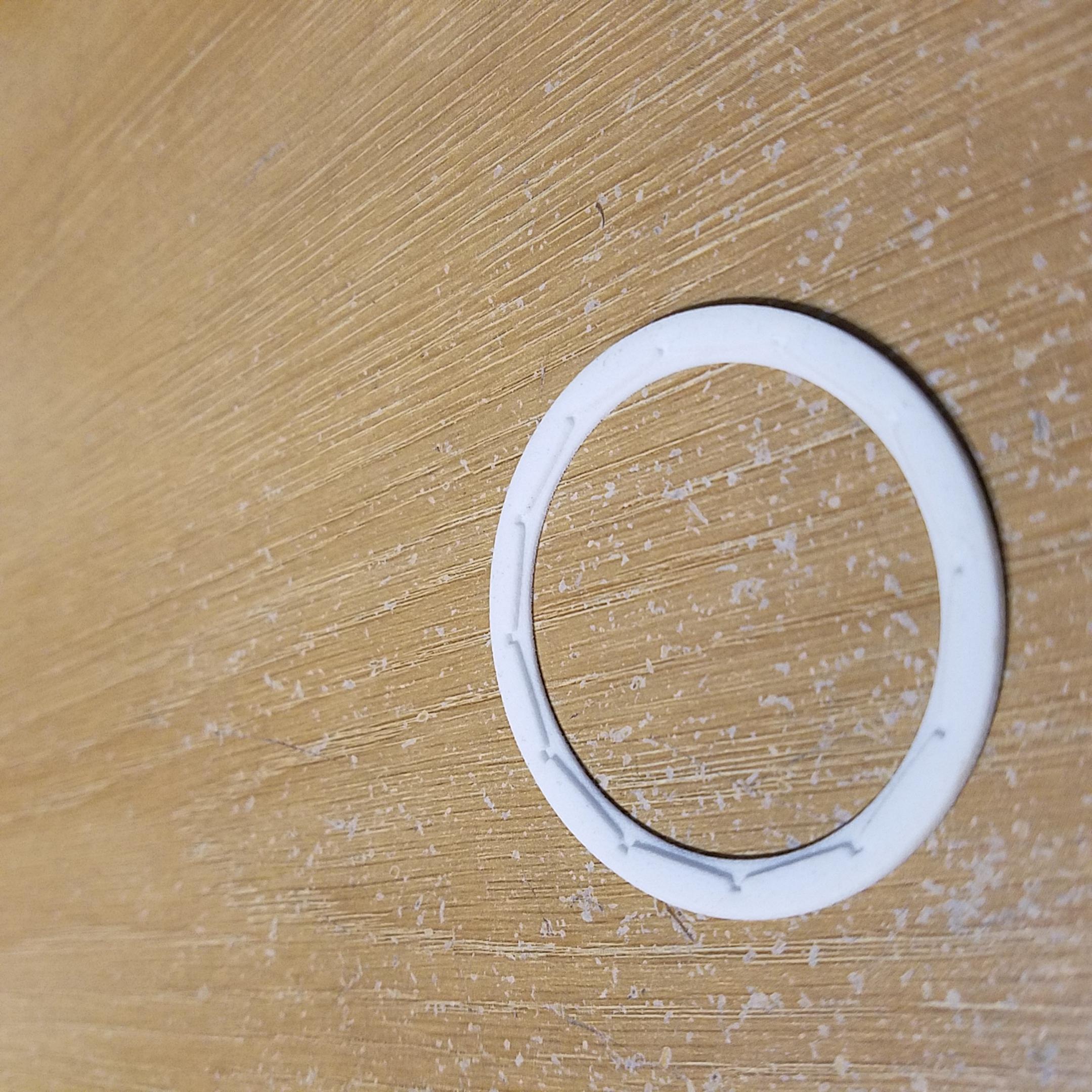

First the o-rings they fit quite nicely into the slots for the tweeter cable pass-through they are meant to inhibit vibrations. Here is a comparison of o-ring vs no o-ring. The third shot is how the cables will sit and attach to the tweeter. As you can see the cables will be soldered in place connected to a copper post.

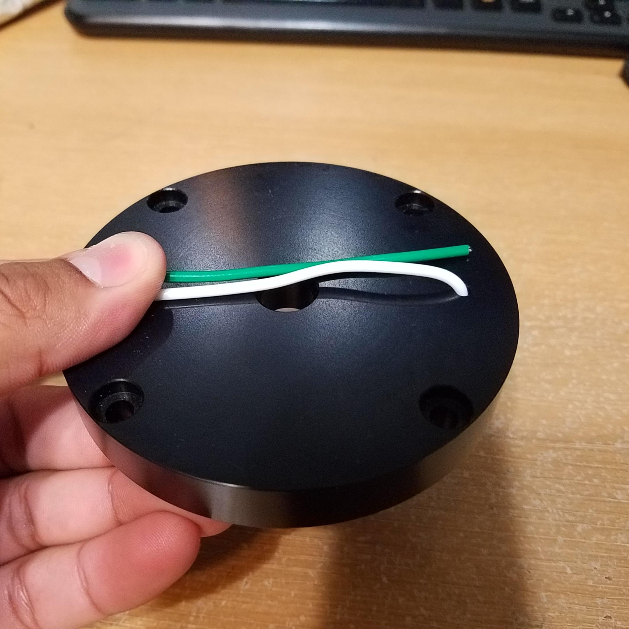

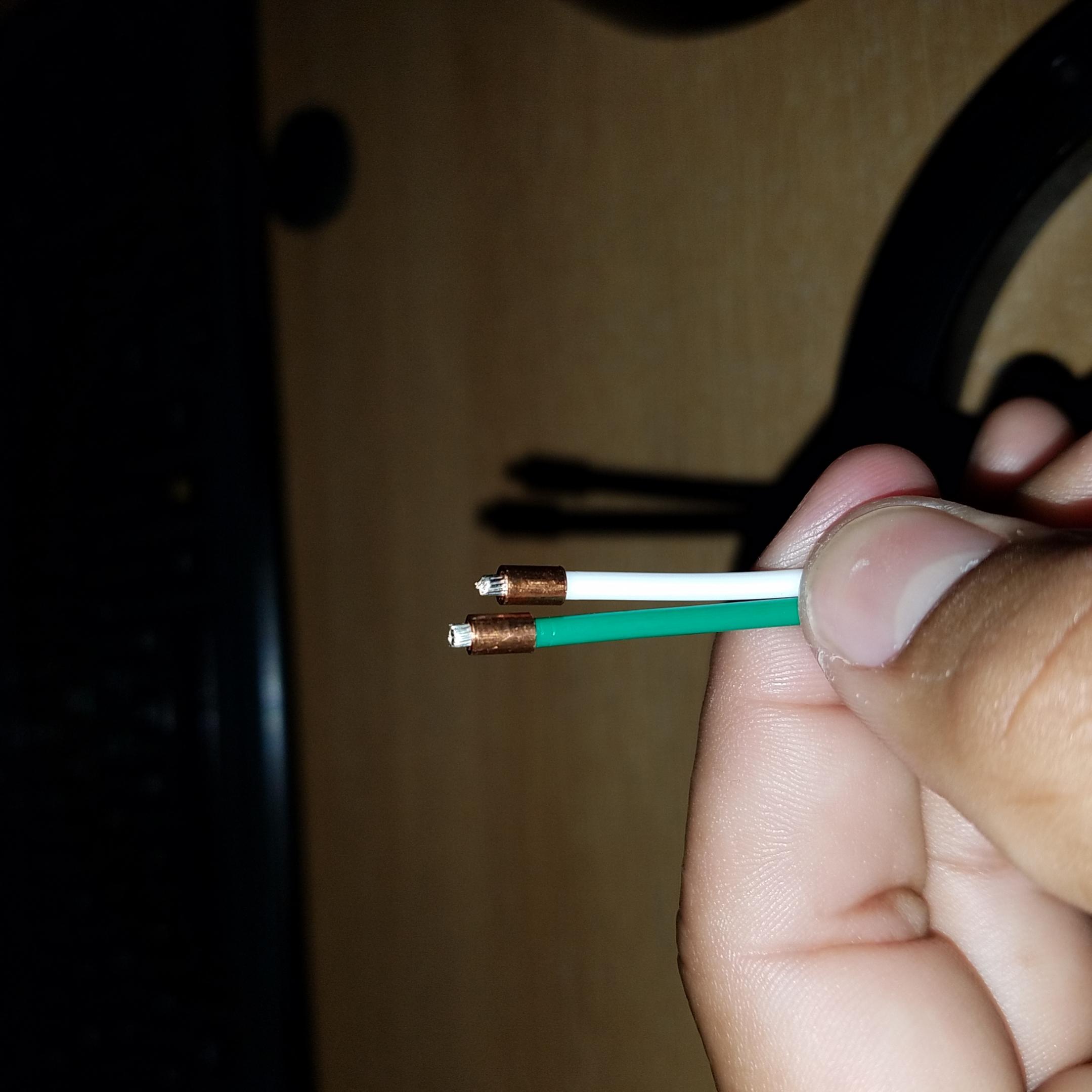

Update
The second of the small updates is finding the right quality cable. This one is from a brand called Alpha it is a silver coated copper wire with Teflon insulation. The cable passes all the test. Here you can see how the cable will fit when it comes to the mid-range. The mid-range voice coil wire will be soldered directly to the protruded wire.

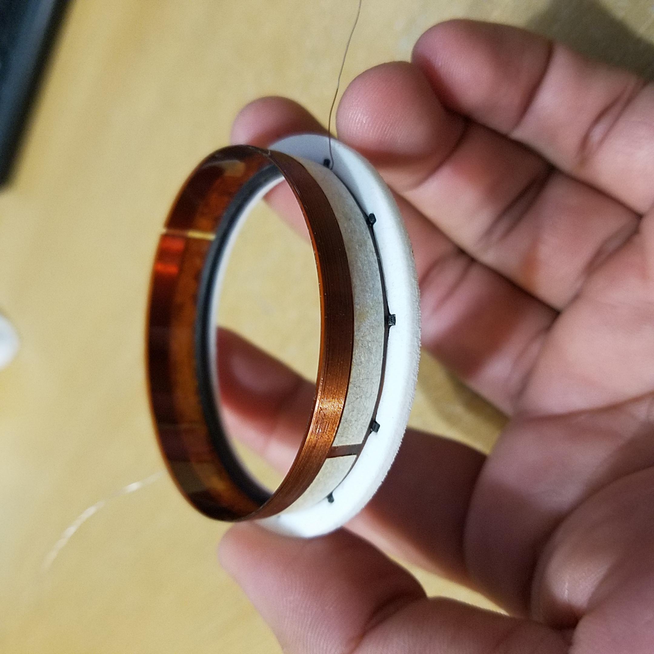

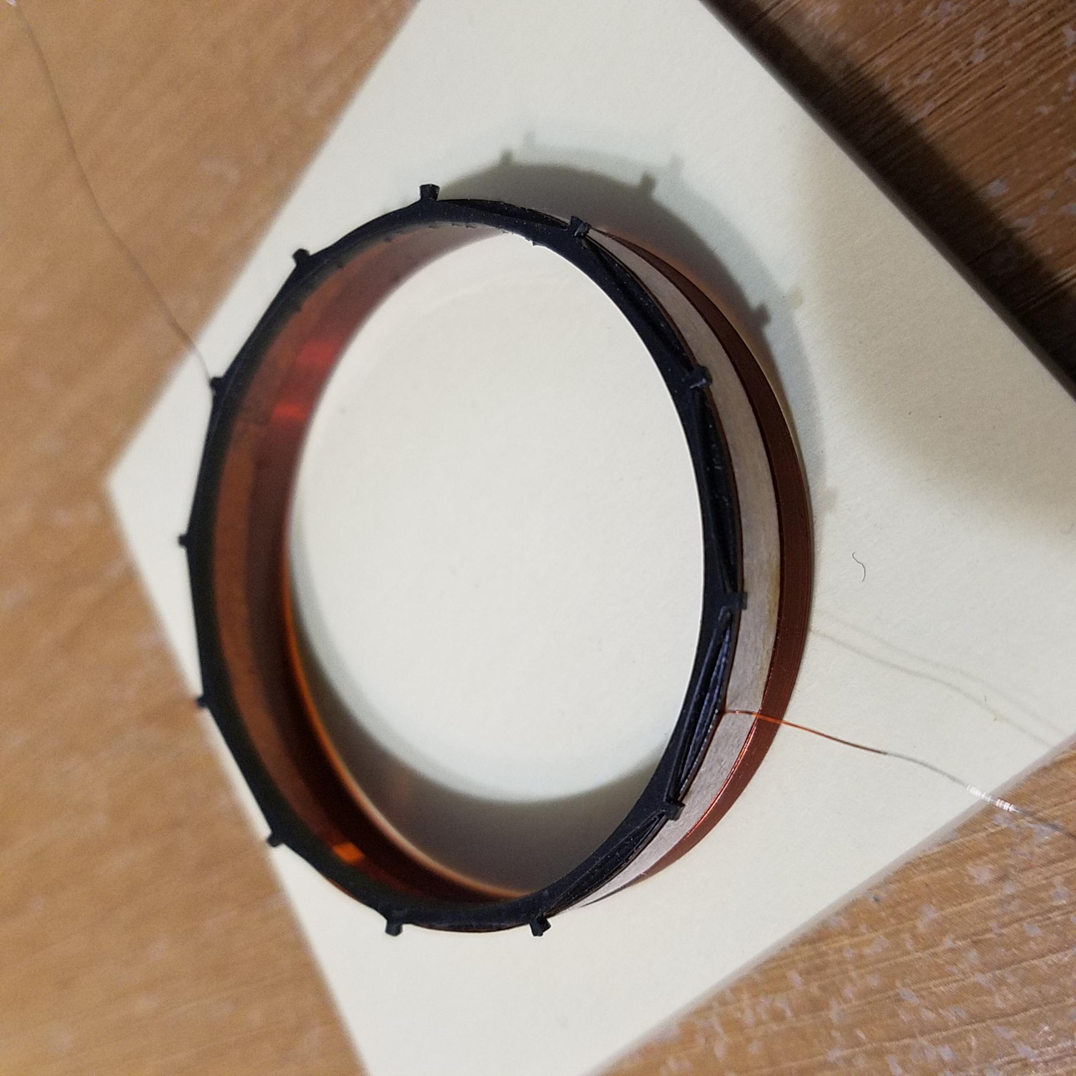

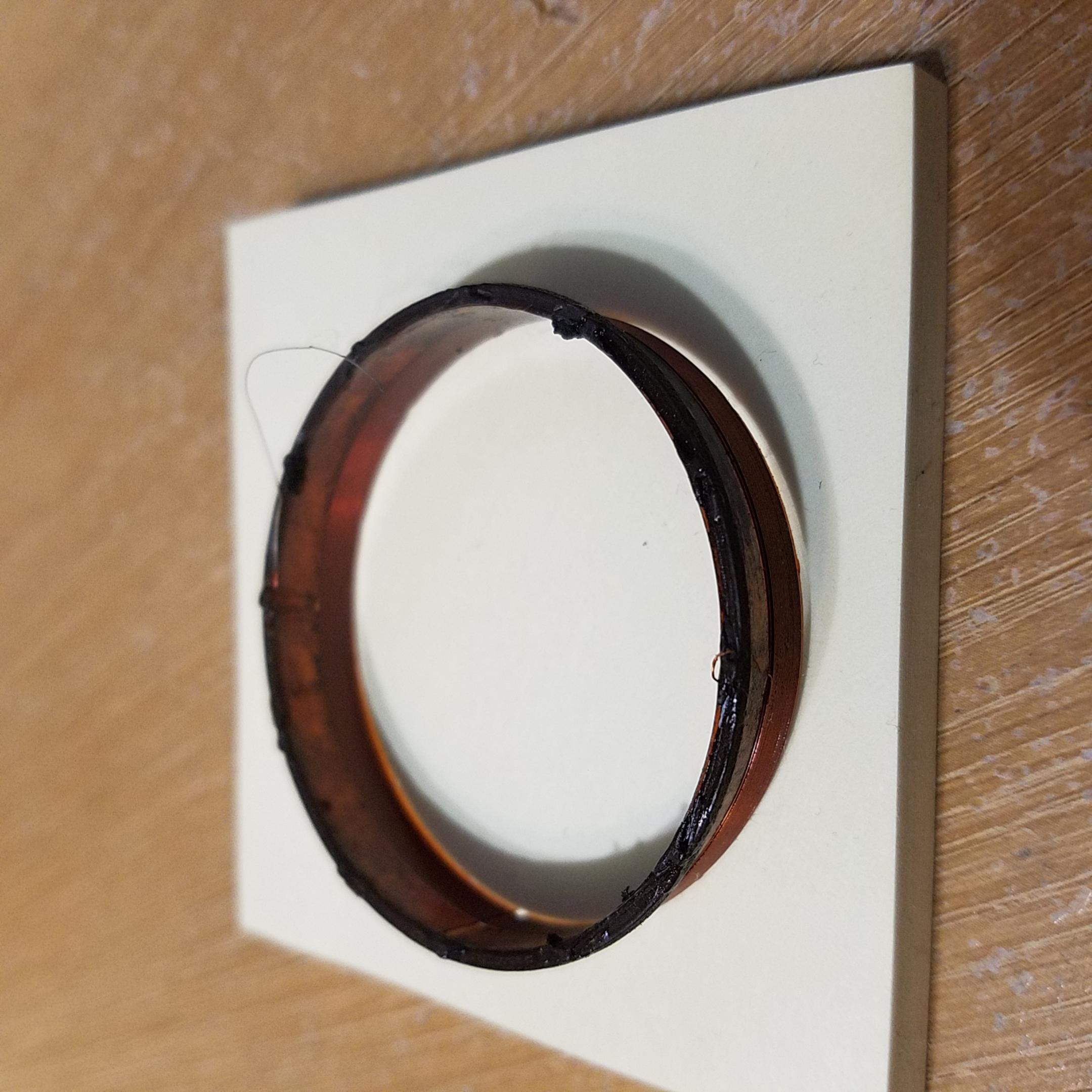

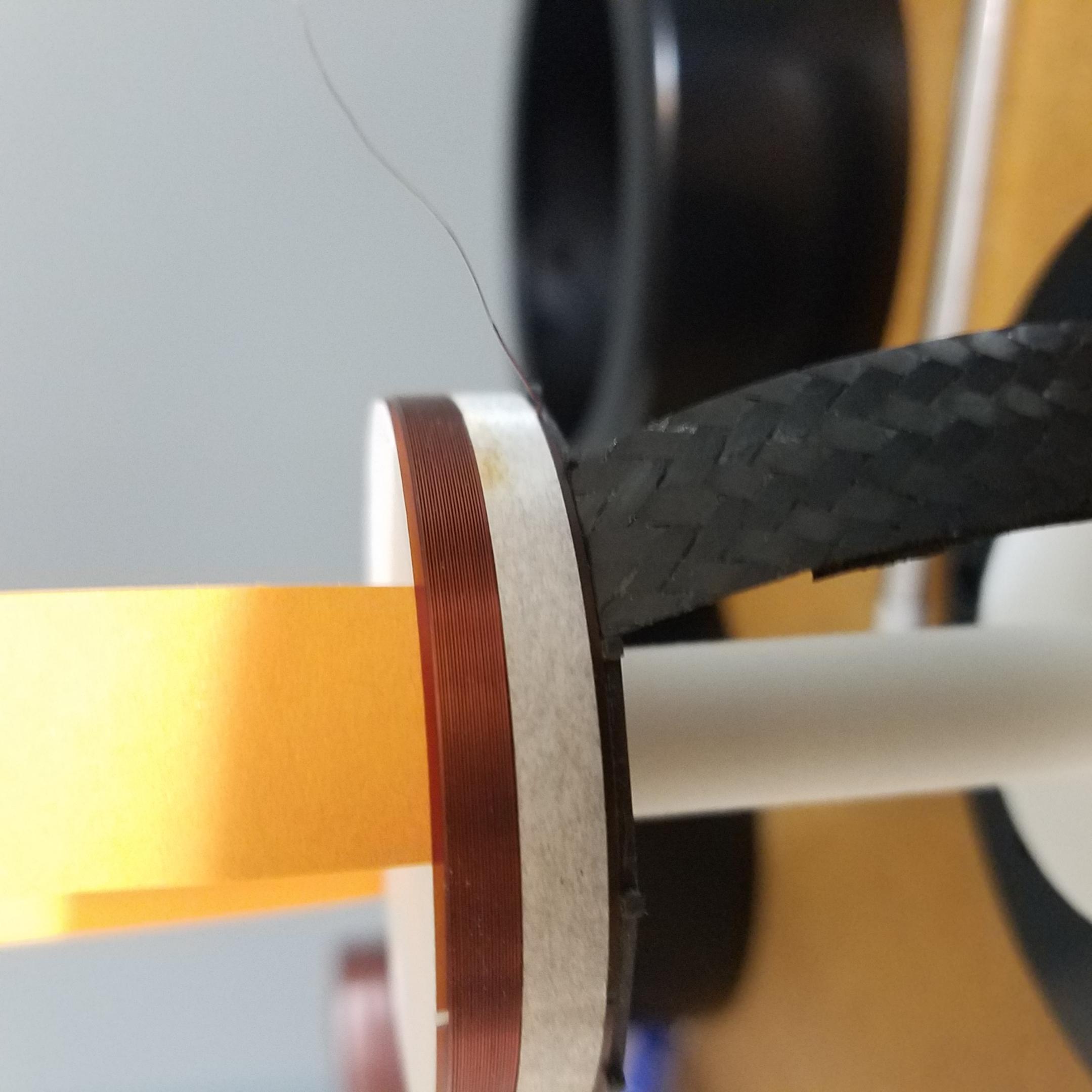

Alingment rig
This is the new alignment rig. The Lamella slots are now on the inside of the voice coil as apposed to the outside on the prior design. This difference allows for closer spacing and overall better fit. I even made a holder to hold the system in place while gluing so I dont have to touch it.
The jig is a great idea...I've been toying with something similar, although my alignments will certainly be child's play in contrast. Happy to see you making progress. *S*

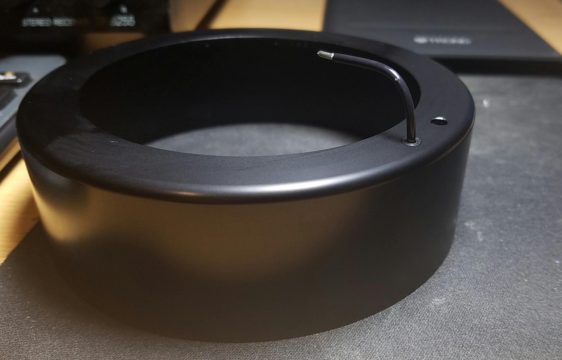

Test

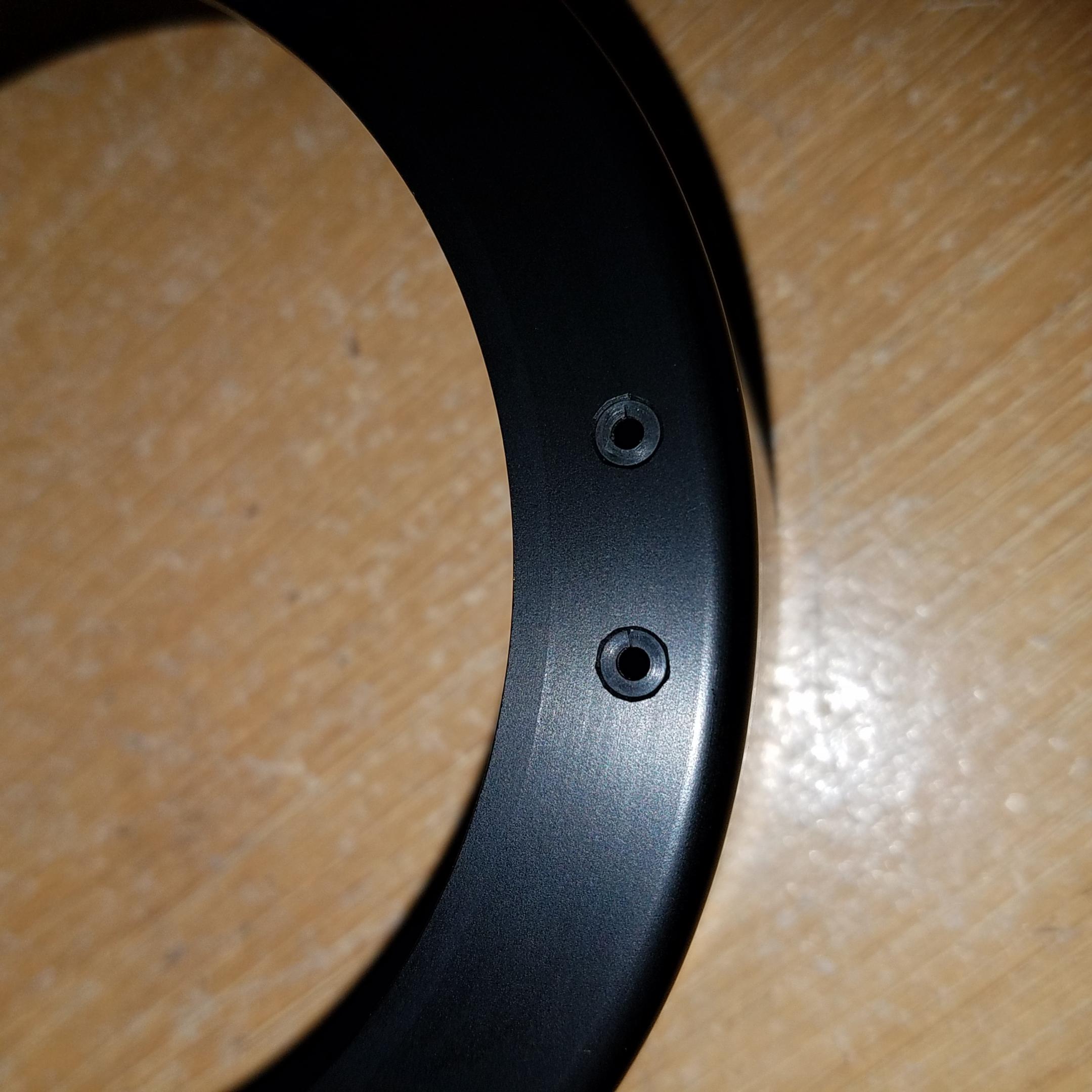

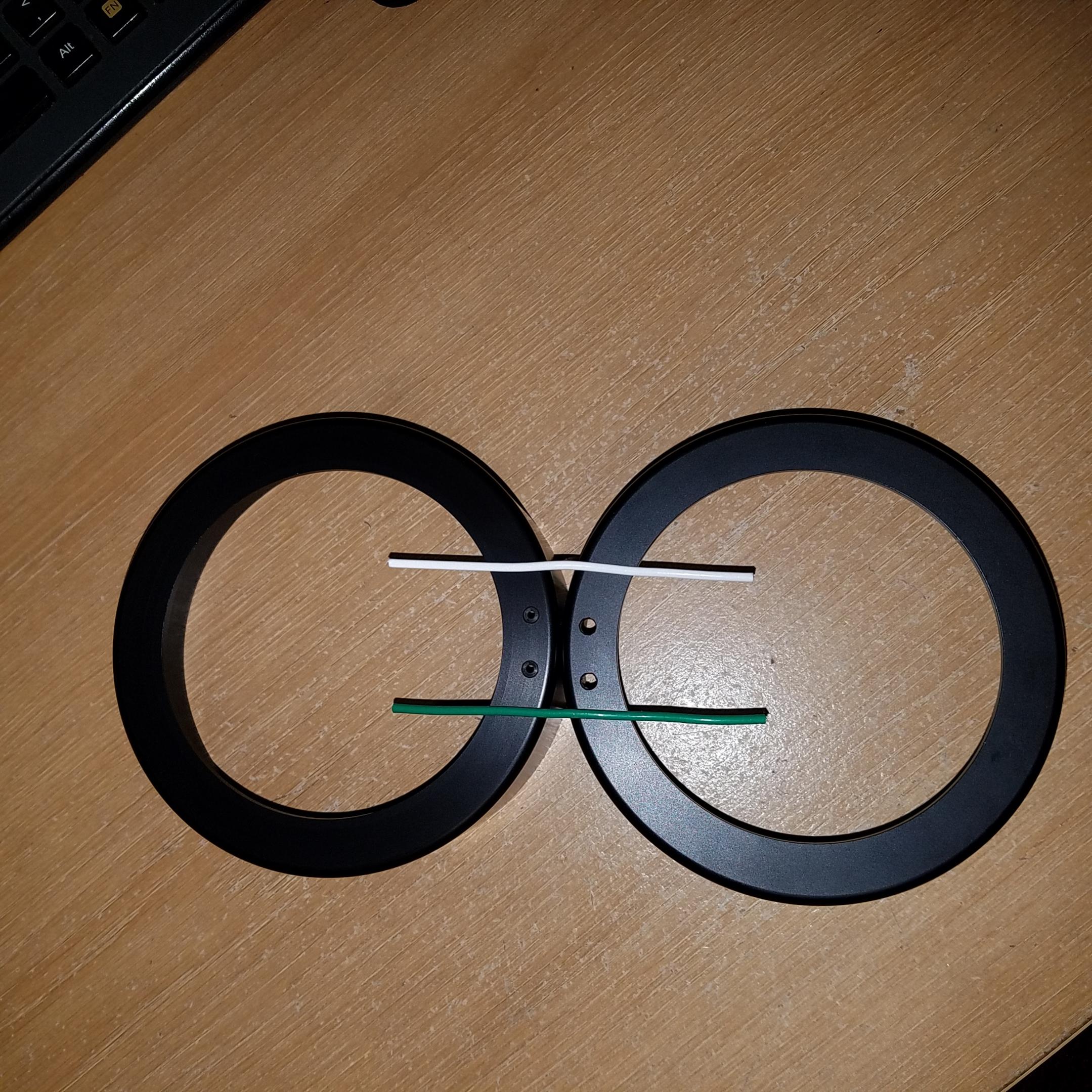

Absolutely you can be among the first to take a listen Jerry, Here is a test fit of the o-ring and cable that will be used for the tweeter section. A few more updates including complete metal structure will be coming.
*G* Great, and thanks. I'll be sure to pack the overnight. (I drive fast, but not That fast...except as required on the 85...combat traffic...)
Stellar...and a beautiful finish on the metal (alum?)...is that powder coat or ano?
