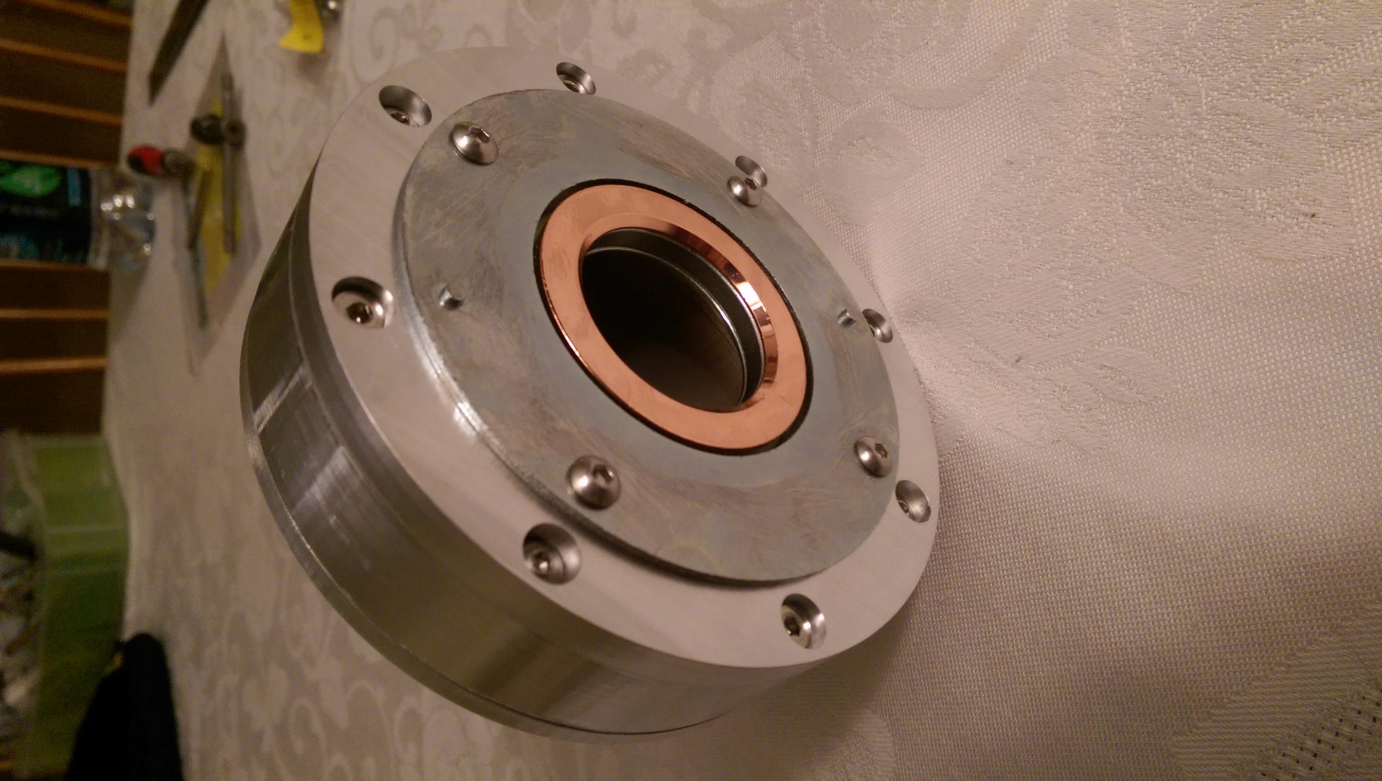

Summer Project - Replication of MBL loudspeaker 101mkII

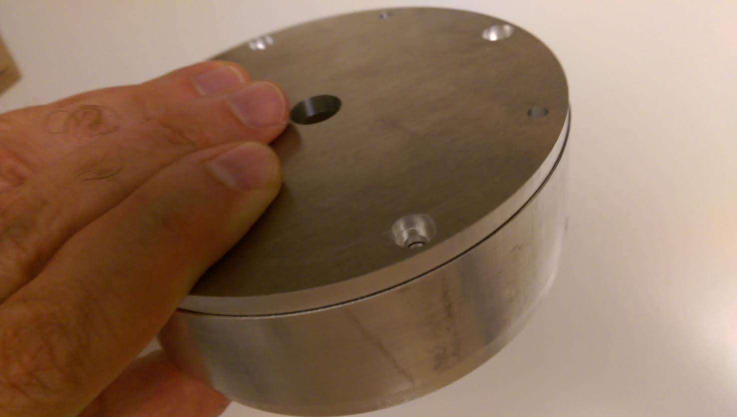

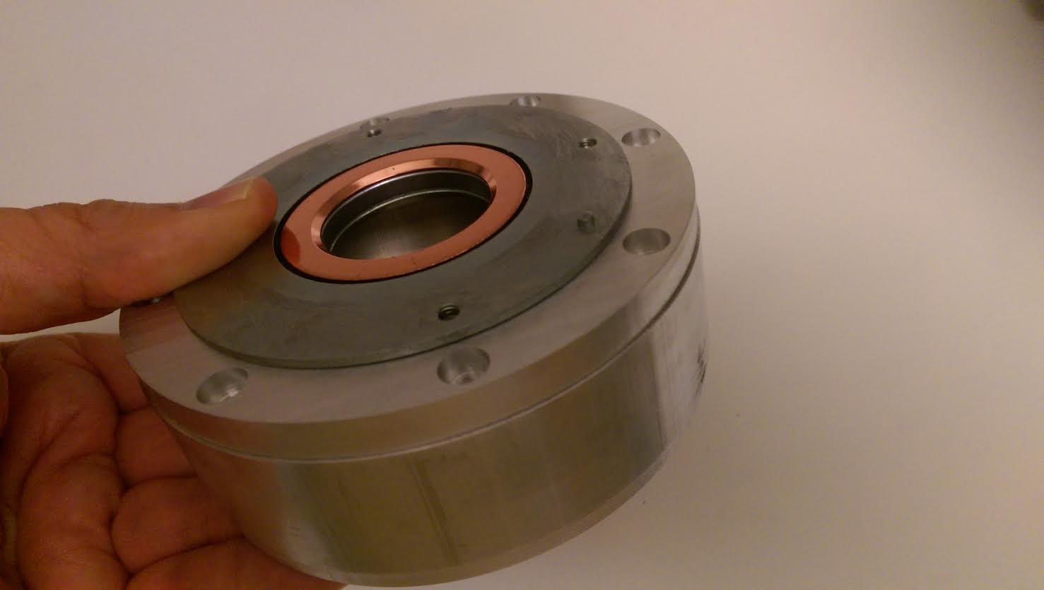

Just got the Motor covers looking sharp The internals are in the works So right now this thing is just dry fitted more or less so the alignment isnt all there and the Diaphragm is the incorrect size and so on.

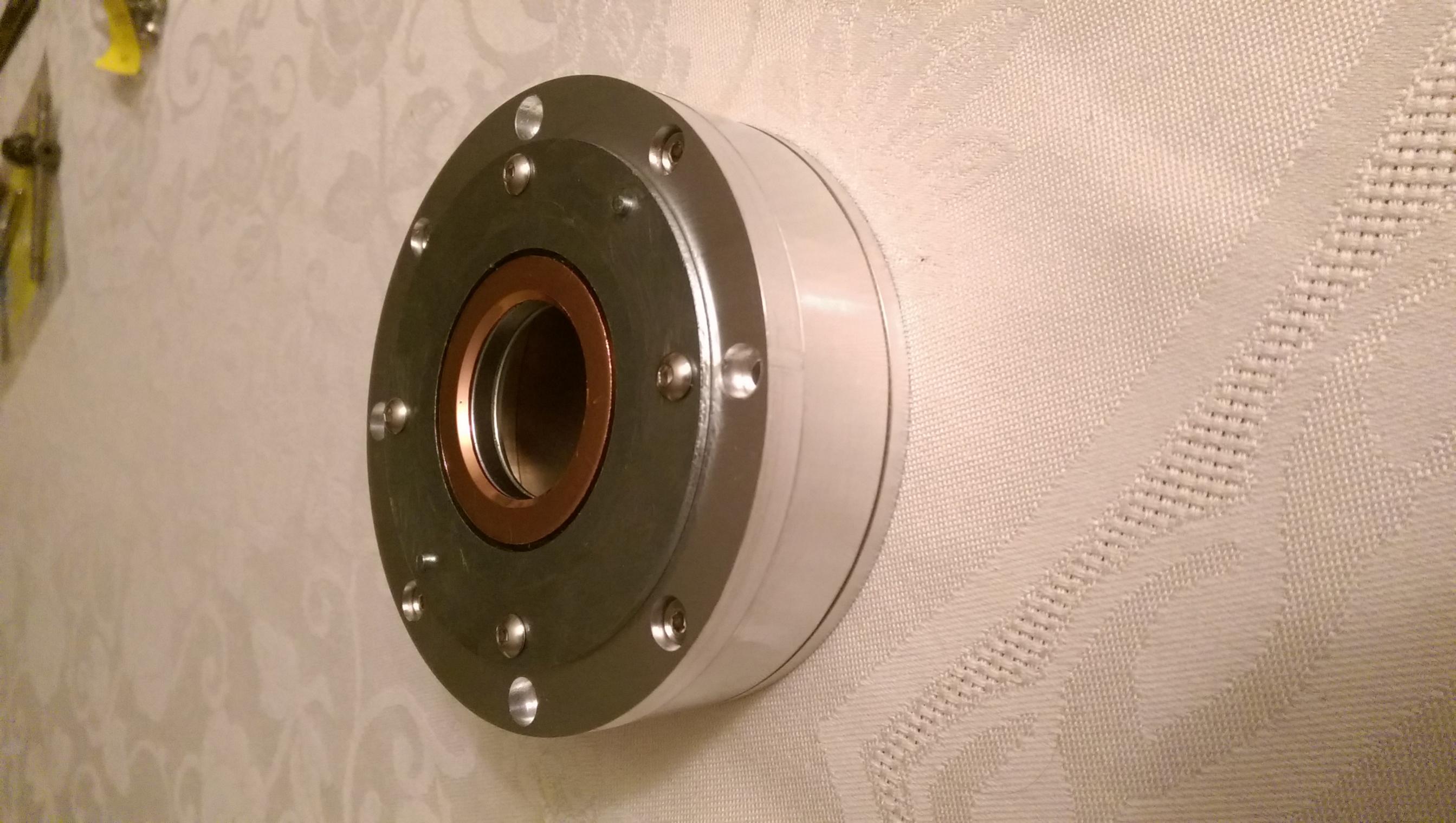

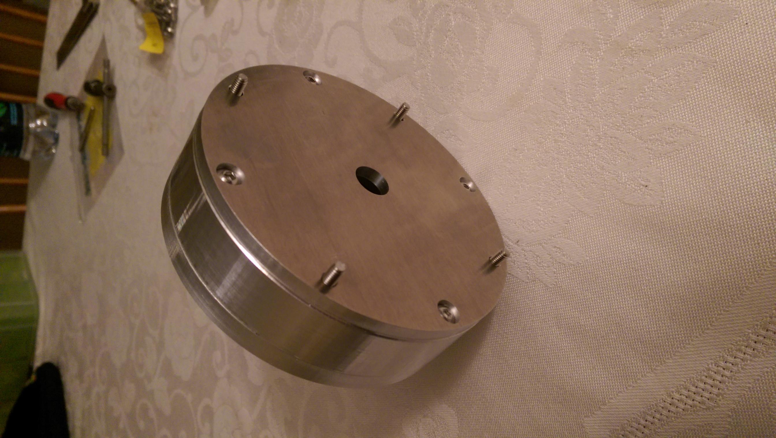

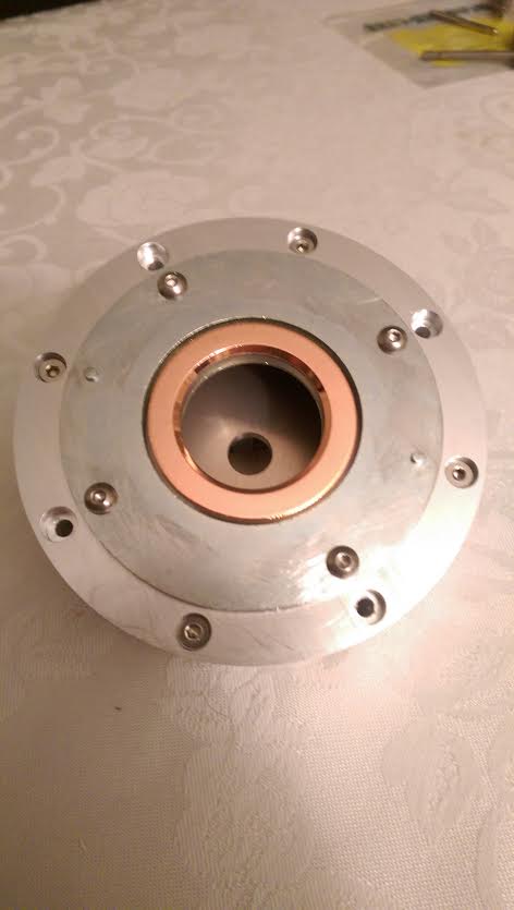

Internals semi complete
These are the internal structures that make up the inside extremely solid there is more about 3 more pieces which are in the works. Made by the same partner who made the motor covers... He will make his debut when he has further works.

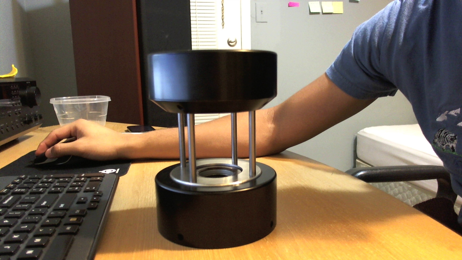

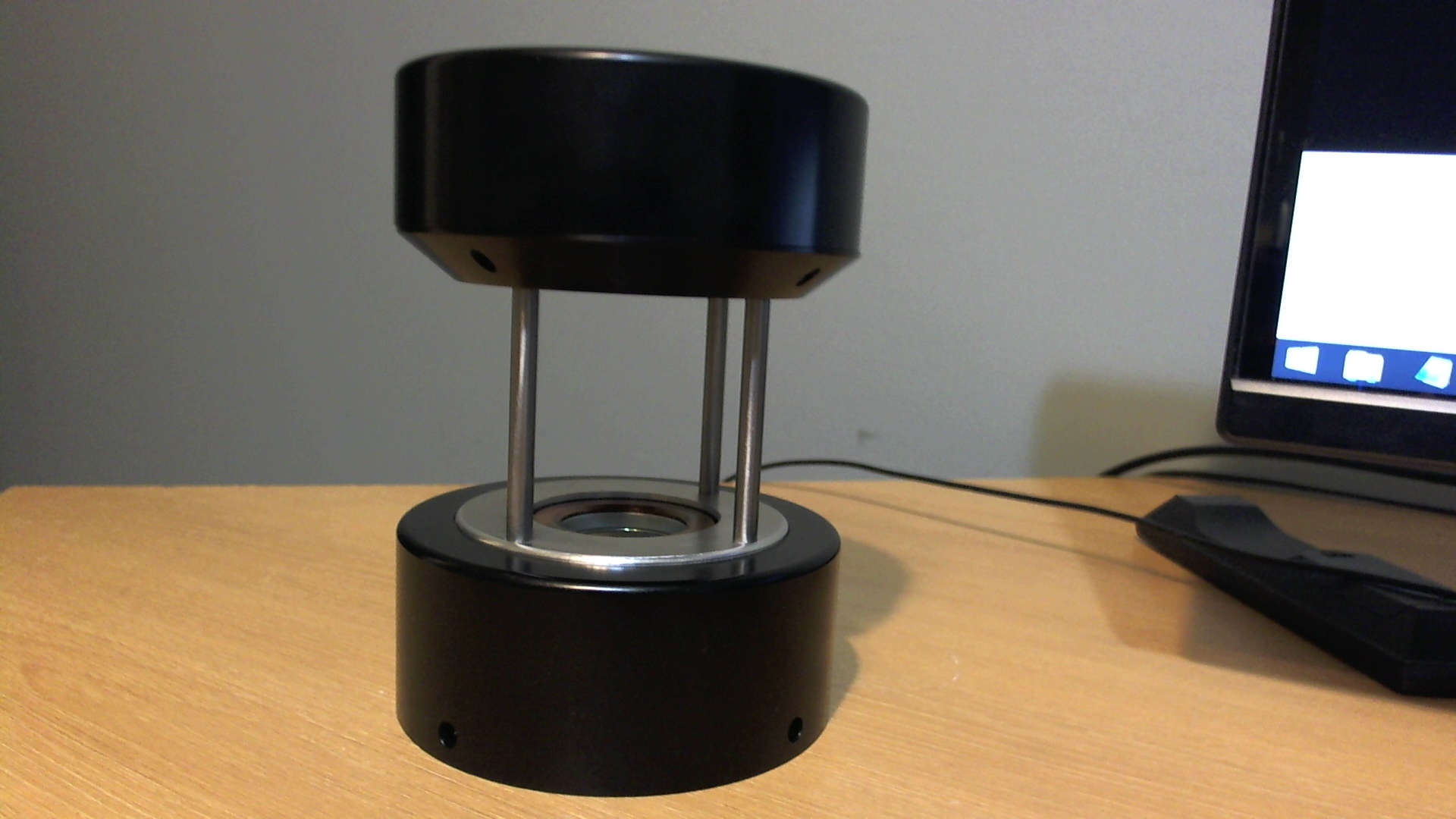

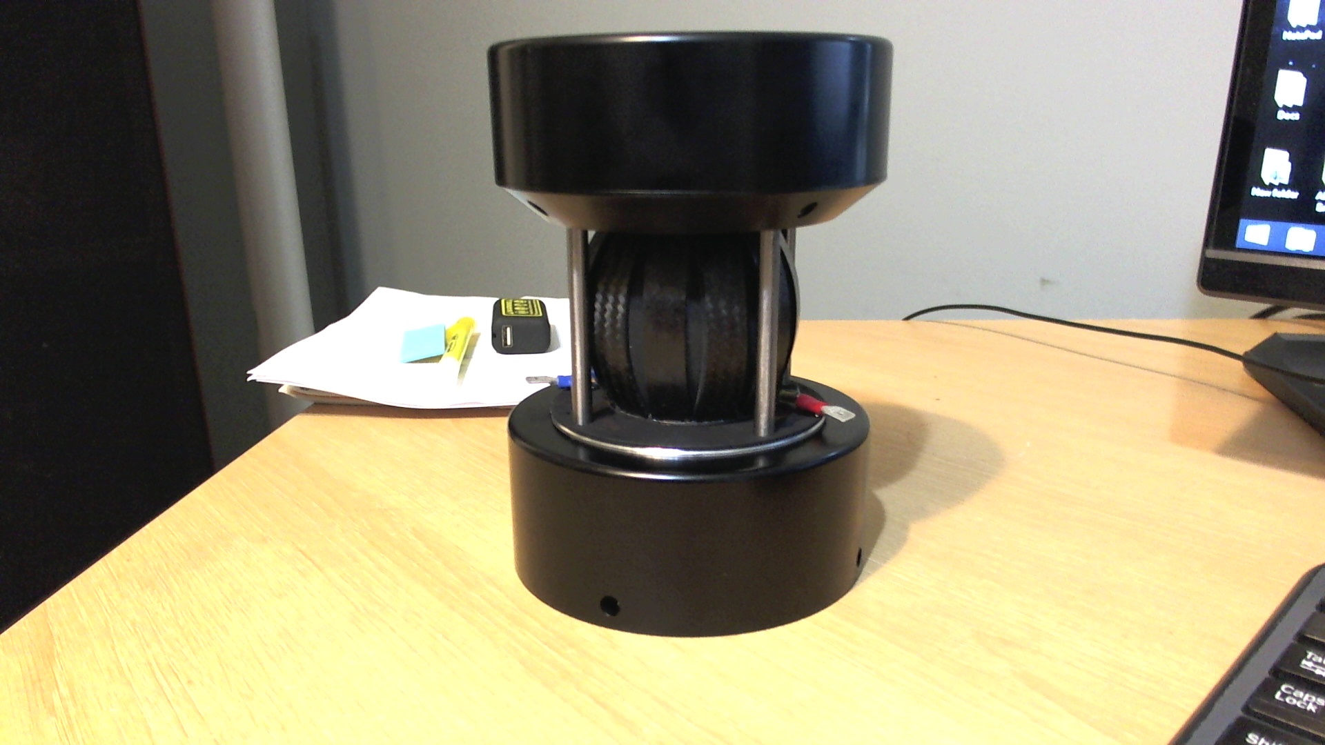

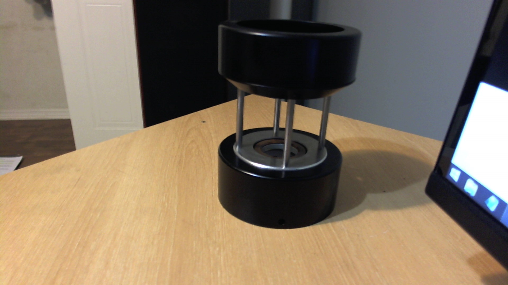

Further Metal Magic
A further look into the internal works As always credit to machining and partnership in design goes to my partner.

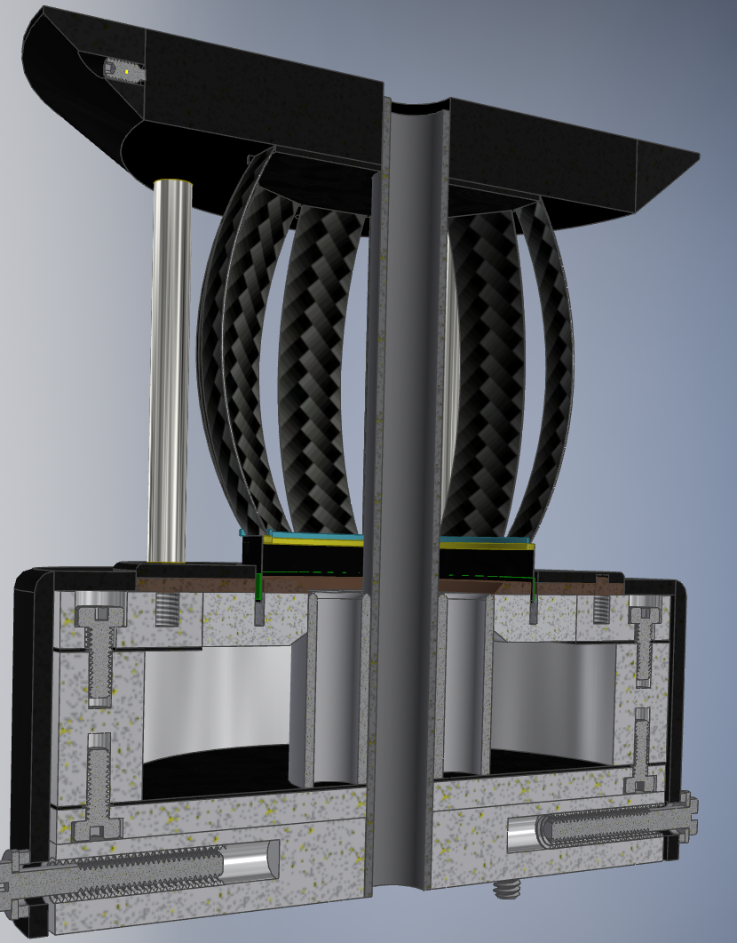

I have some pictures. I honestly could not tell you if they would be plug in play made to the MBL 101mkII specifications. I only have the numbers for the newest model. But really the only thing that could be different is mounting mechanism and voice coil diameter/impedance. Both of these factors can easily be adjusted if you were to send the broken unit to make a replica of that. The only way to make a plug and play unit is to have the numbers of all variables which for this older model is unknown to me.
