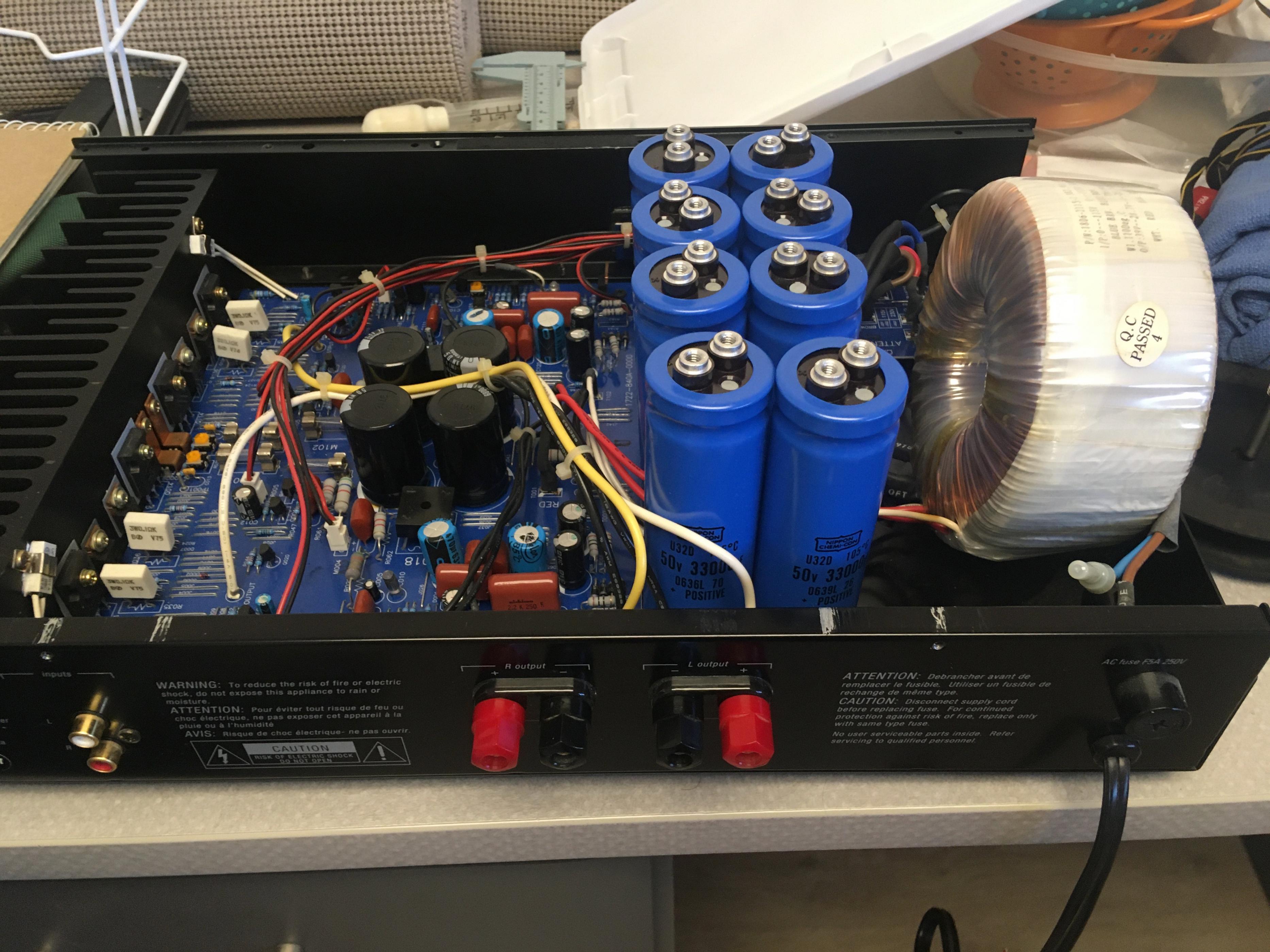

Ok so I got the amp. Later 5200 with separate psi for two channels. I am thinking now if I should just swap 4x6800uf caps for 4x22000uf, keep those on board bridges (I think the are 8A) and crank the bias up. Or... put new soft recover bridges from my FW amps off boards add 4 more caps off board to make CRC psu for each channel? Only concern is that it might be a bit too tight with that bigger board. BTW, do you actually need those 4A on the rails? 🙂

I don't think there exist larger caps than 15000uF in the size that will fit on the pcb (30mm Dia), so adding more caps off-board is your only option. But I haven't searched for a few years now, so we should have another look around.
I don't like the idea of rectifier bridges so close to the amp, so I placed mine off-board (see pic in post 11).
The 4A rail fuses are there to protect itself... Perhaps it would be nice with a bit of capacitance on the other side of the fuses, closer to the output transistors?

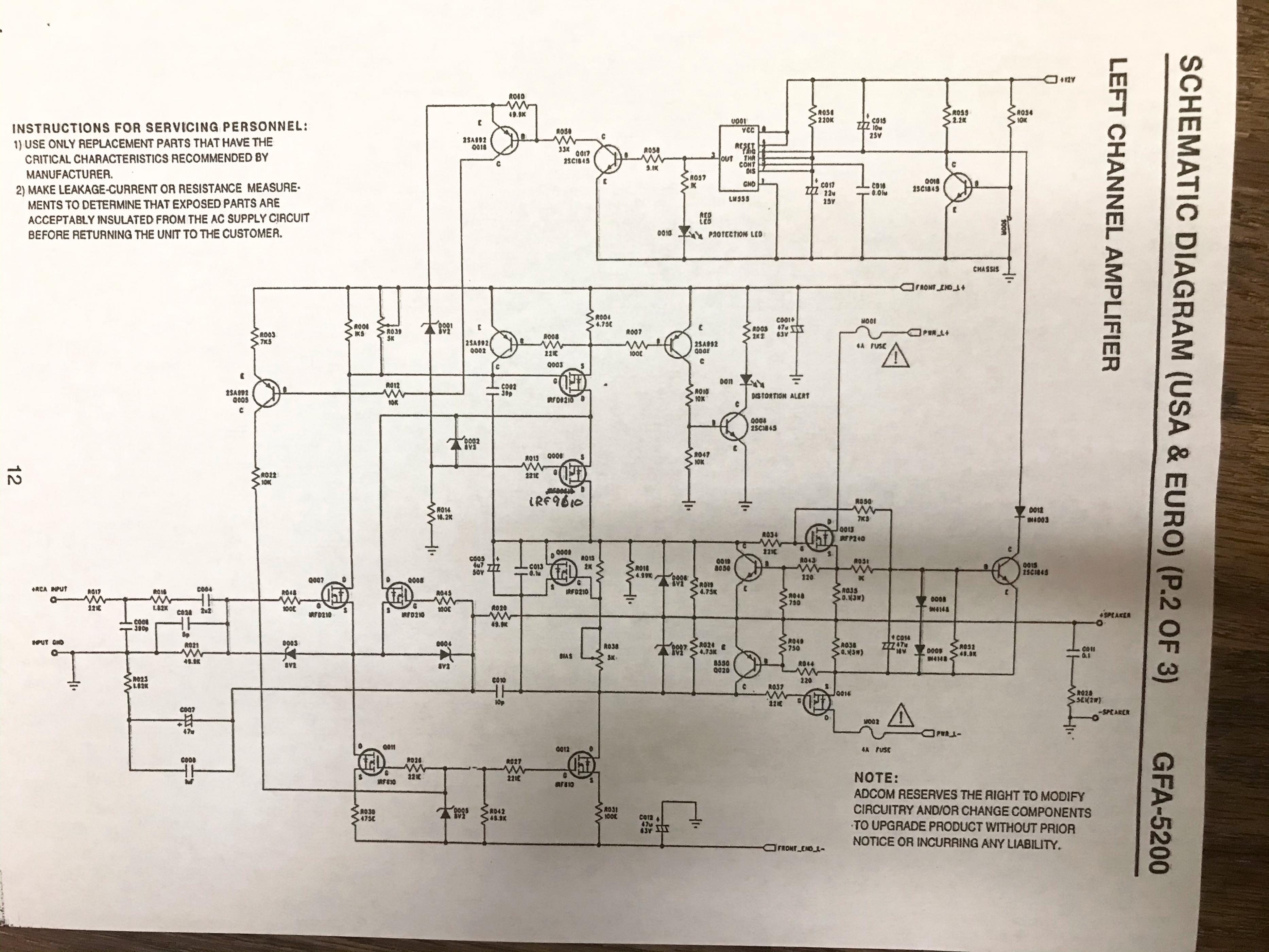

Here's the schematic for the later 5200 with separate front end PS.
There's room for more caps if you stand up the transformer. High hopes for this 5200 mod!
