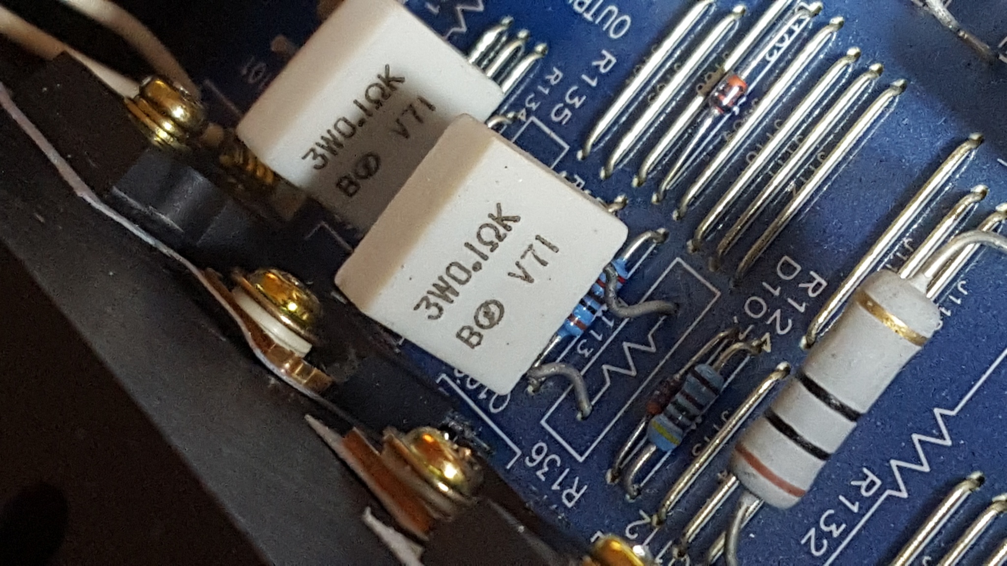

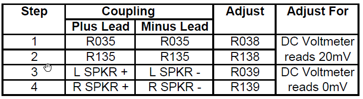

If you are referring to the Adcom service manual for the 5200, then beware: Adcom was sloppy in editing the service manual for the 5300 to create the one for the 5200, and there are errors. Note that the source resistors (R035, R036, R135, R136) in the 5200 are 0R1 (on mine at least) and not 0R33 as in the 5300. Also, while the part numbers are correct, the biasing directions (20mV across R35) are taken from the 5300 and if followed will lead to more bias than intended. The bias on my 5200 when I got it was 0.1A. In your case, jsfinusa, 20mV/0R1 is 0.2A of bias...

Wow, Adcom adds another layer of confusion with different board builds. These are the resistors I have:
attachment.php
You have done some creative things with your 5200. Probably more than I would like to do with this unit. I have the caged gorilla amps for that. I think I want to leave it Vanilla plain or maybe just replace the existing main caps with the largest that will fit there natively. Maybe visit the coupling caps in the future.
Considering that I do not have any intention of increasing the capacity of the power supply section, like you have done, where do you think I should land the mVolt reading across these resistors to keep the performance elevated but not turn it into a Barbie easy bake oven? I don't intend on using any forced cooling but I will make sure it is situated in a manner that allows good convection.

If your 5300 has 0R33 resistors and the 5300 manual is calling for 20mV across them then the factory spec must be shooting for a bias current of .06A (0.020mV / .33 = .06A) right?
If I reverse calculate that bias into my amp with 0R1 resistors I get 6mV across the resistors. (0.1 * .06A = .006V)
Is it safe to say that if there was a correctly published service manual for the 5200 amp this would be their target? I rolled mine back to 11mV and the temp is more realistic. It is a little uncomfortable to keep your palm on the top of heat sink but at least now I can keep my hand there for a full 10 seconds.
I have a infrared temp measure device at my office. I am going to bring it home tomorrow and shoot the heat sink to see what the temp actually is.
Yes, 0.06A per output device, so in the 5300 with 2 output transistors per rail, that's 0.12A total bias, which is about the same as the ~0.1A that I measured on both of my 5200's when I first got them.
But 0.1A of bias is just 1/3W of class A (0.12A is almost 1/2W), and I think with the amp in an open location one could run about 0.2A which would be just over 1W in class A (and then peak much higher in AB).
