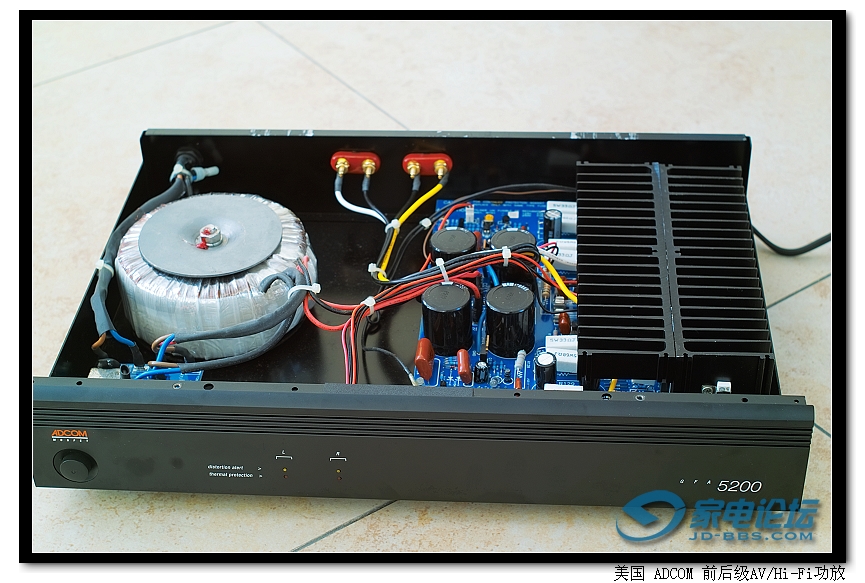

In my attempt to corner the market on used 5200's, I now have a newer updated GFA-5200 to play with (date sticker says 3-97). It has separate windings for the input stage, so input rails are +/-54V while output stage rails are ~42V. (Maybe it can swing the full output rails?) Then it also has separate PS (bridge rectifiers and caps) for each channel, so a useful advantage over the original.
It appears to have been assembled very quickly, and the input signal cable is actually RESTING on one of the rectifier bridges, so clearly cable routing is not one bit important to these hacks. Nor is capacitance: It has only 4 puny 6800uF caps, so it needs some help getting the PS ripple down from an unacceptable ~50mV.

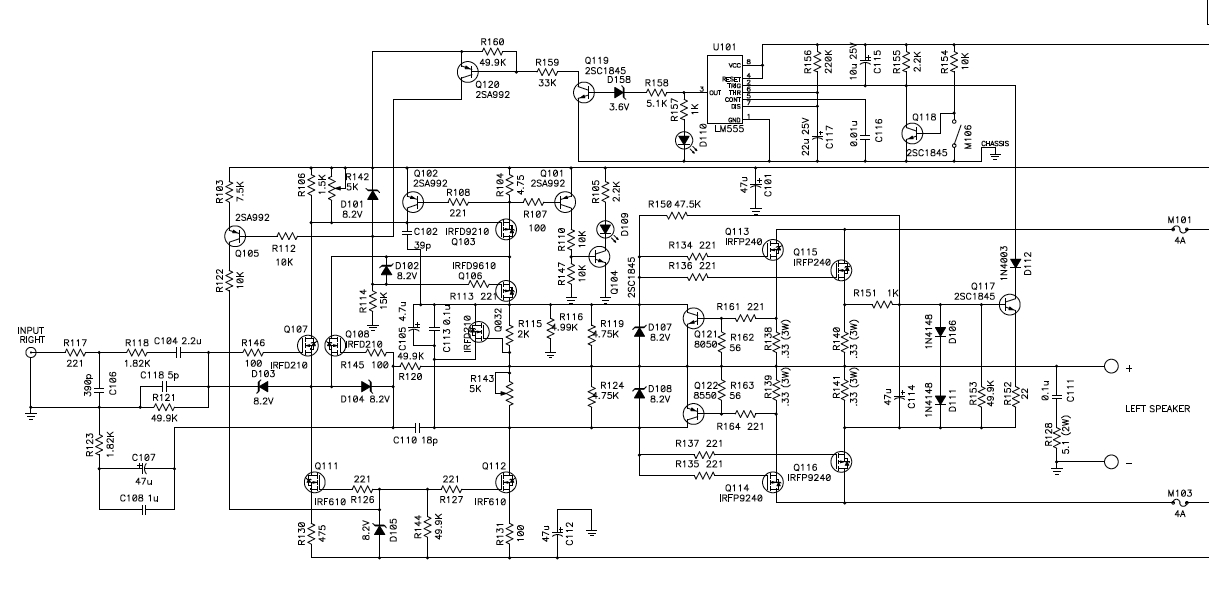

Now, "protection" is something they obsessed over: It has more transistors watching for faults (10) than for making sound (9). I will be referring to the schematic for the 5300 (attached) which is very close to the 5200.
It is my intention to replace the cover with a perforated aluminum cover which will be attached to the existing heatsink for maximum passive heat rejection without the use of a fan.
Stay tuned!
While not being anywhere near as facile with circuits (and this drawing does make it a little more confusing), any thoughts of trying to split C102 into a two-pole/TMC compensation to push more LF loop gain around the output transistors?
Exact opposite

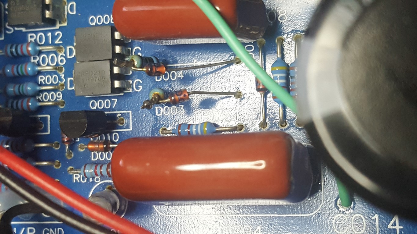

One of the rail fuses was blown. I dont know how both fuses survived as the complimentary pair of output mosfets on one channel were baked short. There were also two small caps sizzling and bleeding onto the PCB. I replaced the caps and yanked the bad output transistors and found myself with an amp that powers up and plays, albeit only on one channel until I can order the replacement mosfets.

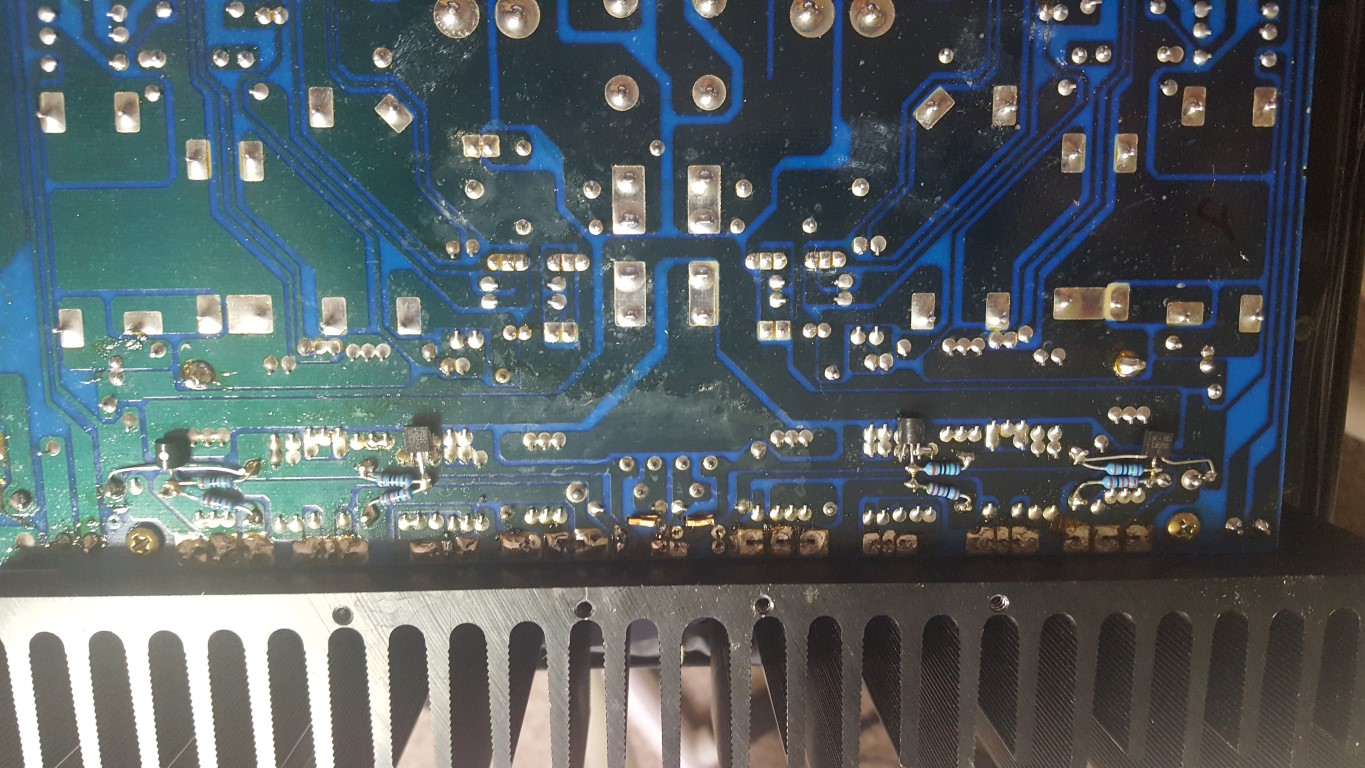

Now here is where I get a little frazzled. I am looking over the PCB and see what appears to be tons of re-work by Adcom. You know the type of re-work that says "Oops, engineering made a boo-boo; let's fire Teddy and lets fix it in post production!"
Is what I am seeing errors that have been corrected or is this someone else attempting aftermarket MOD's to improve the amp? I was a little disappointed to see that much appended electronics.

Until a 5200 schematic shows up, we can keep referring to the attached 5300. It appears the factory was adding Q121 and Q122 (for current limiting) to the underside of the pcb.
My earlier 5200 also has the diode and resistor tied together as shown in your photo, but has no rework or additions on the underside like yours.

Right, I would also assume Feb 1997, so that's as if yours with the ton of rework has an earlier pcb than even my 1995 version (subject of this thread). Strange.
Here's my recollection/speculation: the earliest 5200 were made in Japan, then Taiwan, then later PR of China, and the latest ones were simply 'China.' F.ex my second 5200 has sticker '3-97' and PR of China, but it has dual mono PS as well as extra transformer windings for the input stage, so quite advanced. What's inside yours?

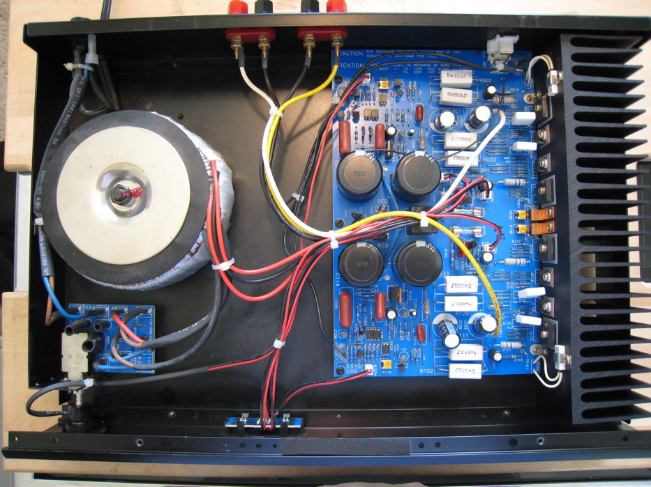

That's a pic of my '95' and I'm pretty sure it doesn't have that stuff underneath (nor on-board), so it appears they added it on underneath to later versions (like yours). And then there is a jump to the '3-97' version which has everything on a larger pcb: dual mono PS, separate input stage windings, current limiting, plus the separate 12V supply.
There's also the amp in attached pic that shows extra heatsinking, although I don't know if that came from the factory, or if someone modded it. It has a single PS, so is an earlier amp.
