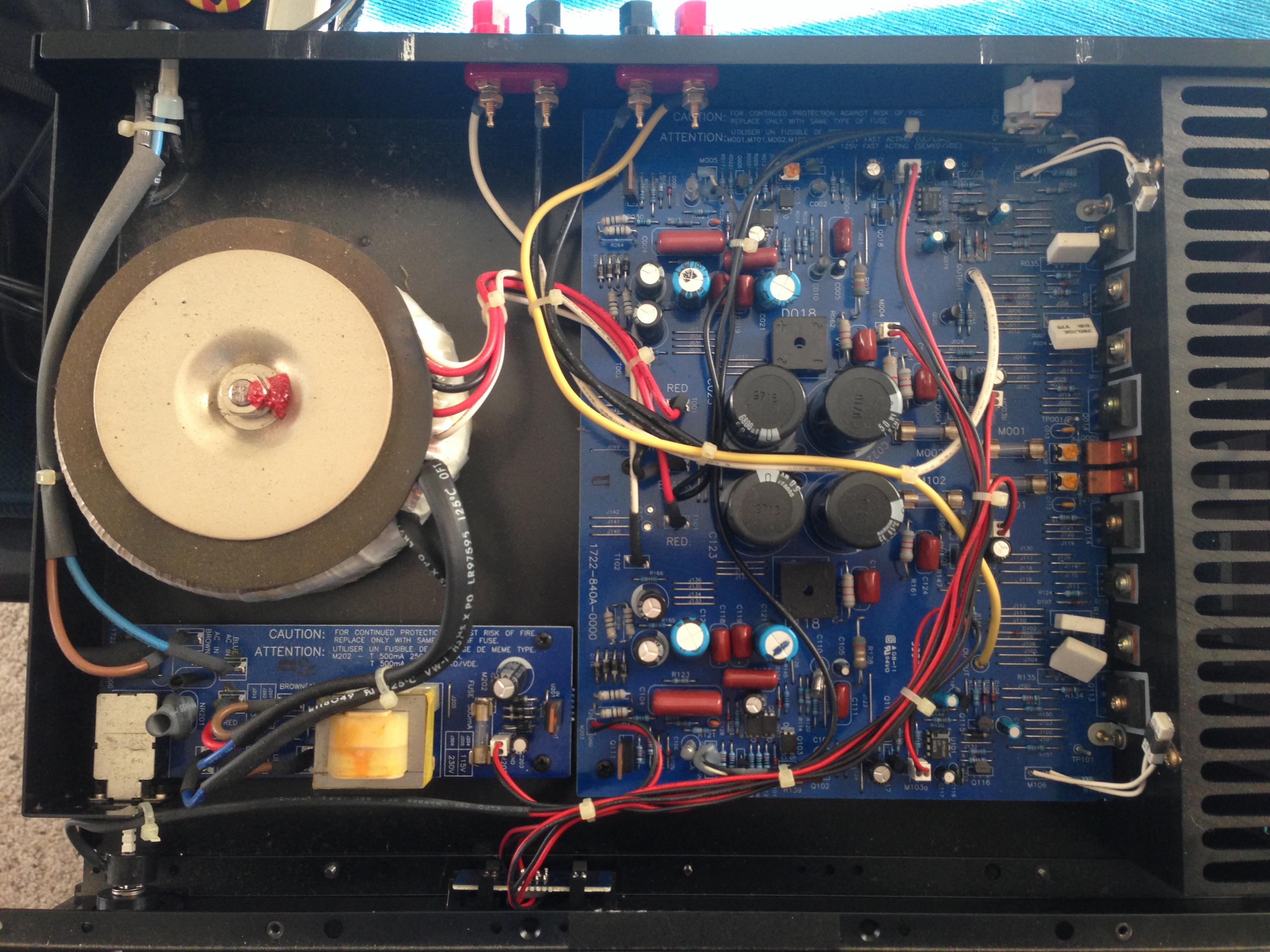

Fresh donor GFA-5200
In my attempt to corner the market on used 5200's, I now have a newer updated GFA-5200 to play with (date sticker says 3-97). It has separate windings for the input stage, so input rails are +/-54V while output stage rails are ~42V. (Maybe it can swing the full output rails?) Then it also has separate PS (bridge rectifiers and caps) for each channel, so a useful advantage over the original.
It appears to have been assembled very quickly, and the input signal cable is actually RESTING on one of the rectifier bridges, so clearly cable routing is not one bit important to these hacks. Nor is capacitance: It has only 4 puny 6800uF caps, so it needs some help getting the PS ripple down from an unacceptable ~50mV.

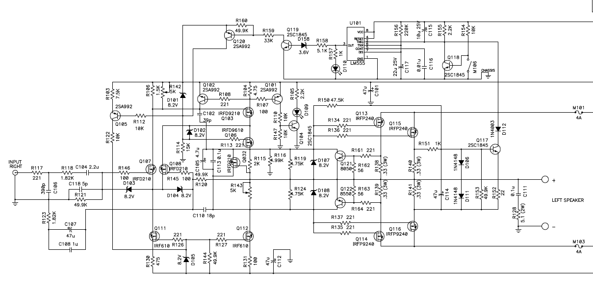

Now, "protection" is something they obsessed over: It has more transistors watching for faults (10) than for making sound (9). I will be referring to the schematic for the 5300 (attached) which is very close to the 5200.

This thread was in the back of my mind when I got a 5200 free with another purchase. This one is blowing those little fuses in the middle. In fact it had been replaced with 5 amp and I put 5's in and it also blew.
I am thinking its something in the PS side cos both fuses are going instantaneously when powered up. I think its the power supply caps.
could someone show me a circuit diagram. Mine has the 2 fuses in the middle of the board not 4. Is it same as an adcom 5002 ?

The fuses that blow inside of the amp are the rail fuses, they are after the main filtering caps and will not blow when one of the main filtering caps fails. The fuse on the rear panel will blow when a main filtering cap goes bad.
The fact that oversized 5A rail fuses were installed means that whatever was failing is almost certainly dead now. I would expect to have to replace the output mosfets in the affected channel.
The adcom 5300 should be very similar only it has 4 outputs per channel versus the two in your 5200. The 5300 schematic can be found online.

Srinath, on yours the ps is common to both channels. One fuse is for the positive rail, and the other is the negative.
Are you saying yours has visibly blown output transistors on both L and R channels?
