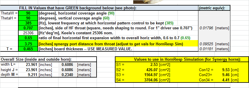

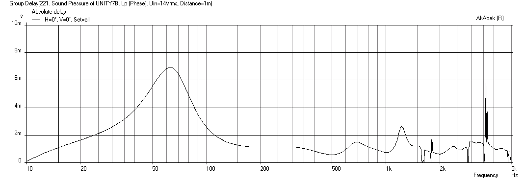

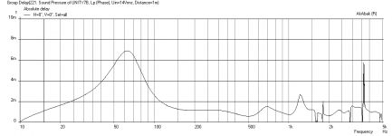

I'm late arriving to this thread and new to the Unity and thought that this would be the best match for my question. I am toying with the Parts Express buyout 6.5 in polycone woofer ($5 ea). It has a relatively high Qts of about 0.95 which makes it a good candidate for getting deeper bass extension in a sealed box. My goal is to make a 2-way Unity so that I can bi-amp with line-level XO. I want to use this for home listening so no high SPL's are needed and I was aiming for about 90dB efficiency at 2.83V and 1 meter.
I started with Bwaslo's spreadsheet and basically used his default design except that I made it a 90 deg x 90 deg horn instead of 90x60.
Here is the screenshot of the input and outputs for simulation. Reason for this is that all panels will be the same and easier for me to make. Also, it provides room for future upgrade to an 8 driver version.

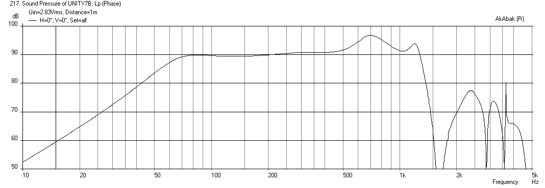

I then made a model in AkAbak for a qnty 4 driver horn with the drivers placed at about the midway point from the CD throat and the angle change of the diffraction edge. I am using 2.5 in dia holes for the bass injection ports from the drivers. I am including the approximate volume of the driver cone behind the port. The enclosure is externally 25 in high x 25 in wide x 16 in deep to provide the volume needed for the four drivers. Since it is a sealed back alignment there won't be any bass reflex port phase issues.
Here is the SPL vs freq with just the bass drivers. I had to add a 12 ohm & 2.4 mH inductor in parallel to tame the rising response. It is pretty good except for the bump near 700 Hz. This bump can be reduced by placing the bass injection port closer to the mouth but the tradeoff is less HF extension ;(will requite a mid driver in a 3-way) The response is predicted to be 59 Hz to 1.3 kHz -3dB. I think this will easily let me use a XO at 1 kHz to 1.2 kHz which works for many different CD's.

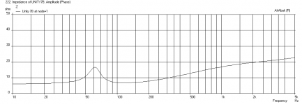

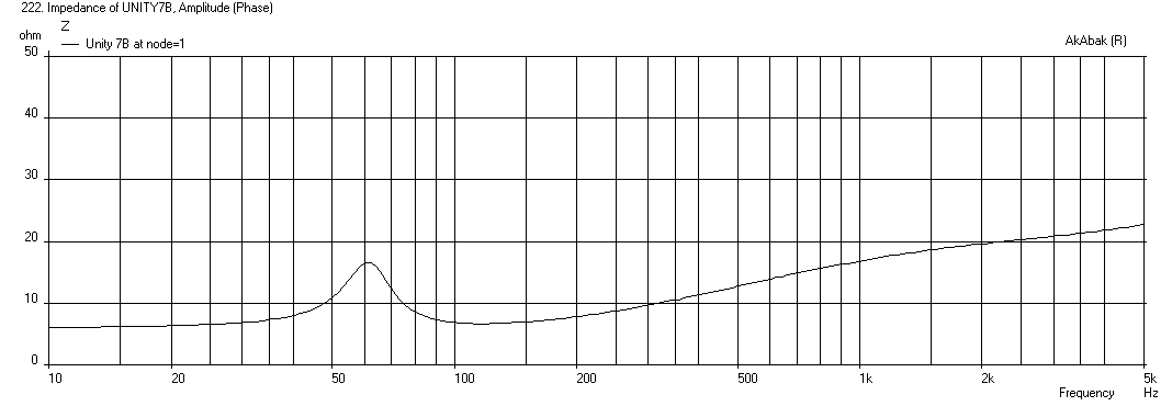

The impedance looks pretty good:

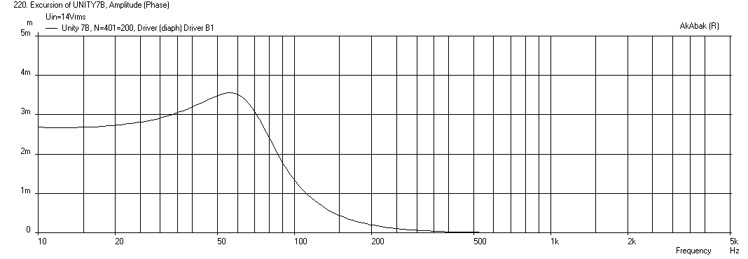

Here is the max cone excursion at about 14 volts rms.
Here is the group delay - excellent from 100 Hz to 1KHz, and not too bad at 60 hz.

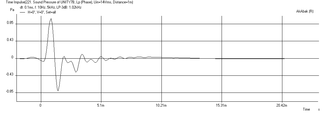

Here is the impulse response - pretty clean.
Let me know what you guys think - is this 2-way approach viable and what can I do better?
Wow I wish I could answer your questions. I have used Bwaslo's spreadsheet also to determine what my horn cut off will be but need to know how to simulate.

I have had some success in my models by putting a gigantic vent in the box - it does change the response dramatically but is dependent on the driver Qts -like an OB. The GD and impulse response were not clean anymore though. I think sealed will give the cleanest transients. I did not know that folks compared Unity's to a room size headphone. That would be bad. Maybe in a room, one should not be using these as they are really suited for stadiums and arenas?
The other way to fix the dip at 1 kHz is to move the injection port farther out to about midpoint of the main expansion. When I do that, the sims show the dip moving from 0.8 kHz to 1.3 kHz.
