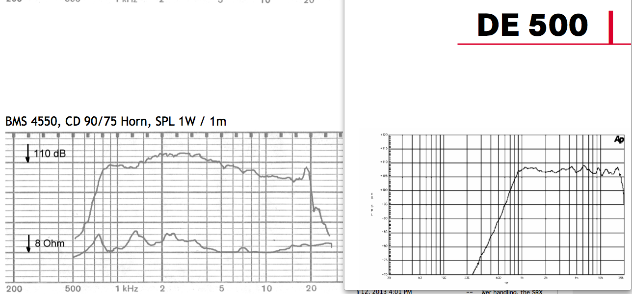

The titanium diaphragm B&C DE 500 is about 12 dB down at 20 kHz, about the same as the BMS 4550.
It does not have as large of a breakup peak as the BMS 4550, and far more LF.
The upper peaks can be equalized in either case, but you can't EQ out distortion caused by lack of displacement.
That said, either 1" would work fine for a three way Synergy, but the B&C DE 500 could be used crossing over low enough that small mid cones would not be needed, saving driver cost and simplifying construction and crossover details.

Weltersys I am seeing maybe a 800hz crossover with the DE500?
I think others have stated the 4550 being used at 900hz cross. I am not sure how using the 500 would help to eliminate the use of mids. I am only asking and not arguing. The DE250 looks very similar to the 500 also. But I am only looking at a small simulation.
Both the horns in post #1406 are not designed to go low, (as you can see in post #1404 the 4550 goes much lower on the conical horn I tested it on) but the 4550 is about -25 at 500 Hz, the 500 about -20 at 500 Hz.Weltersys I am seeing maybe a 800hz crossover with the DE500?
The additional +5 dB and the greater Sd of the B&C DE500 could make upwards of 10 dB difference at a low crossover (around 700-800 Hz), which for home use makes crossing over to a 6" or 8" no problem.

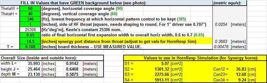

Here is what I managed to come up with for your 15 inch drivers (qnty 2). I ended up putting the bass injection ports at 14.5 in from the throat - you want bass ports to be farther out rather than close in. I had to put a big 3.5 mH coil and fat 8 ohm power resistor to tame the rising response but it is still there - so best to EQ it out rather than burn up precious watts on a resistor. I put this is a 38 in wide x 32 in high x 28 in deep box (3/4 in ply assumed) with qnty 3 x 6.0 in dia x 8 in long bass reflex ports. The bass driver injection ports are 3.0 in diameter.
Here is the input to the spreadsheet:

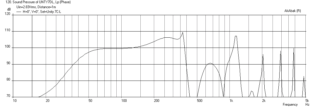

Here is the SPL vs Freq for 2.83V input - pretty sensitive speakers

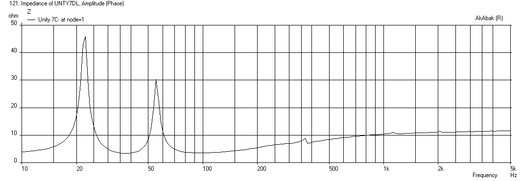

Here is the Impedance curve:

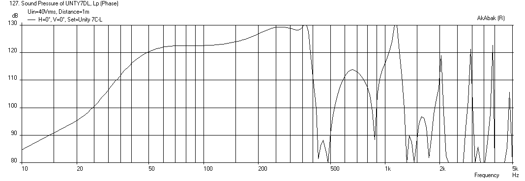

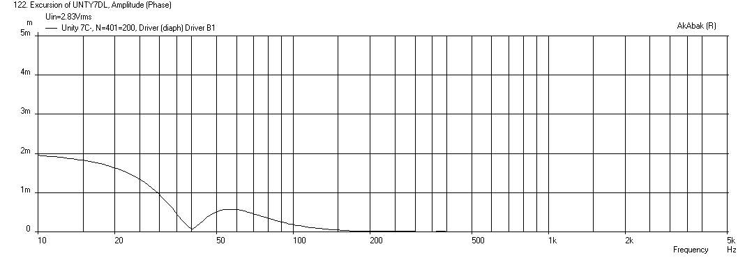

Here is the max cone displacement at 40 volts rms (really needs a high pass filter at 40 Hz):
Here is the corresponding max SPL at max excursion (it will do 122 dB):
At max SPL, there may be some port noise as the velocities are reaching 20 m/s in the ducts. However, I don't think you can hear that given the 122 dB from the main output.
This design achieves providing a high end up to about 350 Hz so that it can be integrated with a mid driver, it achieves usable bass extension down to about 45 Hz.

Here is the Akabak script that I used to model the bass horn for you - you can play with the ports.
