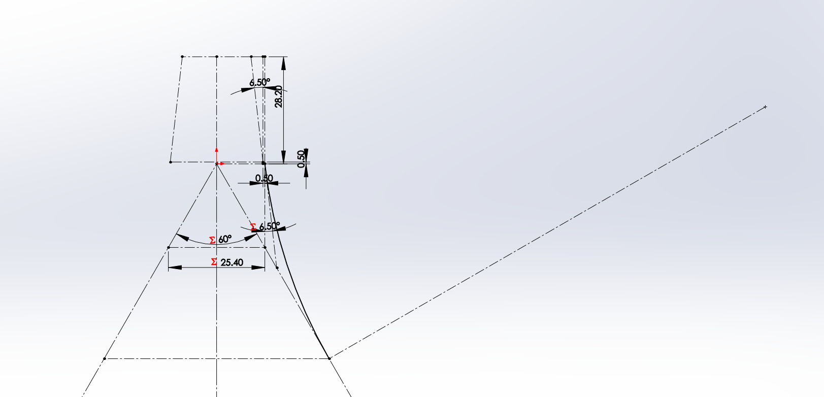

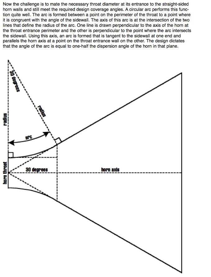

Here is a sketch from the Hughes paper. It shows that the horn throat radius (arc) should be tangent to the horn surface and normal to the driver exit. There is only one unique radius that satisfies those conditions in any plane drawn through the horn central axis.

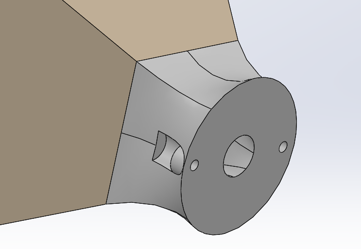

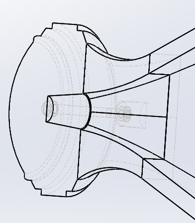

Here´s my take on it:

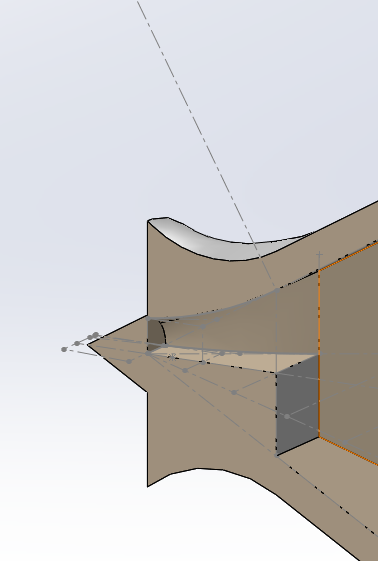

First draw the curves on two sketches. Only top sketch shown here. An equal sketch from the left is also drawn. The bit at the top is a rough guess at the CD exit.
attachment.php

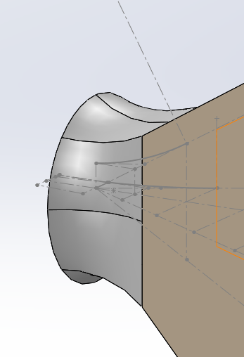

The horn is drawn all the way back (it was simpler that way) and the two curves (from top and left perspective) are lofted to make a quadrant of the externals of the adapter.
attachment.php
The loft is mirrored on both axis.
attachment.php

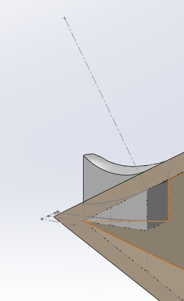

Now make a quadrant of the internal lofted cut:
attachment.php

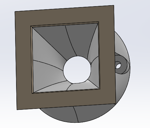

And mirror those twice, add screw holes, remove horn stub etc.
attachment.php
attachment.php
With compression driver dummy model mounted
attachment.php

(Warning: Take this with a grain of salt, as I´m sure the experts will chime in with the true answer, and I don´t know much about horn design or phaseplugs): As far as I understand, the DE250 (as I was thinking to use) has a phase plug already and has a conical expansion at 13 degrees. The shape of the waves should then be suitable to continue a 13 degree expansion, or, as in the adapter here, transform the waves into a 60 degree expansion. I would think that printed phase plugs could be more useful if mating a woofer to a horn than a CD like this.
Would be nice if somebody with more knowledge could confirm/correct this. 🙂
Yep, the phase plug must match the driver and horn, the frequency range etc.
But my brains flashed with this concept of a throat adapter section 3D modelling and 3D printing. This is very versatile and offers great opprotunities for prototyping and making several versions and modifications.
Any frequencies of a wavelength larger than the phase plug slits (that is any audible frequencies) will diffract outward and will "fill" a horn up to around 90 degrees.
The 13 degree exit angle should be faired in to the desired throat angle to avoid an abrupt change in angle and HF diffraction problems.
The smoothed transition does not require a separate throat adapter.
I believe this is what i'm doing with the adapter. Its based on the paper you attach. So rather than building a horn that enda with a square 0.7inx0.7in, i have one that ends at a few cm square. The adapter completes the horn, in a smooth way, ending at a 13 degree angle, and an entry of one inch (circular). I dont claim that its better than smoothing the transition via wood putty or other means. (i will let the experts argue about acoustic merits)
I showed my variant because its a different interpretation of how to implement the hughes adapter than hulkss showed, and would like comments on whether it looks correct based on how others in the forum read the paper.
EDIT: I should add - it´s also fun to get something 3d printed, so that´s one of the motivations for drawing it up like this. 🙂 And: Thank you - interesting about the diffraction filling the horn.
The extra thickness of the adapter is trouble for the mid driver's offset entry location and depth.
Other than that detail, no problem 🙂.
