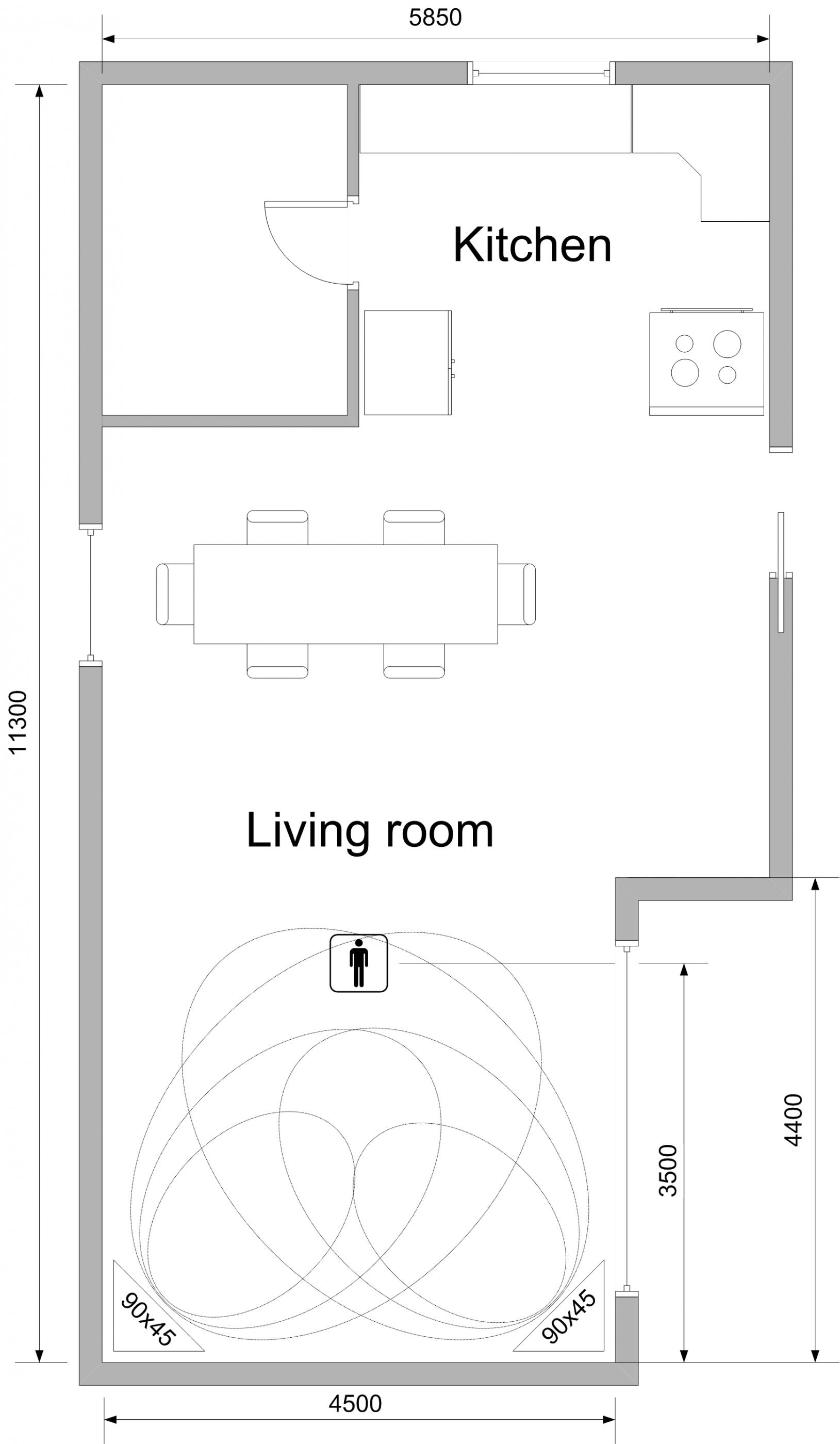

Coverage angle
Hi guys.
I'm trying to figure out which coverage angle will be optimum for my listening room.
How do you guys determine the best coverage angle?
I've made a sketch of my living room with a pair of 90 degree horizontal dispersion Synergies'
Should I perhaps choose a narrower horizontal coverage angle (80 degrees) toeing slightly outward, bringing me closer to the forward axis?
/Thomas
Hi guys.
/Thomas
That is a fine point. Best is likely a matter of taste and experience guiding tradeoffs. Sitting too far back from the crossing of the axes of the horns shouldn't be a problem for the centrally seated listener but might be for someone seated to the side . 90 vs 80 degrees is 5 degrees difference in the horn wall half angle. tan(5) is 0.3 m/3.5m. This might mean the sweet spot increases by that much on each side or it may mean the listeners on the side must be at least .3m from the walls or both! Problem is the 80 degree horn will be significantly deeper...

The acoustic path length of the HF-146 pretty much determines the coverage angle, which will be somewhere between 80 and 90 degrees.
/Thomas

Hi guys.
/Thomas
IMHO the most compelling reason to narrow the angle is that it raises the output level in the octave from 1-2khz. And that simplifies getting the midranges to 'meet' the tweeter.
I documentd that with some illustrations and hornresp sims a few months back on this forum. Can't recall if it was this thread.
Thomas,The acoustic path length of the HF-146 pretty much determines the coverage angle, which will be somewhere between 80 and 90 degrees.
I don't get that statement, you could make the horn any beamwidth you want, though a 5 degree horn with pattern control down to 400 Hz might still be too long even for your pants 😉.
Realistically, anything from 40 to 100 degrees would be no problem.

Thomas,
By narrowing the coverage angle, I'll have to push the mids further down the horn in relation to the tap-in area. This may sacrifice the half-wave criteria in relation to the CD, i.e: if the CD's acoustic path length is very long, this only leaves little distance for the mids. By choosing a wider angle enables you to push the mids closer to the CD!
...you could make the horn any beamwidth you want, though a 5 degree horn with pattern control down to 400 Hz might still be too long even for your pants 😉
You're right, and even our garden can't accomodate a 50m horn with 295m^2 mouth😱
/Thomas
