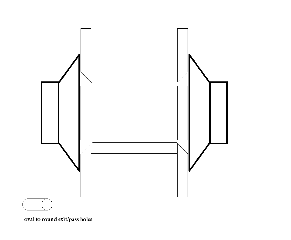

The design challenges you run into with larger cone mids is it requires much larger port holes to reduce the air velocities.
forgetting ...
they may need not be so much bigger using only 2 mids with double pass holes
forgetting ...
I was making the assumption that was exactly what you had planned. Even with two ports per mid, the ports start getting large with a 6" cone. You'll have a hard time keeping the port velocities below 17 m/s even at low power input levels. The larger mids have too much volume displacement.
