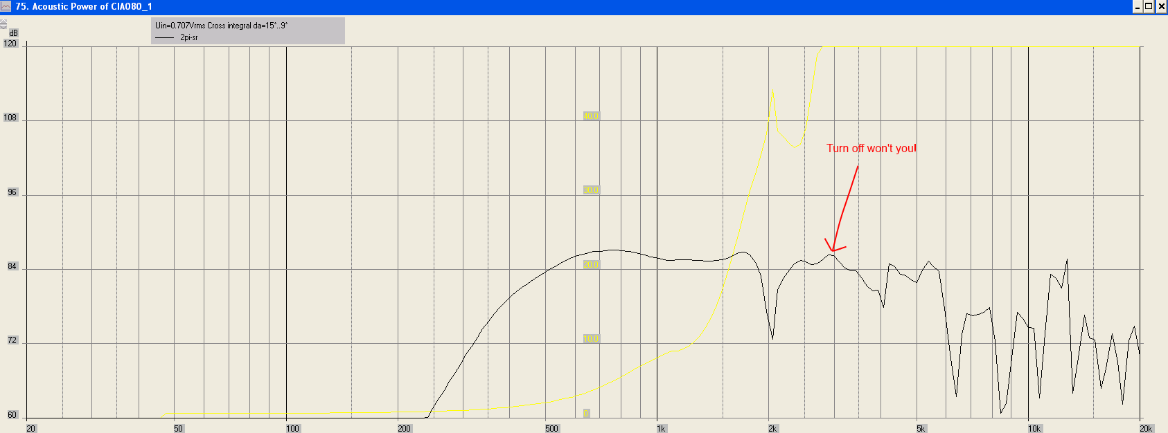

It won't turn off
I'm having a hard time getting the highs to turn off after the first cancellation.
What is the right port adjusting procedure? It seems that when I gain a little succes turning of the high frequency a smidgeon, I loose the gain in the middle😕
/Thomas
/Thomas
Try increasing the front chamber volume of the mid, and also increasing the length of the port.

The closer you get the mids to the compression driver, the smaller the cross sectional area is that you tap into. You can run into problems getting the mids to "turn off" when you operate the mid into a small cross sectional area. You will get much higher horn gain at frequencies where the circumference is longer than one wavelength. So let's say you tap into the horn where the area is only 20cm^2. The circumference of 20cm^2 is 15.85cm. This is equal to one wavelength at 2161Hz. Therefore, you will get very high horn gain at frequencies of 2161Hz or lower. Gain will increase as frequency goes down because the wave is acoustically large in relation to the physical horn area. If you wanted to crossover at 1200Hz, this would make "turning off" the mid more difficult.
The above has to do with how I go about selecting the coverage angles of a horn design. You have to balance coverage with what is realistic to build. I would love to build a 60 X 40 Synergy, but with small drivers you start to run into some construction problems. Many of which I am uncomfortable with the required compromises. Just because I feel like I have a good understanding how Synergy horns work, doesn't mean they are any easier for me to build them. I struggle just like everyone else on this forum.
