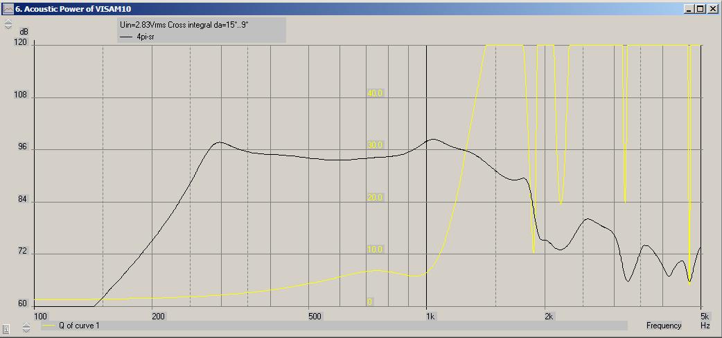

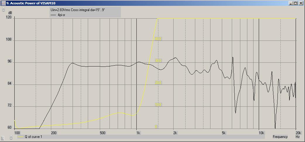

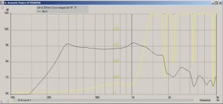

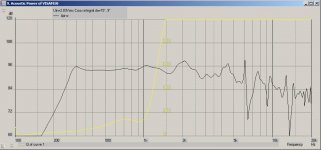

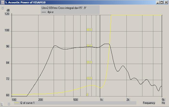

Sorry this took so long. Been busy with the kid's school projects and sports. I had to make some changes to the first script because it was physically impossible to build; things would not fit in the real world. The first attachment is the raw simulated midrange response. The second attachment is the simulated response with the compression driver added in without a crossover. I do this to see how close the drivers are to naturally summing together. If this normally looks good, then the crossover work is a lot easier. See the script below. Ignore the resistors, caps, and inductors in the top of the script. They are not being used. Also note that I have the amplifier output impedance set to 2 ohms for a tube amp.
System 'Unity'
Def_Driver 'CompDriver' | D220Ti-OMF compression driver
Sd=15.2cm2
Bl=8.0Tm
Cms=3.45E-05m/N
Rms=0.4Ns/m
Fs=850Hz
Le=0.12mH
Re=12.5ohm
ExpoLe=0.618
Def_Driver 'MidDriver' |Visaton M 10 4" mid
Sd=59.86cm2
Bl=3.18Tm
Cms=3.23E-05m/N
Rms=1.07Ns/m
fs=609Hz
Le=0.33mH
Re=7.1ohm
ExpoLe=0.618
Def_Const | Unit is cm
FcMid_Len=1.9e-2; | Front Mid chamber length
FcMid_dD=8.5086e-2; | Front Mid chamber diameter
FcPortMid_Len=2.54e-2; | Mid Enrty Port length
FcPortMid_dD=2.2e-2; | Mid Entry Port diameter
Rg=2.0; |Amplifier output impedance (ohms)
R1Comp = 39; |Compression driver Crossover R1 resistance (ohms)
R2Comp = 25; |Compression driver Crossover R2 resistance (ohms)
R3Comp = 8.2; |Compression driver Crossover R3 resistance (ohms)
C1Comp = 5.6e-6; |Compression driver Crossover C1 capacitor (Farads)
C2Comp = 1.0e-6; |Compression driver Crossover C2 capacitor (Farads)
C3Comp = .33e-6; |Compression driver Crossover C1 capacitor (Farads)
C4Comp = 22e-6; |Compression driver Crossover C2 capacitor (Farads)
L1Comp = 1.8e-3; |Compression driver Crossover L1 inductor (Henries)
L2Comp = 0.033e-3; |Compression driver Crossover L1 inductor (Henries)
C1Mid = 45e-6; |Mid Driver Crossover C1 capacitor (Farads)
R1Mid = 20; |Mid Driver Crossover R1 resistance (ohms)
R2Mid = 5.6; |Mid Driver Crossover R2 resistance (ohms)
L1Mid = 3.3e-3; |Mid Driver Crossover L1 inductor (Henries)
S1 = 1.275e-4; |WG1 throat area & Comp phase plug(sq cm)
S2 = 5.067e-4; |WG2 mouth area & horn segment 2 throat area & compression driver exit(sq cm)
S3 = 14.19e-4; |WG3 mouth area & horn segment 3 throat area(sq cm)
S4 = 36.21e-4; |WG4 mouth area & horn segment 4 throat area & midrange tap point(sq cm)
S5 = 975e-4; |mouth
S6 = 1425e-4; |mouth flare out
L12 = 4.2e-2; |WG1 axial length(cm)
L23 = 1.7e-2; |WG2 axial length(cm)
L34 = 1.3e-2; |WG3 axial length(cm)
L45 = 24.3e-2; |mouth flare
L56 = 1.5e-2; |mt
VrcComp = 0.08e-3; |compression driver Rear chamber volume (litres)
LrcComp = 0.84e-2; |compression driver Rear chamber average length (cm)
VtcComp = 0.75e-6; |compression driver Throat chamber volume (cc)
AtcComp = 15.520e-4; |compression driver Throat chamber cross-sectional area (sq cm)
ArcComp = VrcComp / LrcComp; |Conversions for CompDriver
LtcComp = VtcComp / AtcComp;
Sd=59.86E-02;
Duct 'CompRearChamber' Node=30=31
SD={ArcComp} Len={LrcComp} Visc=0
Driver 'D1' Def='CompDriver' Node=0=2=31=32
Duct 'CompFrontChamber' Node=32=140
SD={AtcComp} Len={LtcComp} Visc=0
Radiator 'Diaphragm2' Node=100 SD={Sd} Label=2
Radiator 'Diaphragm3' Node=101 SD={Sd} Label=3
Radiator 'Diaphragm4' Node=102 SD={Sd} Label=4
Radiator 'Diaphragm5' Node=103 SD={Sd} Label=5
Driver 'D2' Def='MidDriver' Node=2=40=100=120
Driver 'D3' Def='MidDriver' Node=40=0=101=121
Driver 'D4' Def='MidDriver' Node=2=41=102=122
Driver 'D5' Def='MidDriver' Node=41=0=103=123
Duct 'DuMid_Fc1' Node=120=130 dD={FcMid_dD} Len={FcMid_Len}
Duct 'DuMid_Fc2' Node=121=131 dD={FcMid_dD} Len={FcMid_Len}
Duct 'DuMid_Fc3' Node=122=132 dD={FcMid_dD} Len={FcMid_Len}
Duct 'DuMid_Fc4' Node=123=133 dD={FcMid_dD} Len={FcMid_Len}
Duct 'DuMid_BP1a' Node=130=170 dD={FcPortMid_dD} Len={FcPortMid_Len}
Duct 'DuMid_BP2a' Node=130=170 dD={FcPortMid_dD} Len={FcPortMid_Len}
Duct 'DuMid_BP1b' Node=131=170 dD={FcPortMid_dD} Len={FcPortMid_Len}
Duct 'DuMid_BP2b' Node=131=170 dD={FcPortMid_dD} Len={FcPortMid_Len}
Duct 'DuMid_BP1c' Node=132=170 dD={FcPortMid_dD} Len={FcPortMid_Len}
Duct 'DuMid_BP2c' Node=132=170 dD={FcPortMid_dD} Len={FcPortMid_Len}
Duct 'DuMid_BP1d' Node=133=170 dD={FcPortMid_dD} Len={FcPortMid_Len}
Duct 'DuMid_BP2d' Node=133=170 dD={FcPortMid_dD} Len={FcPortMid_Len}
Resistor 'Amplifier Rg' |Amplifier output impedance
Node=1=2
R={Rg}
Waveguide 'WG1'
Node=140=150
STh={S1}
SMo={S2}
Len={L12}
T=1
Waveguide 'WG2'
Node=150=160
STh={S2}
SMo={S3}
Len={L23}
T=1
Waveguide 'WG3'
Node=160=170
STh={S3}
SMo={S4}
Len={L34}
Conical
Waveguide 'WG4'
Node=170=180
STh={S4}
SMo={S5}
Len={L45}
Conical
Waveguide 'WG5'
Node=180=190
STh={S5}
SMo={S6}
Len={L56}
Conical
Radiator 'Horn mouth'
Node=190
SD={S6}
x=0
y=0
z=0
HAngle=0
VAngle=0
