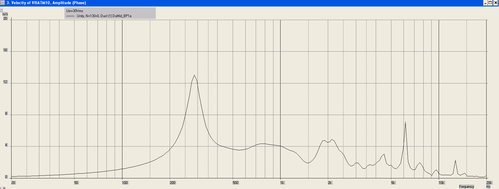

Regarding your Visaton script, couldn't you get away with making the ports smaller then 2.2cm? At 30V input the port velocity only hits 13m/s @ 285Hz.
Maybe I can answer this myself... I reduced the ports to 1.8cm and this resulted in a middle gain loss of 1.5dB, so I'm guessing that would be the reason.

John!
/Thomas
Every choice has a cause and effect. Also note that while I choose to simplify the script by using round ports, in real life I use slotted ports. I make the ports' width and length follow the Golden Ratio. So in case of that Visaton M10 script, the ports are approximately 1.55cm X 2.5cm and not really 2.2cm diameter

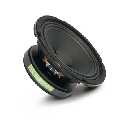

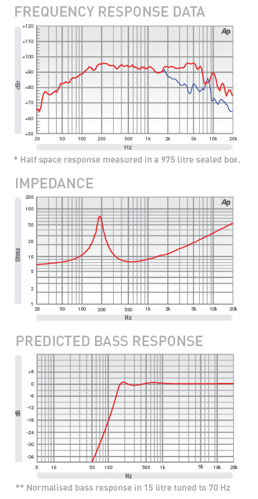

Fane 6" midrange :scratch2:
The design challenges you run into with larger cone mids is it requires much larger port holes to reduce the air velocities. This in turn pushes the crossover point lower, which then forces you to use a larger compression driver, which results in a larger throat area and cross sectional mid tap in point.....etc. And it goes on and on.
The practical cutoff for mid size is about 5.25". You might be about to get away with a 6" if you use a 1.4" or 2" compression driver that can work down to about 600Hz - 700Hz. I had a design for using a pair of Eminence Beta-6A mids with Faital HF146 compression drivers. I never took it anywhere because dropping $500 just on the compression drivers is too much for my blood.
