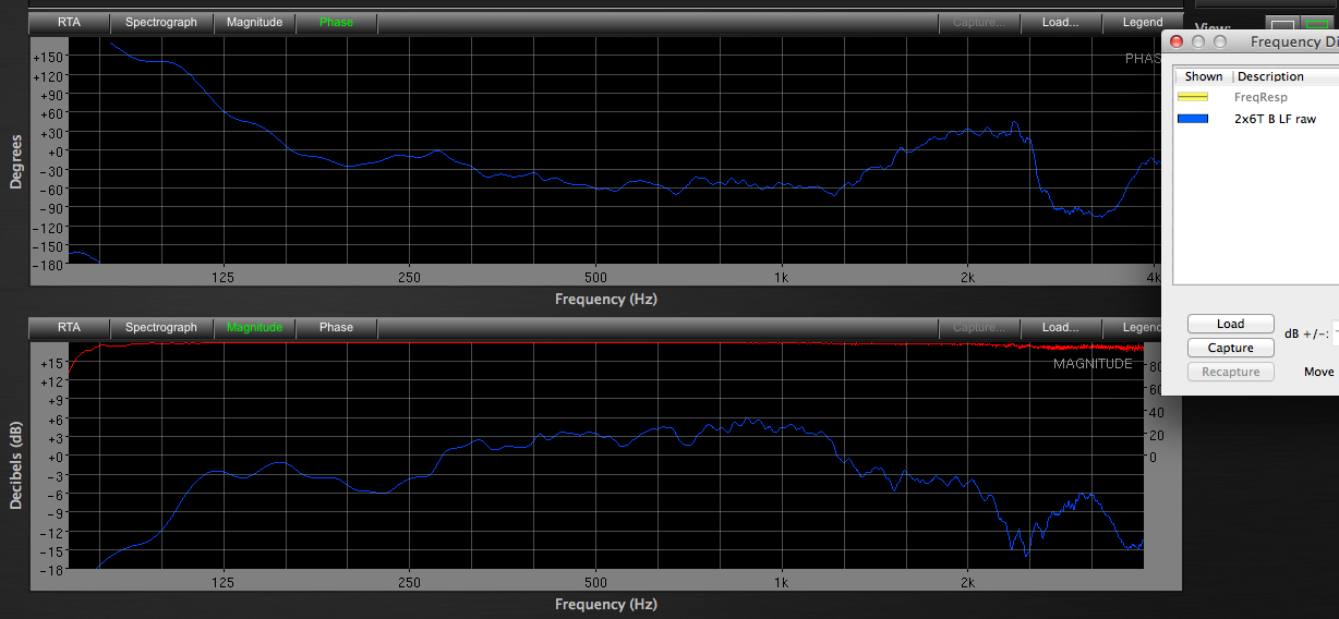

The raw phase response of my little 2x6 conical horn/vented alignment deviates about 60 degrees between 200-2kHz, while the "real" DSL SH-100, a vented 2 -way coax deviates about 80 degrees, and the sealed back midrange SH-50 drops about 180 degrees.
All the cabinets exhibit similar phase lag around Fb, where the port output is 180 degrees lagging. By an octave above Fb, the phase response is not much affected by the port.
At any rate "someone" could do the simming you suggest, but the actual measured response has already been done, and they prove your "hunch" is off 😉.

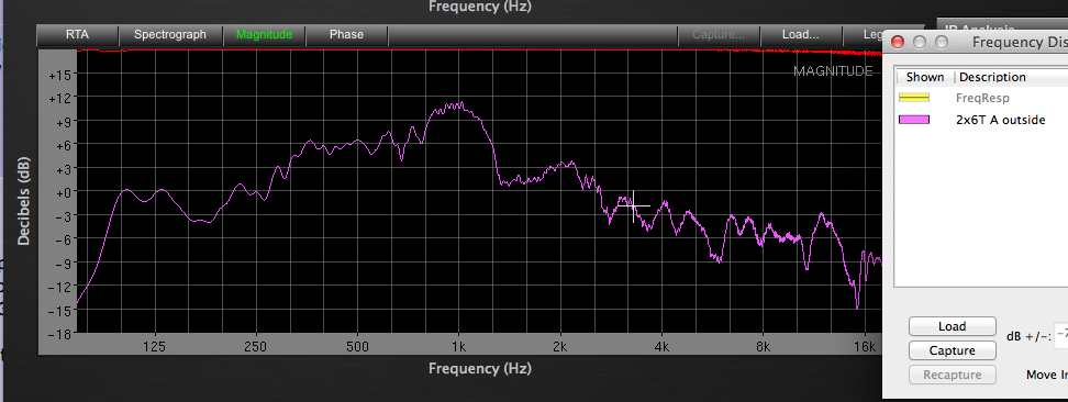

In posts # 14 and #23 of this thread:
http://www.diyaudio.com/forums/multi-way/240429-help-first-pa-system-build-3.html
there are more details of the 2x6T cabinet.
With some EQ it is a really good sounding cabinet, but it is not flat enough for "hi fi" home use without.
