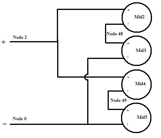

If you have the T/S parameters to a closed back driver, then you should NOT include a back chamber.
To wire drivers in series/parallel you just use node numbers arranged in series/parallel. In the below example the "+" terminal is node number 2 and the "-" terminal is 0. Mid drivers 2 and 3 are put in series by node number 48. Mid drivers 4 and 5 are put into series by node 49. The whole thing is in parallel because of applying drive voltage between nodes 2 and 0.
Driver 'D2' Def='MidDriver' Node=2=48=100=120
Driver 'D3' Def='MidDriver' Node=48=0=101=121
Driver 'D4' Def='MidDriver' Node=2=49=102=122
Driver 'D5' Def='MidDriver' Node=49=0=103=123

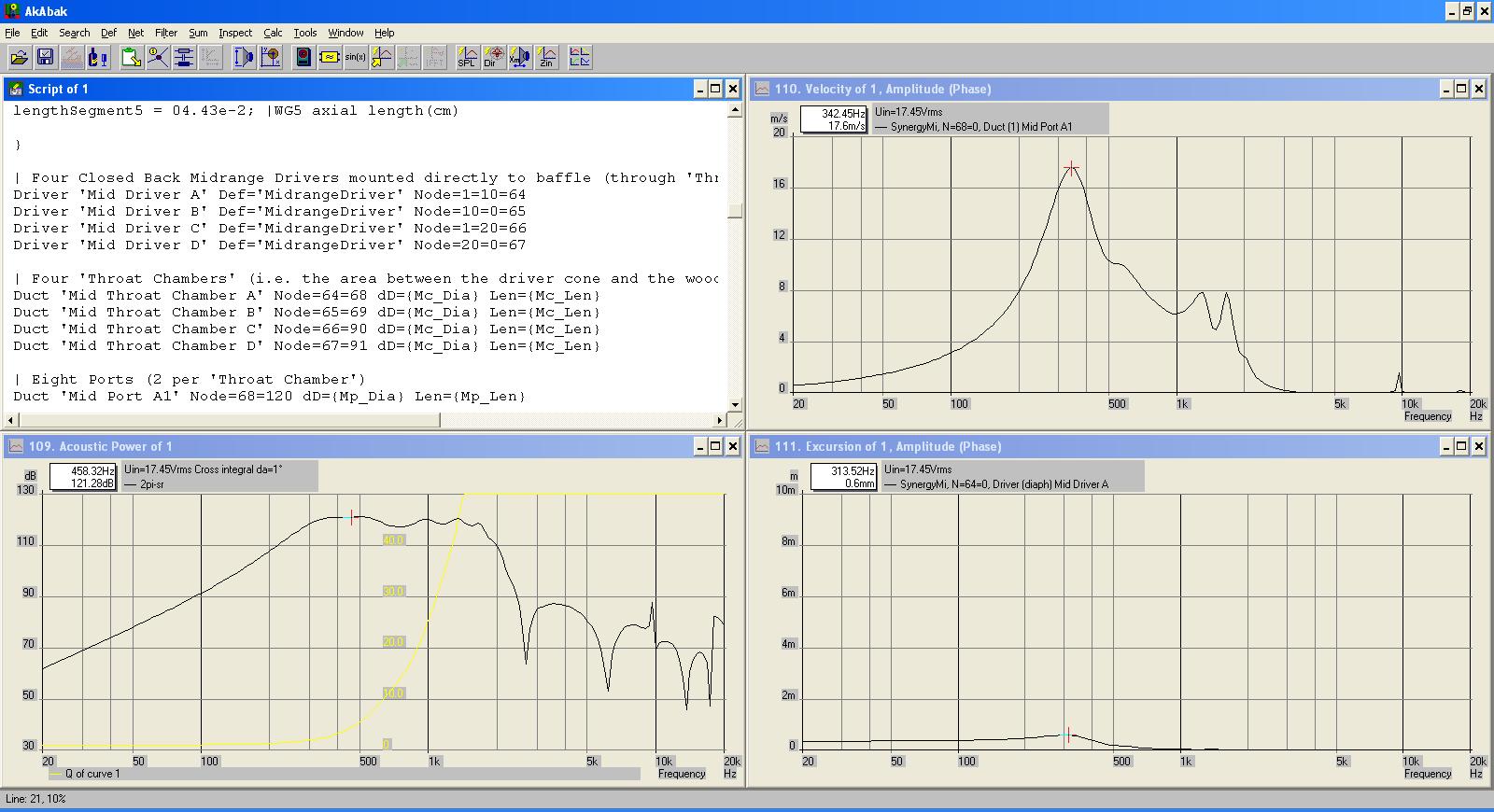

I have simulated my 60x60 horn again with the Celestion TF0410MR 4" closed back midrange drivers that Paul Spencer is organising a group buy for. You can see that the -3db point is just under 300Hz which is backed up by Paul's measurements. This has been modelled for maximum output at 120db which is basically just my target for dynamic range and to keep distortion extremely low. This does come at the expense of HF linearity due to larger input ports.
To achieve 120db I have had to use 2x 2cm ports per driver which achieves just over 17m/s port velocity. You can also see that the drivers are only moving a maximum of 0.6mm which should result in very low distortion at realistic levels. To achieve 120db in a 2 Parallel x 2 Series driver configuration only 54W is needed. Who is going to listen at 120db anyway?
Interestingly you can see the same 'twin peak' predicted response that keto has measured on the previous page of this thread. I guess that DSP is the DIY easy solution to the problem.

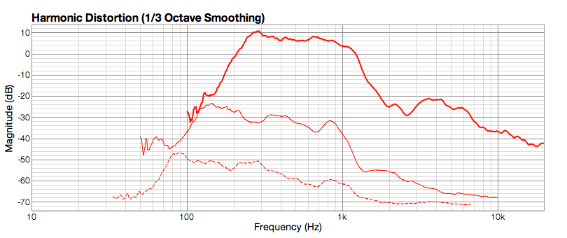

"Interestingly you can see the same 'twin peak' predicted response that keto has measured on the previous page of this thread. I guess that DSP is the DIY easy solution to the problem."
gi.mpl
The twin peaks are less at a distance (5 meters). I'm still very new at measuring, but I've been going for the magnitude graphs that correspond to the lowest harmonic distortion. Yesterday I measured outdoors but didn't realize that the little 2W amp was distorting until I'd brought all the gear inside, so all my plots are still in-room. Also, the measurements are made with the 2-ohm load (of 4 paralleled mids) on the amp's 4-ohm tap, which may be increasing the LF hump.
I don't have a good measurement of it here, but by placing a 1st-order line-level HP @ 300hz, that lower hump pretty much disappears. I'm going for minimal filtering (done inside each pass-band's tube amp, or at line level before the amp, or at the speaker-level) and no DSP.

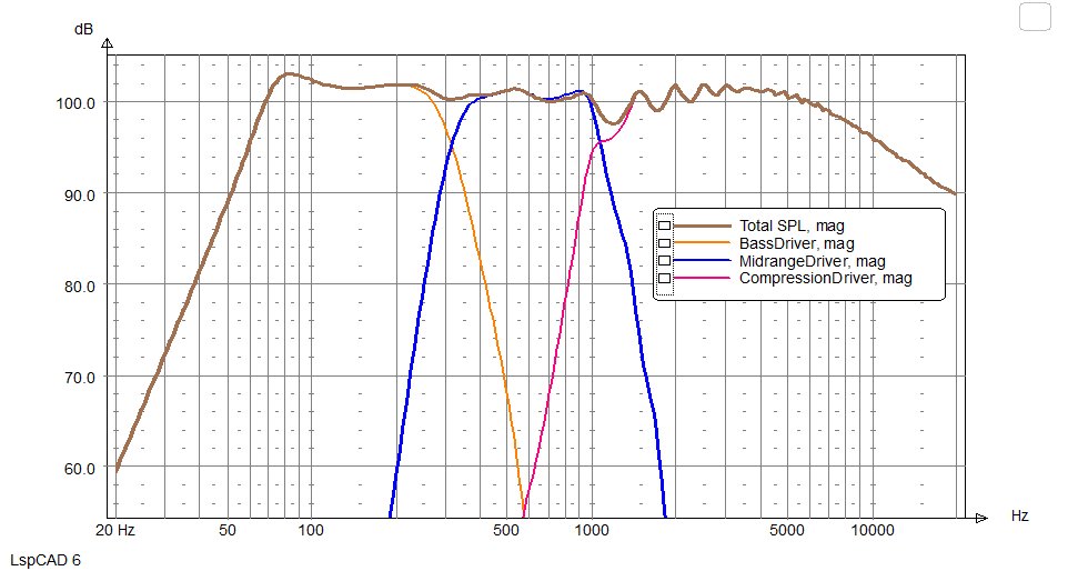

Thanks for your suggestion JLH I have incorporated that into the Synergy scripts.
The next problem that arises is the lack of T/S parameters on the BMS compression drivers' data sheets. The Synergy script has measurements for the BMS 4552ND compression driver but I have not been able to find anything for the BMS 4555. If anyone has these details (hopefully measured) are they able to post them?
For fun I had a play in LspCAD using the Behringer 2496 digital crossover filters. I have attached an image showing the output. These are only the simulated Akabak power response values and don't have any measurements so are just a theoretical approach to a Synergy horn. The transfer functions are at 300Hz and 1000Hz at 48db/octave. Potentially you could push the midrange a little bit higher (~1100-1200Hz) to help the compression driver but this is just measurement required speculation.
Mike

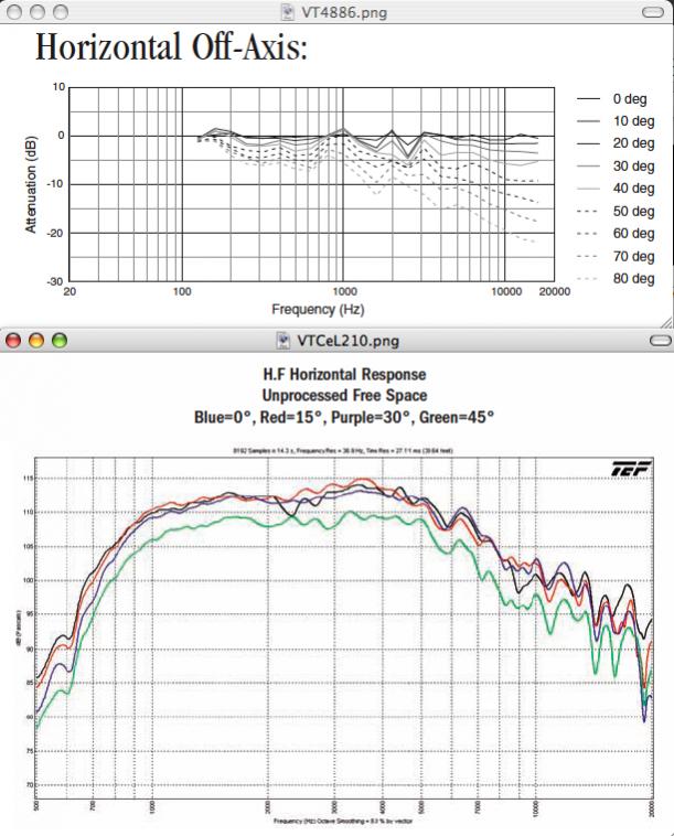

Here's the measurements. Seems like a promising design for hifi or home theater. It was heartening to see that many of the design choices I made in my small Unity horns were mirrored by JBL. (I've never seen this box until today - I came up with the idea of using 2" and 3" midranges along with small neo compression drivers without seeing this design.)
The earlier designs used a different shape for the waveguide; I'm a bit curious if the newer design is optimized to reduce interference from the compression drivers. The JBL literature notes that the waveguide and cabinet is designed to reduce diffraction, again a la Geddes.
Though the VT4886 has much better horizontal dispersion characteristics than the small format VLA series, it shares it’s design with the VT4889, 4888 and 4887, the VT 4886 is simply a shrunken version of the above marketed towards those that believe a line array is the solution to all audio needs.
The entire VT line is simply JBL’s answer to the L-Acoustics' V-DOSC line array from the early 1990s, they are nearly identical in design concept (using diffraction for HF dispersion) , not very similar to the Synergy horn design concepts.
JBL’s Precision Directivity series, and Renkus Heinz Co entrant horns are far more similar in concept to the Synergy/Unity horn than the VT series.
Because the VT886 is so small (only 22.8” wide), the wavelengths at the crossover points are almost (close but no cigar) short enough to constructively combine, so it has better midrange dispersion characteristics than its larger brethren.
Better is not that great, or very close to the even dispersion a Synergy style horn can afford, as is evident in the comparison of the VT 4886 horizontal dispersion to the VTC eL210 which uses a Paraline HF coupler and Synergy style mid porting on a straight sided (semi conical)horn.
The VTC eL210 has a uniform - 6dB 90 degree horizontal coverage pattern from below 500 Hz to 20K, the VT886 at 90 degree level varies about +1 dB to -7dB over the same range.
