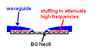

Probably would be a tough thing to tweak up, though, not many knobs (crossover components) to work with. But maybe with some EQ....
I'll bet you'll still have to eq it with some sort of network or active eq to get anything close to flat response due to the falling power response of the driver at high frequencies. You're really just replacing the electrical crossover with a mechanical / acoustical one which is way harder to tune especially since you currently have no model of it. I agree it would be cool if you can get it to work but I'd take the increased sensitivity and increased driver cost any day even for home use.
If the seal is airtight, (like a foam speaker surround) it will dampen the cone, changing it's parameters completely.Basically cut a ring of closed cell foam, epoxy it to the waveguide mouth, and then determine if it causes any kind of rubbing or buzzing. If not, it should seal off the cone 100% from the dust cap of the midrange driver.
Basically we've implemented a mechanical crossover; we've physically seperated the highs from the lows, instead of electrically.
If the seal is not airtight, it will buzz.
Hope you post some on and off axis response curves of what this looks like when you are done!

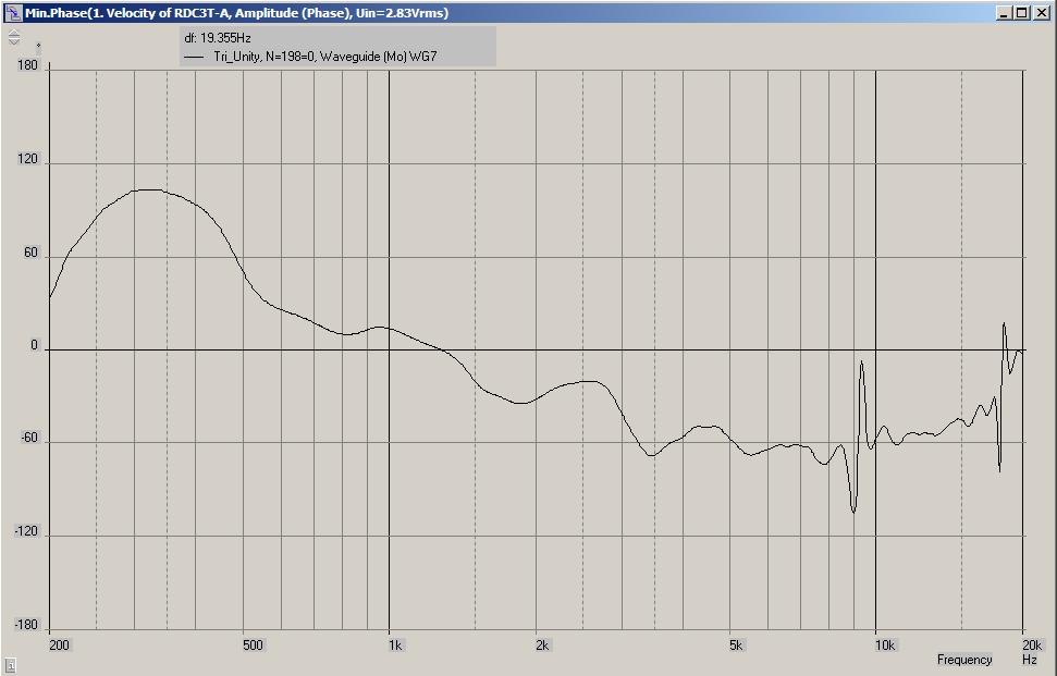

I keep coming back to the Misco RDC3T-A. It just works so damn well in a Unity. For the longest time I was fighting it because I couldn't get the thing to turn off in the high frequencies. This was messing up the frequency response of the compression driver and the overall phase response. Finally, I made a breakthrough in my Akabak script and found a rather simple solution. I ended up inserting a series resonance attenuation circuit across the RDC3T-As and it fixed it. It is a 3.3 ohm resistor, 14uF cap, and 0.15mH coil in series placed across the RDC3T-As which are wired for series parallel to maintain 8 ohms. A few more tweaks and I'll be satisfied enough to make a little bit more sawdust. Yeah, I know I'm slow as molasses, but that's the way I'm wired.

Since I couldn't get that Celestion 4", I went for the Misco RDC3T-A. It works damn well from what I've done with them so far. The best thing about them is that they were originally designed as a tweeter so once horn loaded they present a nearly resistive impedance. This makes it easier to use in a Synergy horn because you don't have to worry about its resonance screwing up the lower end frequency response. Its low end response is then purely controlled by the local area of expansion (i.e. local flare rate). I ordered a half case of them (30) and tested them all after breaking them in for 48 hours. Below are the overall average T/S parameters. The only way to come up with Vas was to use the sensitivity method with Smith & Larson Speaker Tester.

What do you guys think about building a faux-axial waveguide for the BG Neo8?
The high sensitivity, low distortion and extended response make it a great candidate.
