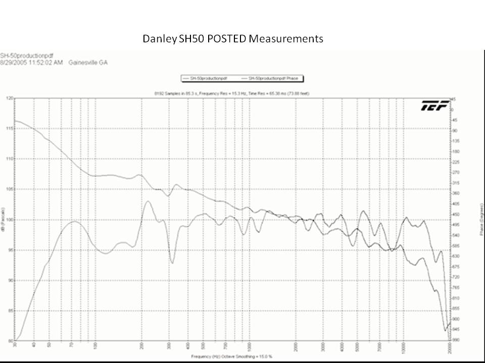

Danley's SH50 Synergy horn measures H=28", W=28", D=22.5". Big'ish.
Danley's SH50 Synergy horn specs +/- 3db of 50Hz and 18KHz, but the posted measured data does not totally support this.
Has anyone modeled or experimented with a H=36", W=36" D=?? 3-way 60x60 or 50x50 Synergy Horn that is optimized for 3-way performance? Perhaps with 4-woofers? What +/- 3db performance do you think is possible?
36" wavelength = 380 Hz

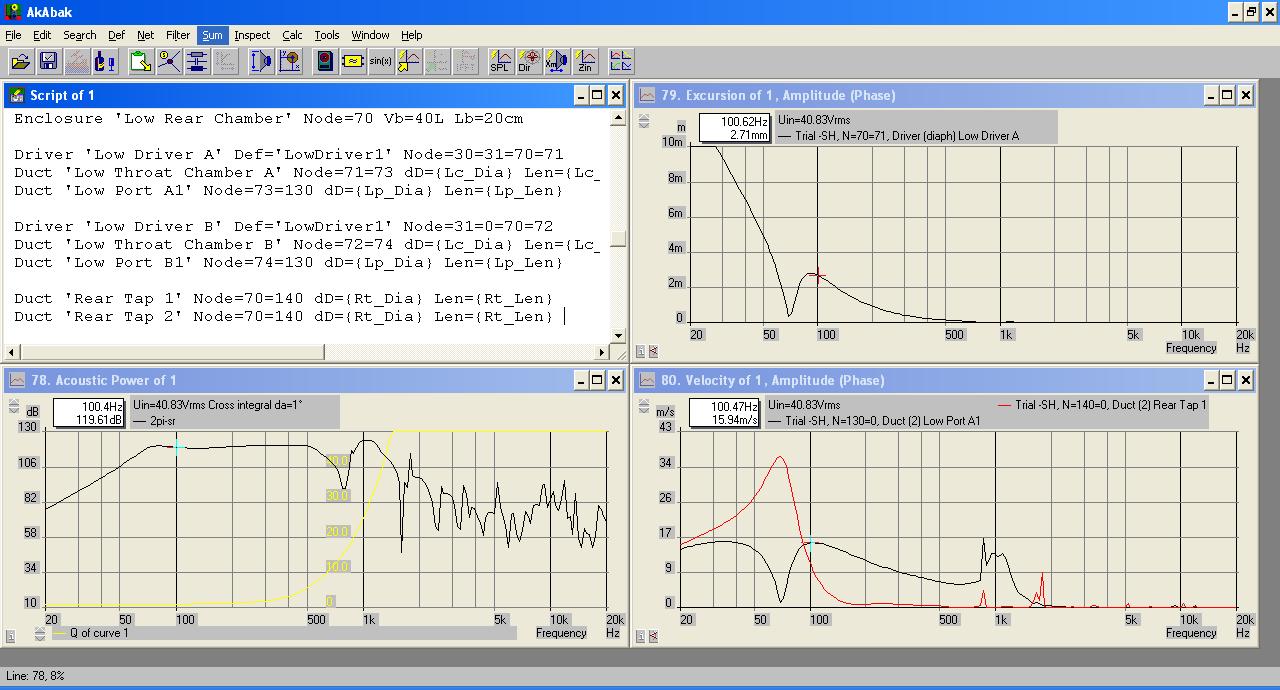

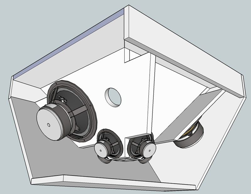

Hi LineSource,
I have modelled a 3-way 60x60 horn 27"x27" horn. I was only able to squeeze in 2x 10" drivers but really struggled to find a driver that would produce bass much below ~80-100Hz using a cabinet that must be quite similar to the SH50.
The real problem is that you start to run into air-velocity issues at high SPL if not careful. My modelling has been built for extreme dynamics even though I doubt I would ever actually hit much more than 110db in reality so potentially you could lower that maximum SPL for deeper bass extension.
The driver I have found that works best in these simulations is the 18 Sound 10W500 which also seems to be a bit tricky to find.
I am not very surprised at the response from the SH50 after playing with Akabak and would suggest a sub to sort out the bottom octaves like Paul Spencer is doing.

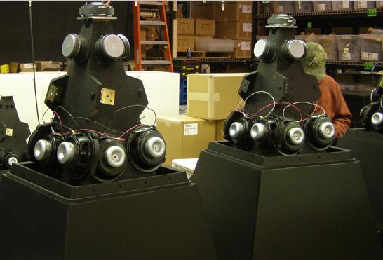

With the Danley Synergy horns the role of the woofers is a little different than most people think. In most of the Danley models the woofers take over from the mids at around 300Hz. They get horn loaded through entry ports just like the mids do from 300Hz down to about 135Hz. Depending on the model, 135Hz to 150Hz is all the mouth size will support for horn loading. Everything below the frequencies supported by horn loading is handled by bass reflex. In order to get the bass reflex section to match the sensitivity of the horn loaded section, the bass reflex is tuned up in frequency and made to peak in a narrow band. (When is the last time you’ve seen a pair of 12” woofers tuned to 80Hz?) So, you’re shooting for a very peaked reflex response to complement the horn loaded section. In normal life you would never design a bass reflex enclosure to behave this way because it would be a one note wonder. However, for the Synergy this is exactly what you need to extend the lower frequencies to exceed what is possible with the mouth size.
Translation?: This is a good engineering solution for pro use, but may not be ideal for home use.
Why not? If its phase coherent and the transient response behavior matches well, what's the problem?
And additionally the high sensitivity will give you really low power compression. I'd say it's definitely a good idea if you can get it tuned right.
They get horn loaded through entry ports just like the mids do from 300Hz down to about 135Hz. Everything below the frequencies supported by horn loading is handled by bass reflex. In order to get the bass reflex section to match the sensitivity of the horn loaded section, the bass reflex is tuned up in frequency and made to peak in a narrow band.
JLH,

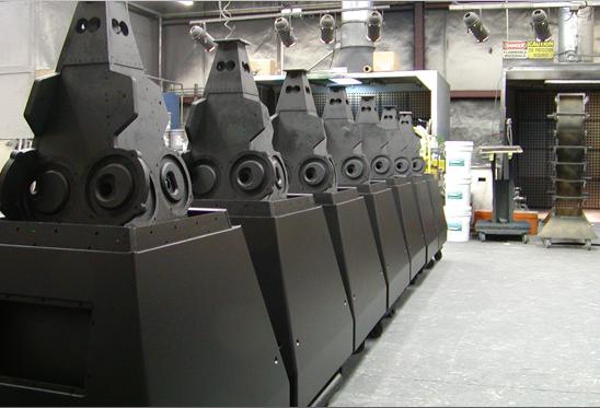

Thank you for the education. This explains why a 27"x 27" Synergy horn can claim a -3db of 50Hz, but why it is a poor home audio design. It also explains why Danley's REAL 3-way horns are HUGE(pics). The woofer routing on the attached pictures looks like some type of phase plug functionality.
So, a 3-way Synergy horn must be HUGE to obtain clean -3db near 80 Hz. A 36" x 36" Synergy horn would at best be able to cleany reach 105 Hz. It seems to require a 48" x 48" Synergy 3-way horn to be flat to 80Hz for the ultimate LEAD guitar jam box.
