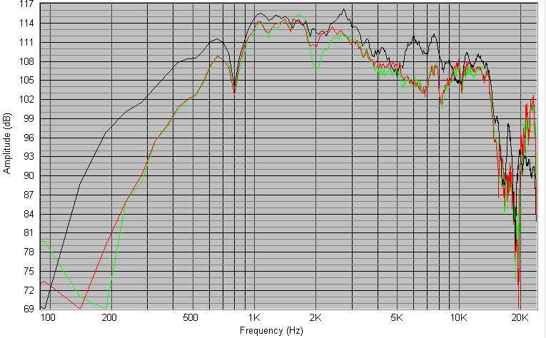

Here's a measurement versus matlab simulation from 2003 of my midranges:
I think this was with small midrange holes and 4x 5" MCM midranges, but it was so long ago I'm not 100% sure.
Here's a modification of the same horn a month later with larger midrange holes that worked better with the mids but messed up the compression driver's response more:

When doing my Paraline project, I measured absolutely no HF difference with or without the mid driver holes. Different animal though, removing the upper and lower horn wall also made no difference to HF response, much to my amazement at the time.
Do you have a small/large hole measurement of the HF response?

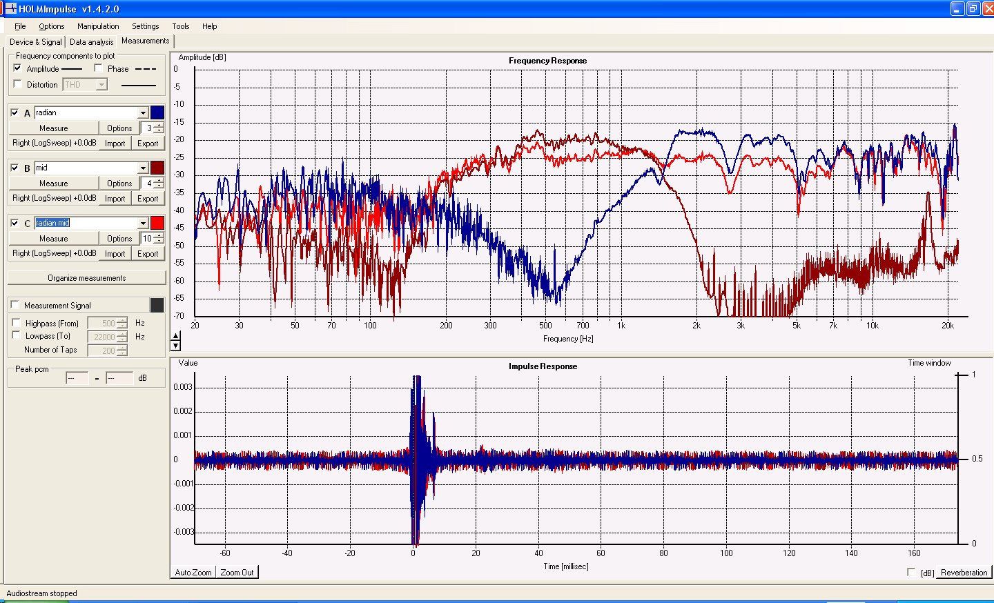

Here are a few more measurements. This is a TAD 2001 on the horn with small holes (very small - a single ~1/2" diameter hole only about 0.1" long for each mid with a larger hole going through the 3/4" wall to get to the short, small hole):

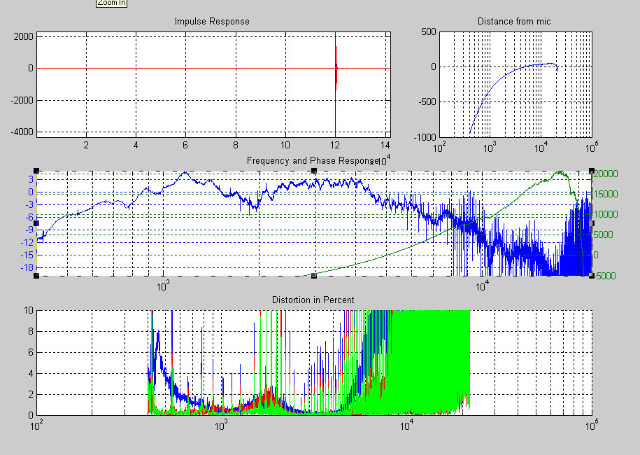

This is a completely unsmoothed response taken with a Farina sweep outdoors with the mic ~2m from the mouth of the horn. There are some dips in the response, but note that the response is pretty smooth between 2kHz and 10kHz (ignoring some of the noise at higher frequencies).
Here's a Radian 475 on the horn with the larger mid holes (holes are very large, like 2"x1" rectangular cutouts, 1 for each mid driver). These are outdoor measurements using a groundplane technique with the horn tilted forward so the mic is on-axis with the horn. I have before eq for the Radian and the mids and then the two combined after eq. Note all the dips in the tweeter's response.
Here's an additional plot of the above TAD vs the above radian on a different horn (a 500Hz tractrix, I think) (edit) to show that the Radian (red/green) is actually smoother than the TAD.
Basically the mids I had at the time did not work very well to get a flat response with small holes or medium holes. I did lots of simulations of geometries that were in between the two extremes I tried before I cut the holes out to make them bigger but couldn't find anything that looked good so I went for the extreme to validate my simulations. It did smooth the mid response out and bring the sensitivity up, but the tweeter got rougher.

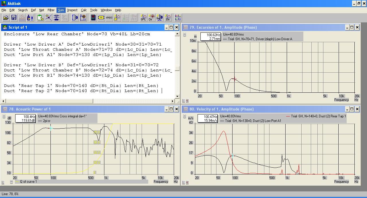

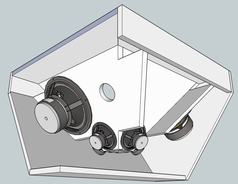

Hi everyone,

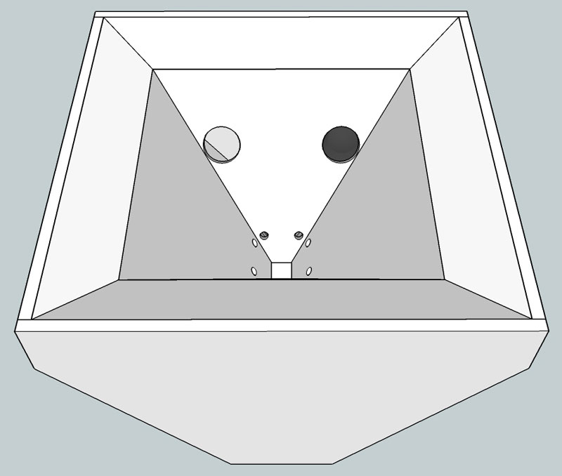

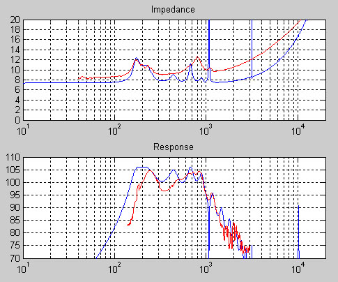

Since I last posted I have been playing with my Sketchup Model and Akabak.
I think once you look at Akabak you will quickly see that it is not nearly as intimidating as it first appears. Also maybe I was a bit quick to judge the interface which, albeit dated, is not too bad once you tile the windows (CTRL-Y: Simluate Again is your friend). If you have done even basic programming it will quickly make sense.
I have taken Sheldon's advice and offset the bass drivers enough to be able to fit 2x 10" drivers into the horn and have the input ports near/on the edge. I have modeled 2x 18 Sound 10W500 drivers trying to balance three things: reasonably flat acoustic power, low excursion (<5.5mm) and low port velocities (<17m/s).
To achieve a good balance of the three above I have had to adjust my design so that:
1. Only 2 ports per driver: 1 driver 'input' port and 1 bass 'tap' port.
2. 70mm Diameter of both ports.
3. Bass 'tap' port has to have a length of 100mm to tune the box to the correct frequency. I am not sure if Danley uses these?
Within these constraints you can achieve 120db output to 100Hz with ~20W:
1. 17m/s velocity target is met (~16m/s) assuming you put a high pass at 100Hz to limit port velocity at tuning frequency of ~80Hz.
2. Within 5.5mm Xmax (~2.8mm)
3. This is only one speaker of two so >120db is achievable.
I assume that Danely must be putting a high pass filter in his crossover to reduce high port velocities and cone excursion at low frequencies. This makes sense in a pro audio setting but in a realistic livingroom setup you could lower the highpass frequency and still comfortably hit >110db peaks. The DEQX helps here again as it can save multiple profiles with different high-pass settings. E.g. you could change to a higher high-pass frequency profile for action movies and lower high-pass frequency profile for more day-to-day listening levels.
If anyone is interested in any of these designs I recommend playing with Sketchup and Akabak and you will quickly start to see the design choices that Danley Sound Labs has had to make for their products. Very impressive engineering.
I just wish I could build these things sooner. To answer a previous question, I am not in Australia at the moment but rather in Zambia where I doubt even one CNC router exists.
Mike

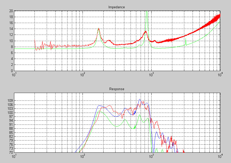

Hi, very nice, I have to give akabak a try. By the way, any idea what's causing the 800 hz dip in the mids? It seems to me it's a pretty deep one..
Hi SunRa,
There are no mids in this model as I have only put the bass drivers in. I am not sure of crossover frequency I will use but I suspect it would be in the 200-300Hz territory (which easily meets the wavelength/4 requirement) so the 800Hz dip is not relevant.
800Hz is 42.85cm but I cannot work out what that relates to. Hopefully someone with a better theoretical understanding can chime in.
BTW. I just realised my maths were bad with regard to power input to reach 120db. It should be much closer to 280W to reach 120db not 20W. Stupidity on my part.
Mike

Typically the first dip at the top end of the cone drivers' response is due to sound traveling from the cone drivers' entry holes to the throat of the horn, then returning (reflecting) to recombine with the sound exiting the horn. When the path traveled equals 1/2 wavelength, you get cancellation. Thus the closer to the throat you put the entry holes, the higher in frequency this notch moves. That's why using smaller midrange drivers would allow a higher crossover point to the compression driver. You encounter the same issue with midbass to midrange drivers if you turn it into a 3 way design.
For my build, I used nothing but Google Sketchup and a band saw.
Once I had the horn dimmensioned accurately in Sketchup, I "pulled it apart" and used the programs measurement tools to create cut sheets with the dimensions and miter angles. I drew each piece out on MDF with a ruler and square and then free-handed them on the band saw. It wasn't too tricky. Here's some pics of construction and my Sketchup file.
Expect a major update on my build this weekend.

A couple of questions for any Synergy Akabak guru's out there:
1. I have noticed in many of the Synergy scripts out there that people have added a small rear chamber to the script to cater for the closed back drivers. e.g.:
I am wondering if these should be included in the scripts given that the drivers' T/S parameters have already been measured with the effects of the rear chamber present.
Do you think this needs to be in the script? I assume not.
2. Regarding the wiring of multiple drivers (parallel/series). In HornResp this is easy as you can specify the number of Parallel and Series drivers (for example the wiring of the 4 midrange is 2 groups connected in parallel both containing two drivers in series).
How do you do this in Akabak as it is important to be able to determine power handling?
Thanks,
Mike
Code:
Enclosure 'Mid Rear Chamber A' Node=60 Vb=1.8L Lb=5cm
Thanks,
Mike
Hi Keto
Hey I found one of the old Lambda Unity horns in a pile of old stuff this weekend. We used the same wood parts back then but Nick filed his corners in with bondo (nice job too) but that made our version and his behave slightly differently. Since I base the crossovers on the measured responses, what I could help with, would not been much help with your horn.
As the horn you have is the one that Lambda supplied and I found one here, I can put a 4550 on the one I found and measure it and maybe help with a suggestion for a crossover.
Fwiw, the mid measurements look (to me) like they might be noise limited.
I don’t recognize the software off hand but I would suggest trying a couple things.
First, sequence based systems in spite of claims can be very susceptible to noise.
Noise intrusion can make sharp features like those between 100 and 200 Hz as well as sharp peaks in systems which cannot easily produce them (such as a system with an acoustic low pass filter). I would suggest a couple things;
Average a number of measurements until one can see a clean response to say -30dB down from the flat part on the low corner side.
A typical appearance for noise is to produce a deep notch below the low corner and then appears as free bass response. Do the measurement so that the mic to speaker distance is at least 1/3 of the distance to any reflection. Have the microphone far enough away from the speaker so that you are not in the mouth bubble (at least 3X to 5X the mouth size). What happens in front of a speaker is a little more complicated than assumed if one wants accurate measurements.
A view of that problem;
http://community.klipsch.com/forums/storage/3/550738/FarFieldCriteriaLdspkrBalloonData.pdf
Lastly, some smoothing is desirable as ones ears have a “critical bandwidth” which is approximately 1/5 or 1/6 octave wide thus 1/6 or 1/10 octave smoothing shows more than what you can hear under the best case.
Best,
Tom

Hi Tom,
Thanks a million.
I'm using an Earthworks M30, Fuzz Measure and MOTU Traveler via Firewire to a MacBook Pro.
Before I go outside to do the new measurements, here's my first shot of the BMS 4550.
--keto
Thanks a million.
--keto
It is a place holder. Mainly, for the use of open back drivers.Hi,
I am wondering if these should be included in the scripts given that the drivers' T/S parameters have already been measured with the effects of the rear chamber present.Code:Enclosure 'Mid Rear Chamber A' Node=60 Vb=1.8L Lb=5cm
With a factory closed back driver you can remove it, or make it infinity large.
In Akabak you do this by adding the correct number of drivers into the script, and then connecting their nodes together into whatever configuration you need.2. Regarding the wiring of multiple drivers (parallel/series). In HornResp this is easy as you can specify the number of Parallel and Series drivers (for example the wiring of the 4 midrange is 2 groups connected in parallel both containing two drivers in series).
Thanks,
Mike
Thanks,
Mike
The easiest way for me to figure out how to do series-parallel in Akabak was by doing a series-parallel wiring scheme in hornresp, then exporting it to Akabak
- Suitable midrange cone, for bandpass mid in Unity horn
