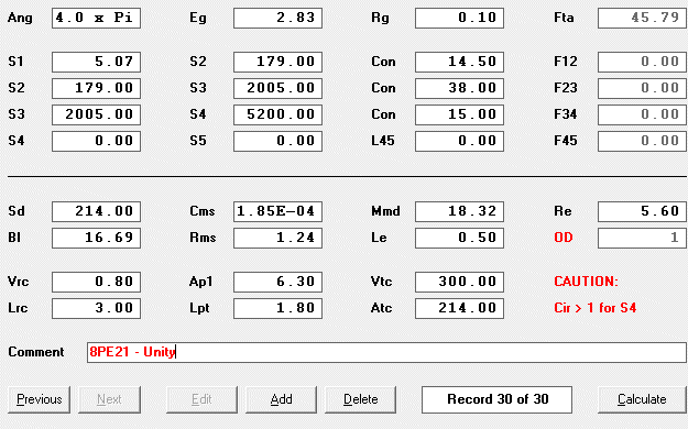

Update on fitting an 8PE21 to a unity. A 50 degree design seems to converge well, and could be built as 60 x 40. As shown is about as much low end as I can seem to get from it without a big size compromise. The SPL shown in Akabak is with the port velocity as also shown. I may be able to squeeze a few more dB out of it, more if the ports measure better than they sim. I'm not worried about the dip around 1kHz, but I'd just as soon not use Akabak for the crossover.
- Suitable midrange cone, for bandpass mid in Unity horn
