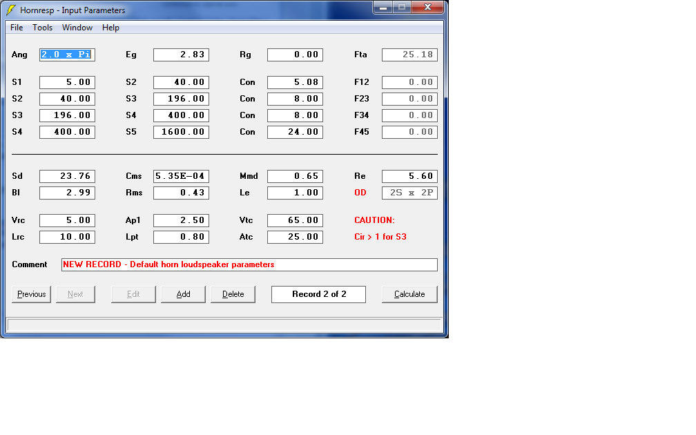

When modeling multiple drivers (2S 2P in this case), are ALL parameters interpreted as per driver? I'm specifically wondering about the volumes - Vrc / Vtc and Ap1 / Lpt.
Below is a very quick hack-together model mostly taken from P.B's model with the Goldwood tweeters here, Audio Psychosis • View topic - Under Dash Horn Alternative but with the driver params adjusted for the chamberless RS52 numbers from HTGuide. This actually models OK, but I'm not sure the volumes are right and/or make any sense - this is mostly since he has Ap1 == Sd, which doesn't fit my understanding of what Ap1 was supposed to be.

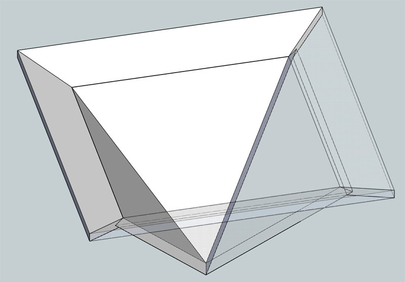

Hi guys,

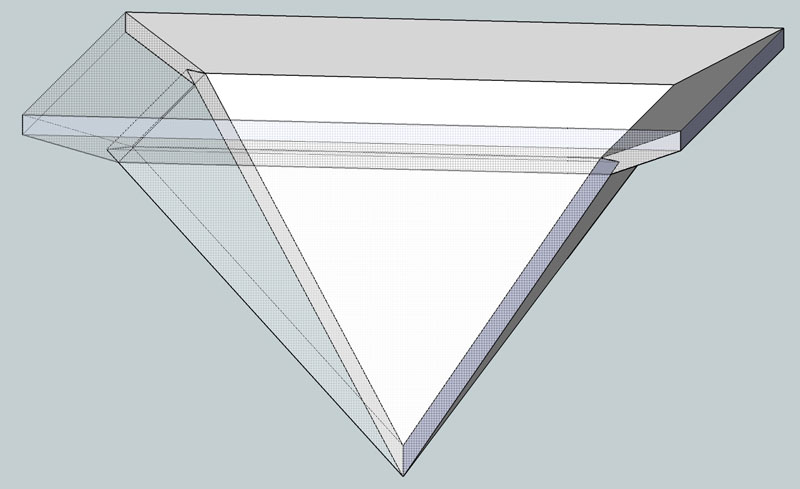

I have been playing with my 'basic trigonometry' in Excel and decided that, as warned by William and Paul, it is a unique kind of mind that can do this sort of design by maths alone.
Fortunately, through the power of modern computing, trigonometry practice can be largely thrown out the window in favour of CAD modeling (this does not mean you don't need to study it kids). It would be great if we could now just 3D Print it but the CNC route seems more appealing at least for the next few years.
I have made a model of a 60x60 horn that sits somewhere between a SH50 and SM60 design at ~62 liters.
Features:
1. 60x60 degree horn opening to somewhere around 65 degrees at the mouth.
2. Approx. 40cm height for the first horn segment (~2200cm2 area at the mouth)
3. Approx. 10cm height for the second horn segment (~4400cm2 area at the mouth).
4. Wall thickness 18mm.
I have attached a couple of images showing the horn.
Hopefully something like this can be used with 4x Celestion 4" closed back drivers and some bass drivers in the 10" range (somewhere between the SH50 and SM60).

Potentially answering my own question......looking at the exported Akabak script, it looks like the 4 drivers are in parallel between the single Vrc and the single Vtc, with a single port described by Ap1/Lpt from Vtc into the horn.
I'd need to double check my model, but that *sounds* correct. As I understand it, when you go from one woofer to multiple woofers in hornresp, you need to adjust the volume of the rear chamber (VRC) the volume of the throat chamber (VTC) and the volume of the port that's attached to the throat chamber.
In other words, just because you double the number of woofers, hornresp doesn't assume that you want to double the volume of the chamber in front of and behind the woofer. You have to do that yourself.
Hi Patrick,
Your understanding is correct.
The Vrc and Vtc values entered on the input parameters screen are the values used by Hornresp.
Kind regards,
David

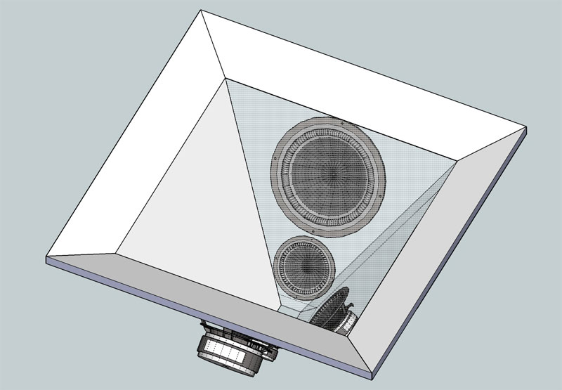

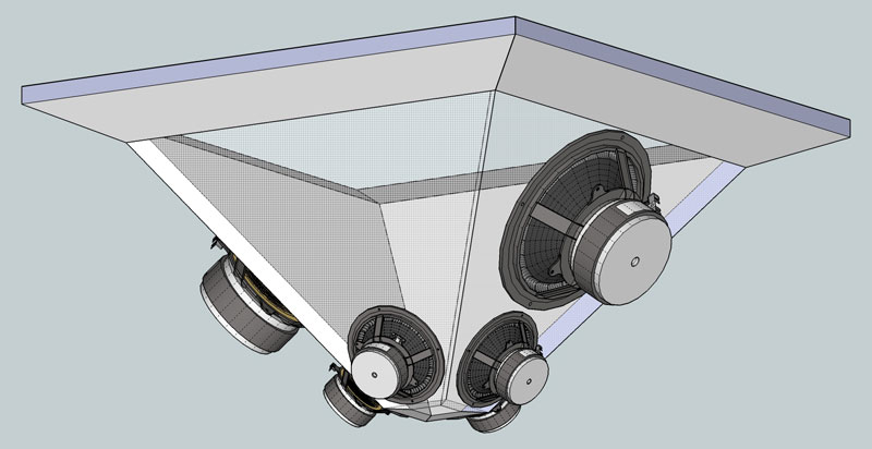

I have been playing with my CAD model further with the aim of finding where these drivers will port into the horn. The model helps a lot as it is easier to visualise where all the problems you didn't think about will raise their head.
For example, in the images below I have added virtual drivers (ignore the driver model but the sizes are correct) to my model with the design for:
1x BMS 4555 1.5" Compression driver (38mm diameter)
4x Celestion TF0410MR 4" (120mm diameter including frame)
2x B&C 8PS21 8" (225mm diameter including frame)
I have found that I cannot fit a 10" driver as hoped and an 8" only just fits (as the frame is actually 8.8" according to their specifications). The problem is that as you can see in the pictures because a woofer is round and I am using a 60 degree horn the driver ports will not be close enough to the corners and may interfere with the HF response. It may not be an issue based on some things that were said earlier in this thread - but I would really like to have a play with a prototype as Mr Danley suggested. It almost appears that one of those horrible car audio type 6x9 inch drivers would be ideal as it would be wide enough to reach the edge of the horn while not taking too much vertical space.

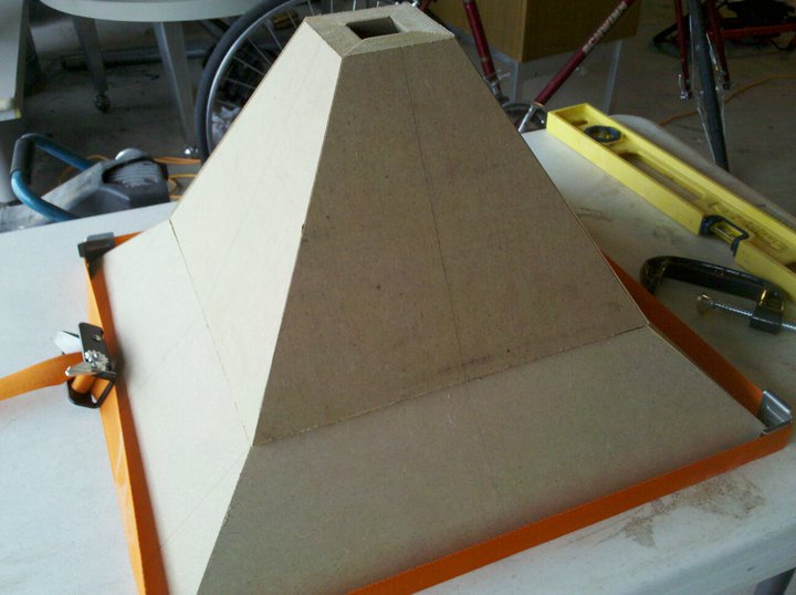

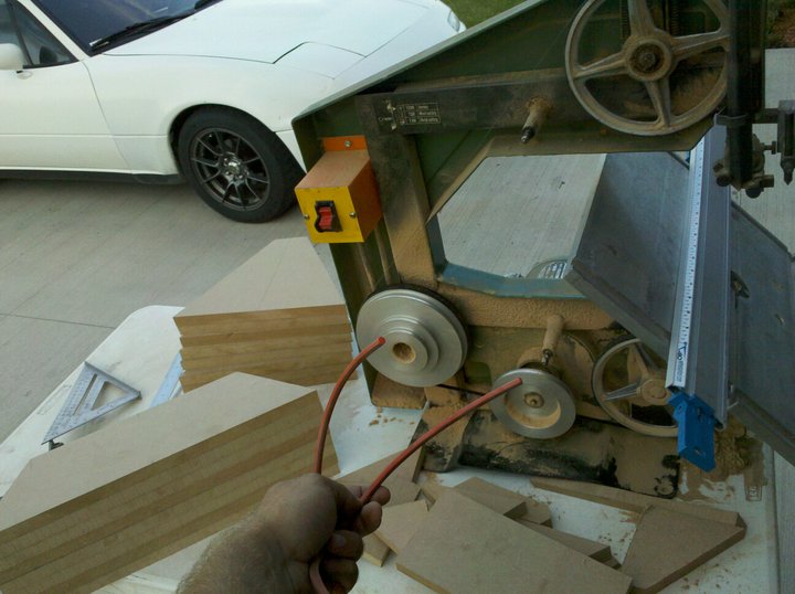

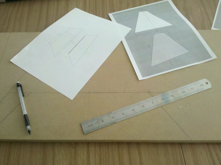

For my build, I used nothing but Google Sketchup and a band saw.
Once I had the horn dimmensioned accurately in Sketchup, I "pulled it apart" and used the programs measurement tools to create cut sheets with the dimensions and miter angles. I drew each piece out on MDF with a ruler and square and then free-handed them on the band saw. It wasn't too tricky. Here's some pics of construction and my Sketchup file.
Expect a major update on my build this weekend.
