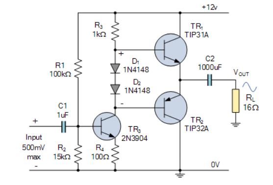

Suggestions for simple class AB with no global FB.
Adjustable output impedance from 1 to 70 ohm.

I don't think the goal is meant to design for 0.2% THD at 10W with 3 transistors.
0.2% for 1W into 8R is more realistic.

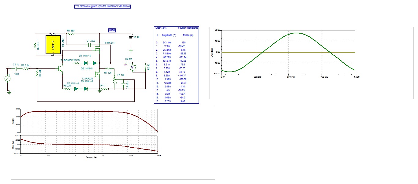

This is class A 3 transistors amplifier 36.6w 8ohms with 0.198% Dtot . A pair of IRFZ44 cost 1$.

Let me see if I figured out some part your circuit. The first transistor serves as a amplifier. The lm317 is a CCS. So a common emitter amplifier with a CCS at the collector results in a huge open loop gain. The 220uf provides a bootstrap that raises the voltage of the bias above positive The output drives the top transistor which is a voltage follower. The bottom part is actually a current sink that is dependent on the input voltage. As the input voltage swings positive the current sink increases the sink as the top part swings low. And you depend on one set or resistors to provide dc + AC feedback. The other is AC feedback. Gain is set very similar to how one sets the gain of an inverting op amp.
How am I doing so far?
