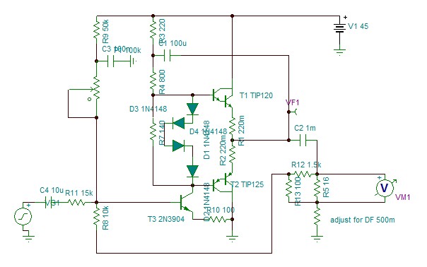

I suggest you consider using prepackaged Darlington transistors instead of using two discrete transistors. In your circuit, they are required to behave identically.

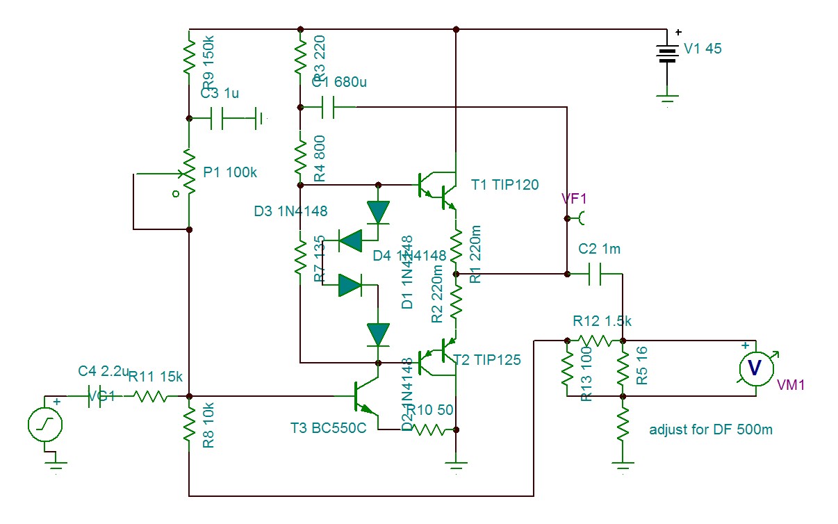

In the circuit you did, will need 5 diodes. Instead of 4 to push it into class AB. The resistor at the emitter of the power transistor. should be something like 1 or 2 ohms to have a bias current of a few hundred miliamps .
The bias seems a bit off. Seems the bias divider is about 5X but the DC gain seems like 10X. Is the output voltage about half of Vcc?
I would like to give your circuit a shot, as soon as I figure out how it works.
The bias with Darlington I adjusted about 120ma , with MOSFETS ,60ma. Emitter resistors are only for thermal stability.Hi,
The Intention is to have zero damping factor as he explains the need for his high efficiency speakers . In other words he needs trans Conductance amplifier.Does it qualify as "no global feedback" ?

I think zero damping factor is too much to ask for. That is basically current source amplifier. I have 2 already in class A. An F2J and a inductor based amp. Just looking to have something with a low damping factor. From what I understand, global feedback increases the damping significantly, hence I am avoiding there. The sound signature is also suppose to be different.

Depends on how you define "low" damping factor.
For example, Zout for post #39 is 0.09R.
But you can easily increase that to any desired value by adding emitter resistors.

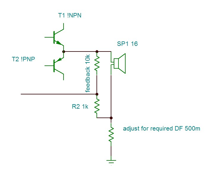

You can use global feedback to set the damping factor to whatever you want, total control. Feed back (a sample of) the output voltage for low output impedance = high damping factor, or feedback (a sample of) the output current for high output impedance = low damping factor.
Could even use a continuously variable pot to go from low to high damping factor.
Or use a series R at the output of a low output impedance amp ;-)

Post 2 repeatedYou try first a series resistor with your speaker driven with a standard amplifier to determine the required damping factor. The circuit you show has a relatively low output impedance, but adding a bootstrap you get near zero DF and higher gain . You can also apply negative current feedback on an "normal " amplifier to lower the DF.
