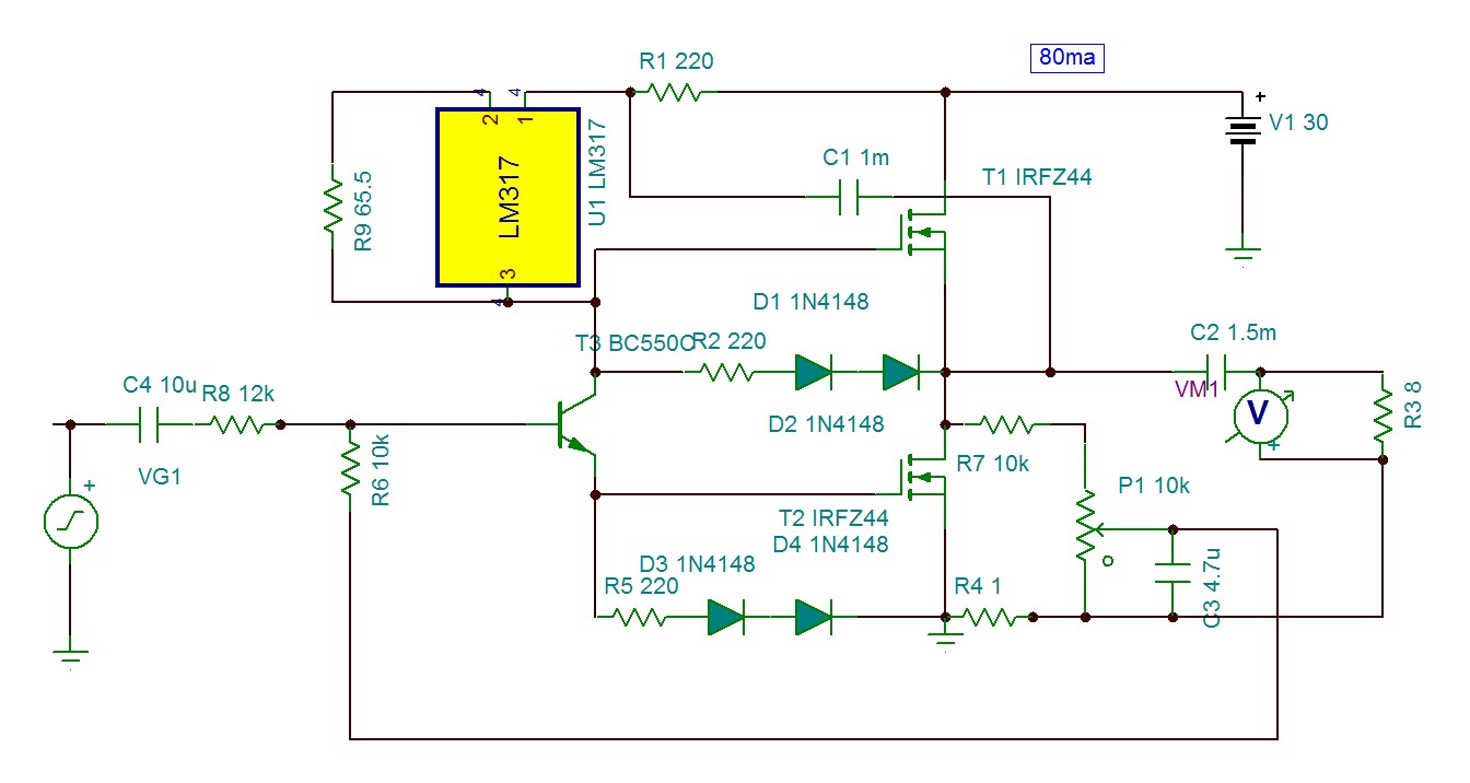

Just had a thought. What if I did the circuit as I described in my first post but used 3 diodes and at a resistor at the emitter to make it into an AB amplifier and use it in a bridge configuration ( 2amplifiers) with a bipolar cap in between, since it will be impossible to match the bias.Then build a simple one transistor phase splitter to create the out of phase signal. Do you think it would sound good?

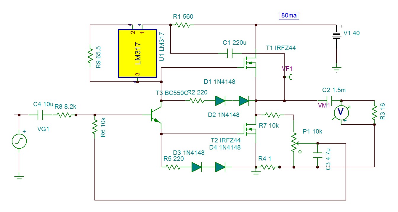

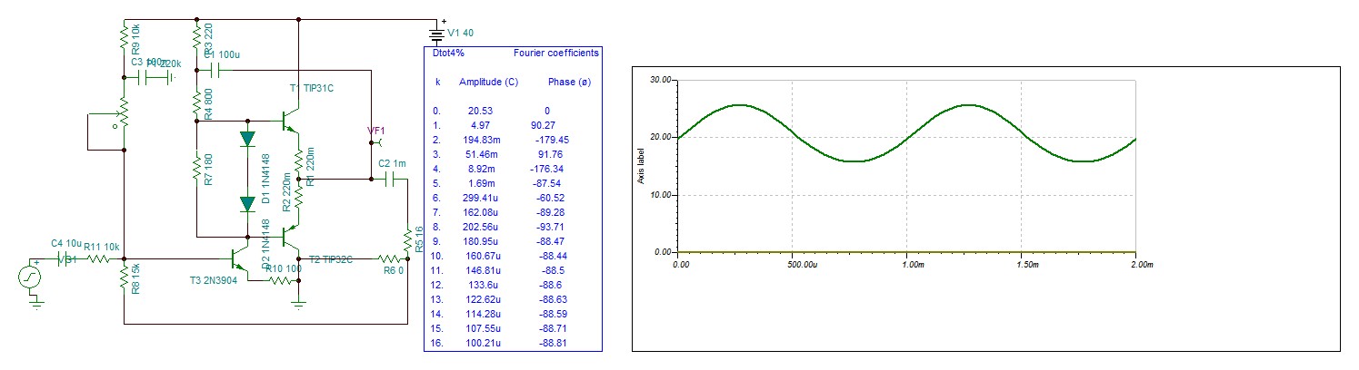

I simulated your circuit. The maximum output is 5V peak with 40v supply. 0.78w 4% Distortion.

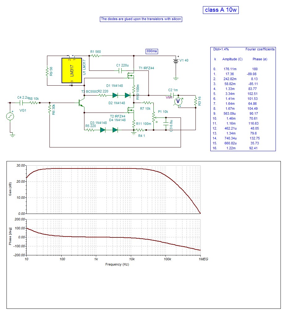

I cannot make better than the class AA on post 19 . You don't like it?
Hi,I simulated your circuit. The maximum output is 5V peak with 40v supply. 0.78w 4% Distortion.
On the contrary. I appreciate what you are doing. It is just that I cannot understand your circuit and how it works yet. So it becomes a big problem later when I try to optimise it or tune it. The problem with discrete circuits is you would need to understand how or else you will be in a really big mess when it is not working properly.
I think the simulation of the circuit i posted itself would yield very poor results. So it needs to be redesigned and optimised. I just copied from the internet to describe that kind of circuit. That design has insufficient bias. current from the driver. The moment the voltage start to swing too positive. The current through the resistor for driver becomes insufficient to drive the output transistor. The circuit will only work if the output transistor is replaced with a Darlington.

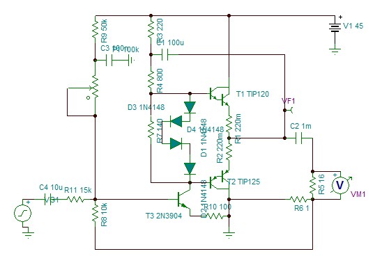

The circuit proposed in post #1 is essentially an input gain stage followed by a push-pull follower.
Output coupling is capacitive to allow for DC drift and single supply.
To have sufficiently low output impedance, the output devices need to be bipolar power transistors with little or no emitter degeneration.
Thermal run-away of the BJTs has to be taken care of in the biasing circuit (e.g. thermally coupled Vbe multiplier).
Since most power BJTs don't have hfe much higher than 100, Darlingtons or Sziklai's become unavoidable, practically.
Even then, the drivers need to have bias capable of > 20mA.
That in turn means that the gain stage should have a bias of ~5mA.
For 5~10W into 8R, you will need at least 24V for a single supply.
With 5mA bias, the collector (or drain) resistor should be ~2.4k.
For a gain of 10, the equivalent emitter (or source) resistance should be ~200R.
The attached spice file is nothing more than an illustration how it might be made to work.
But you will need to match hfe for Q2,Q4 & Q3,Q5.
And you need to have the right Idss for Q1 to get both the gain and the output DC where you want them to be.
So a bit fiddly, shall we say.
Q2~Q6 needs to be all thermally coupled, without saying.
And you will need to operate at rich Class A to get low distortion with no global feedback.
