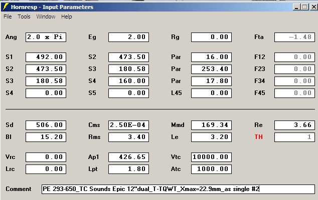

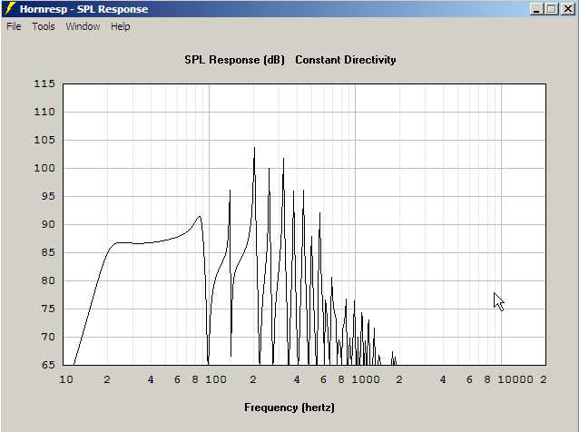

I don't want to sidetrack in this thread too much; but - when the back of the driver does not fit into the duct anymore - you can add a chamber around the back of the driver between the driver and the duct; e.g.: Vtc=10000[cm^3] - Atc=1000[cm^2] - Ap1=S2 - Lpt=1.80[cm]. You might also want to shorten L12 and L34 as you don't need to locate S2 and S3 between the two drivers anymore. At least in Hornresp that works out rather nicely.

Yes, but chambered and tapped - tapered quarter wave tube does have an interesting ring to it: CAT-TQWT (and pipe ...P, and horn ...H). The great thing about Hornresp and AkAbak is that the possible combinations are seemingly endless.
