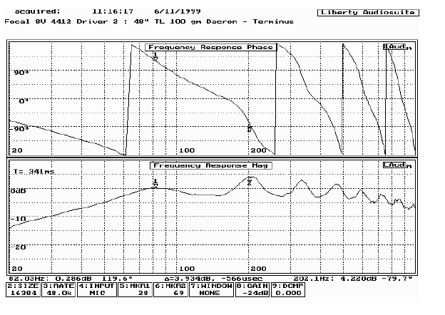

No, I don't. I go by bjorno's analysis using the Martin King MathCAD worksheets. My experiments with TL speakers were a long time ago, but I assume the stuffing to be of similar importance.
I can see damping definitely being useful for eliminating the periodic peaks when using a TL above the subwoofer range, or for eliminating a LF resonant peak that would be difficult (or expensive) to do using passive crossovers or filters.

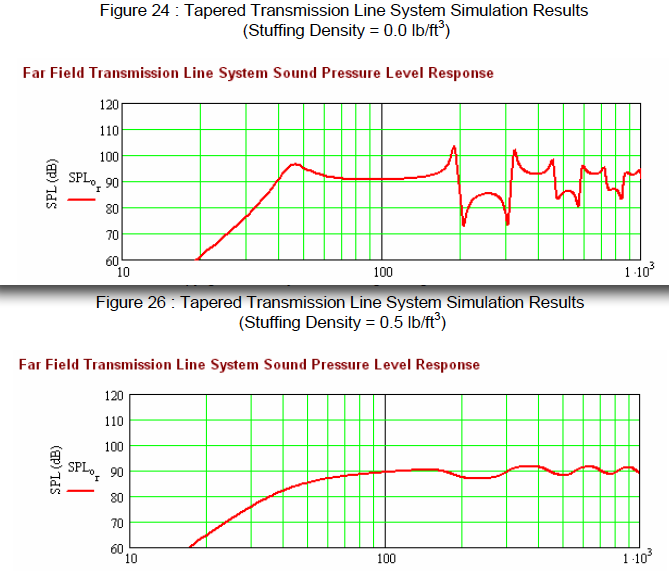

The stuffing described by Martin King reduces the LF response by anywhere from 2 to 6 dB, depending on the fill weight and frequency.
With DSP as cheap as it is, and driver , enclosure and space at a premium, it seems a waste to throw away half to 3/4 of the sub’s power into warming up polyfill.
The graphs below, from Martin’s work, make it obvious the huge amounts of power thrown away.
Thanks for pointing out Martin King’s work, very useful information.
My entire system uses active xover and equal at the preamp level if that helps any.
I would suggest correcting frequency response problems with your crossover slopes and EQ rather than throwing away the power into fill, take away 3-6 dB and you might as well use a much smaller sealed cabinet.My entire system uses active xover and equal at the preamp level if that helps any.
That said, a judicious placement of a small amount of fill could correct a specific peak without throwing away useful power.
I'll be experimenting with that myself shortly, have some drivers on their way, and a huge cabinet with some holes that need filling...

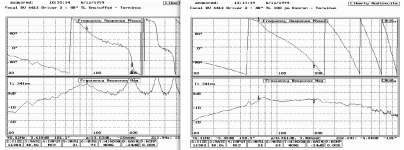

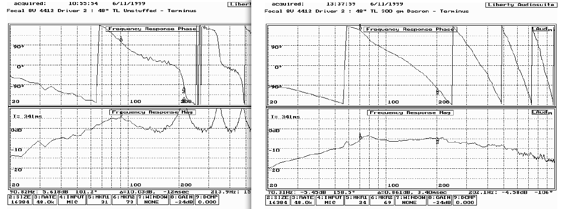

Yep...Adding lining or stuffing can dramatically cut efficiency if too much is used. For Pro audio or high output cabs, heavy use is a no go. Some amount used minimally can also make a large improvement in cleaning up cabinet resonances though. IMHO this is the best use of it. Large cabs always have resonances in the bass range due to the long dimensions involved and they can ring or honk and color the sound in a noticeable and bad way. A moderate amount of damping or stuffing can make a big improvement cleaning these up with only a very modest sacrifice in efficiency. Unfortunately really the only way to determine the right amount to use is through measurements and trial and error.
As usual YMMV.
As usual YMMV.
Yes, you are correct (5.680" [14.4cm]). I'll change the location of the dimension in the drawing.
Ok I will glue the other end at 5.68in (interior) later on this afternoon
"...the only way to determine the right amount to use is through measurements and trial and error."
That's why it is so important to get the removable access panels right.
I cut access panels on both sides of the box yesterday. I got a new rabbit bit for the router so I could make 1/2 inch lips.
Any recommendations on a mic that I can use for tuning the flattest response? Is this one a decent one to get? Dayton Audio OmniMic Precision Measurement System 390-790 I will use it for tuning everything, not just bass.
Looks like a decent system for a fair price, and the calibration availability is a great thing.Any recommendations on a mic that I can use for tuning the flattest response? Is this one a decent one to get? Dayton Audio OmniMic Precision Measurement System 390-790 I will use it for tuning everything, not just bass.
There are far cheaper mics available, but without calibration you don't really know if the mic is accurate- I spent weeks of frustration thinking my designs were anemic, only to find the mic response (on a $1500 test set ) was rolled off in the bottom end, 6 dB down at 35 Hz, 10 dB down at 20 Hz..
You would not have that problem with the above system.

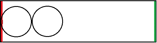

Hello, I have two questions this morning.
First question is, The center board (baffle?) is about 0.70 inches too short. The way this came about is I put a full 19 x 12.56 for the board that has the mouth/terminus. I will route the mouth with a follower bit for a perfect cut. The reason for this is because I did like the three inch gaps on each side, not a big deal and its easily fixed
The problem is, when I went to make the baffle 0.70 shorter I took it from the opposite end of the speaker.
The way it sits in the box the board is the correct size. What is not right the woofer holes are not all the way up against the corner. Instead they are 0.70" from the corner of the box.
Im not one to half way to anything and if this will affect the sound, i will gladly cut a new board to make it EXACT. I have not glued this board and whatever you decide will be done across all 4 boxes. Its easy to fix now.
So will this affect the sound?
Hi 2MuchRiceMakesMeSick,
"...the woofer holes are not all the way up against the corner. Instead they are 0.70" from the corner of the box."
I'm not sure that I get what you mean, there is a 0.742" gap between the frame of the woofer and S1 in the drawing. Moving the drivers 0.7" closer to the mouth-or further away-should not make an audible difference.
I'd agree, sounds like a filler piece should be glued in and some sealant applied and no one but us will know the difference.Hi 2MuchRiceMakesMeSick,
Please excuse my drawings, I am not an artist.
Your drawing called for this arrangement.
Instead my baffle looks like this.
When I went to make the side board (terminus) and made it all one peice I had to shorten it one board length so it maintained the 57.403 measurement. Instead of cutting the red from the board, i cut the green which moved the woofers 0.7 inches closer to the fold
