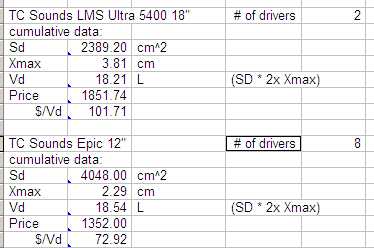

I'll attach a quick price v. displacement comparison:
Hi again,
I took a real rough run at it, and four T-TQWT boxes, each with two TC Sounds Epic 12", would fit into that space just nicely. They would be single fold, quite easy to build. 76" x 16" front face for the four.

That said, there are plenty of good sounding drivers that cost far less per displacement than the TC Sounds drivers, though there are few that have as much per driver.
Designing for extension below 30-35 Hz will cost dearly in SPL output, and is not needed unless cinema effects are a primary concern, so using drivers with a very low Fs (such as the LMS Ultra 5400 18") is not so useful for dance/PA use.

I wasn't talking about 4 x 12", I was talking about 4 enclosures with 2 drivers each, or roughly eight TC Sound Epic 12" :) in T-TQWT boxes. If you can't do structural damage with that, you're just not trying. I'll post a model later.

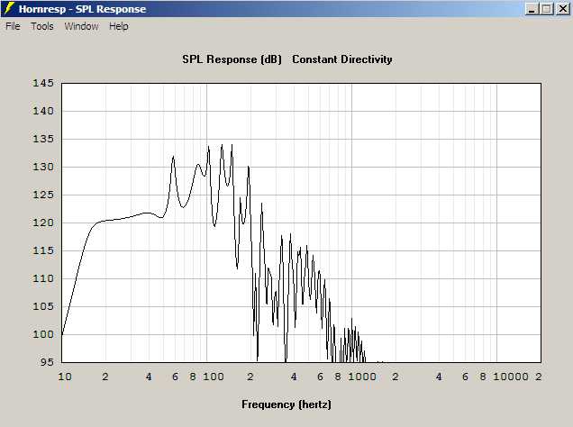

And the promised model of the dual 12" T-TQWT:
Regards

Thanks for the model. I really appreciate it! I am really looking into the 8-12's. Is there any way I can drop the height to 14" without affecting that design much?

Yes, that sound quite feasible. I haven't done a drawing on this one yet, but of the top of my head that would be a good height. You would be looking at a combined front face of 76"W x 14"H; the overall depth would be 80"D; the individual boxes would be 76/4 = 19"W.
I can see if I find the time to draw something up around those dimensions, if you are interested.
