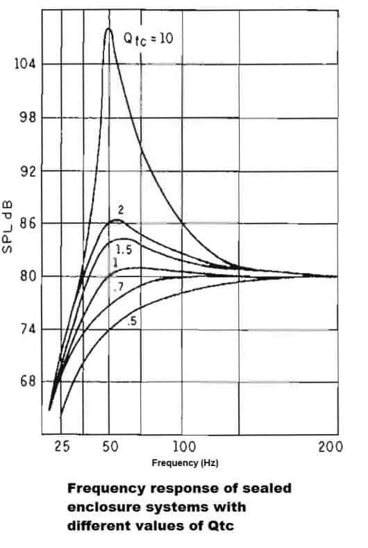

More mass = lower tuning = higher roll off corner frequency = lower Qt = more over-damped with increasing mass with a 0.5 (transient perfect) vented approximation the normal lower limit.

Didn't read this thread, but from the title - Qtc is the only factor which influence impulse response of the closed box loudspeaker, there are no other factors (not counting enclosure panel vibrations, internal resonances, etc.).
Vented/ported box loudspeaker is a different story...
Reactions: Freedom666
Ideally and mathematically yes, in reality the air (in a closed box), the driver (its cone, suspension, motor, etc.), the box itself can be highly non-linear so that it doesn't follow the ideal principle, and they can even add different types of distortions.
The air in the box is way more linear than driver's suspension and motor. Cone resonance and box resonance may disturb the "mathematical/theoretical" impulse response, but won't change the "tightness" of the closed box loudspeaker (OP title).
Cone, suspension and motor are nonlinear, but they don't influence the "tightness" of the closed box loudspeaker (OP title) - it remains dominated solely on Qtc.
