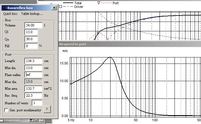

Taking 15-20m/s to be the limit for the speed of air in a port to minimise chuffing you need a port roughly 13cm in diameter this needs to be 134cm long to tune it correctly in the aforementioned box in philips other thread of 54 litres.

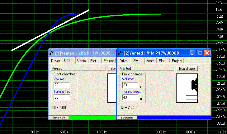

Wright said:but I can't figure out what factors really control the sound I'm hearing. I thought the 'punchiness' might be related to my room effected response but my speakers measure close to flat from 30 to 90 hz in room. Since both my old sub and my speakers were/are ported I'm not sure that's it either. Is it as simple as system Q (my sub was .7) or does the driver itself play a major factor in this? George
Classic driver design for sealed or reflex box usage indicates a
Q of 0.7 should be used sealed, and a reflex version would be
~ twice the box volume of the sealed version.
Personally I prefer overdamped reflex alignments to classically
flat. In the above case detune the port by ~ x 0.7, which
gives a response more suited to room gain, the white line
is ~ 6dB octave. Sealed volume for Q = 0.7 = 11.5L.
(Q of 23L sealed box = 0.55, 0.6 is a good maximum for reflex)
