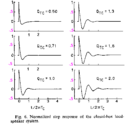

In addition to the previous link I gave, which had the response shape at various frequencies for various values of Qtc, here is the "step response" of variious values of Qtc, (and Qts in free air as well).
The "step response" means one square pulse, I believe with the wavelength of the frequency of resonance. Anyway, you can see how transient response and overhang are different for different values of Qtc.
The graph in the previous link I gave and this following graph will give you some idea of the tradeoffs between strong response and "overhand", "tightness", etc. I think you should have the whole picture now. It is up to the listener to decide between how much amplitude he wants versus how little distortion and "overhang".
Incidentally, the following graph is taken, with some minor additional graphic work, from the article "Closed-Box Loudspeaker Systems Part 1: Analysis" in the December 1972 issue of the Journal Of The Audio Enginneering Society. It was reprinted in their Loudspeaker Anthology Part 1. The author is Richard Small, of Thiele-Small reknown.

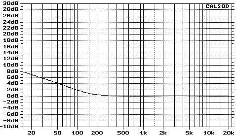

Most of the speaker designers from the sixties and seventies went for Qtc's between .7 and 1. But what Planet 10 is saying is indicative of a new wave of thinking, where the gradual rolloff splices into the room gain-the tendency of most rooms to emphasize lower bass frequencies.
With higher powered amps readily available and cheaper than in the sixties and seventies, plus with more low low frequency content existing on CD's now, perhaps the low Qtc path is the way to go. It's a matter of taste.
Below is a graph of typical "room gain". Some programs give higher values-Pyle Industries tech support gave me a higher number at 16 Hz than this chart indicates-9 dB as opposed to 7 dB-but it is all just an average anyway. Bass response will vary not only from room to room, but even in different spots in the same room.

Thanks a lot for the constructive replies guys. I have thought about this alot today.
Kelticwizard, that step response graph is very helpful, but also misleading. The horizontal scale is normalized with the time constant Tc on the denomenator. However, Tc is a function of Q. In particular Tc=Q/Wn, where Wn is the fixed 'break' frequency of the box. That means that the horizontal scale on each of the graphs is different.
To achieve a set of graphs that are directly comparable, the horizontal scale of each graph needs to be scaled inversely by the value of Q ie for Q=2 graph shrink the graph horizontally by a factor of two.
If someone with graphics knowledge could do this for all the graphs I would be greatly appreciative:D .

I could shrink the graphs horizontally inversely proportional to Qtc easy enough. There is a freeware program called XnView, as well as MS Paint.
Actually, I knew nothing of graphics until I started posting here. Almost all my knowledge of graphics comes from posting various pics and graphs here. That is why I love the board-I get to talk and learn about loudspeakers, and increase graphics knowledge at the same time.
However, I am still not sure that the graph is misleading. I am not quite following your explanation. This is not surprising, since advanced math-which I define as anything past 4th grade arithmetic-is not my strong suit.
Moreover, the article and graph are by Richard Small, truly one of the audio pioneers.
Be that as it may, if you want I can scan the entire article and Email it to you. If you are still convinced the graphs are misleading, I can scale the horizontal inversely proportionately to Qtc and post it here. Might be fun.
Incidentally, scaling things horizontally would not affect the amplitude of the "hangover", would it? I put the numbers next to the .5 and -.5 marks just so the viewer can see that at Qtc = 2, the overshoot is half as great as the original pulse amplitude. That would not change with scaling the horizontal, would it?

Hi Kelticwizard, Eric,
No changing the horizontal scale would not effect the amplitude. Each of the Small graphs that Kelticwizard has posted are normalized to generalize the horizontal axis. In this way you can scale the graph or not and the information presented by the graph is still valid. If you do scale one of the graphs and wish to compare your results with information from one of the other graphs in the set, you must scale the other graph exactly as you did the first.

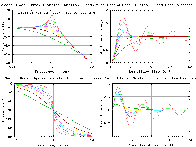

Sorry for the confusion everyone, but I messed up in my calculations. If anyone wants to know, the correct formula for converting between damping ratio Zeta (Z) and Q is Q=0.5/Z . Knowing this, I relabelled the step response graph:
Source is
http://gold.skku.ac.kr/tutor/gpdocs/multiplt.htm
Q=5 Q=2.5 Q=1.667 Q=1.25 Q=1.0 Q=0.707 Q=0.5 Q=0.25 [/B][/QUOTE]

This means that the original graph that Kelticwizard posted from Small's paper is 100% correct. Please ignore the scaled graph.
In summary:
Q=0.707 Fastest settling time, some overshoot
Q=0.5 Slightly slower settling time than Q=0.707, but less overshoot (better control of cone)
Q=1.0 Slightly slower settling time than Q=.5, significantly more overshoot, but more output at resonance and less distortion.
I think I'll try for Q=0.7-0.5. I wonder if most diyers realize how small the difference is between these two values of Q?

No, I was referring to the original Small setlling time graph earlier in the thread. The difference between both the settling time and cone overshoot of the Q=0.5 and Q=0.707 designs is very small.
However, the frequency response is different. The Q=0.5 box is 6db down at resonance, possibly matching better with room gain than the Q=.707 box, which is 3 dB down at the same frequency.
This was suggested by Dave earlier in the thread.
