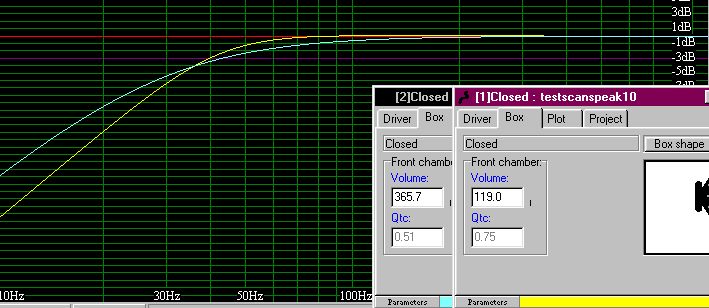

Keltic's graph showing the frequency response of woofers with different Q is actually quite deceptive. The problem is the X axis is F/Fb, not F. What that neglects is that Fb increases as you increase Q by making the box smaller.
Here's the real-world anechoic response of a Shiva driver as you make the box smaller to increase Q. Combine these response curves with the room gain below the lowest room mode, as Dave mentioned, and it's quite clear that boxes in the Q = .5 to .6 range will give the best in-room response.

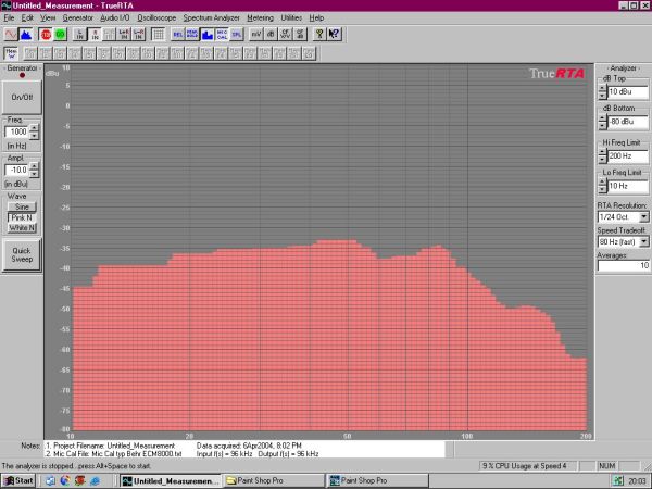

Since this seems to be about room gain/ Q stuff, I've attatched a couple pics.
Pic 1 is the 'winisd' prediction of my mains response, although in reality the Q will be lower as the cabs are well stuffed. I haven't measured these outside yet as it's too cold and too wet😀
Pic 2 is the response at seating position (pink noise run through the dcx x/o -crossed 24LR @ 80 Hz) No eq applied.
Cheers
Rob
Cheers
Rob

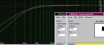

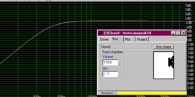

Well, yes and no. For one thing, Rob's listening room seems to give a nice, gradual, smooth boost of leading up +10 dB at 20 Hz. That is a great response-but every room might not have that.
Second, assuming your listening room is like Rob's, then the Qtc of .5 would appear to have advantages. However, the box size to achieve that Qtc of 0.5 is much larger than that to achieve 0.7. With Rob's woofer, the box necessary to achieve a Qtc of 0.5 is three times larger than the box size to achieve 0.7. Something to consider.
Of course, if you select a very low Qts woofer to begin with-such as the Peerless XLS series with it's Qts under 0.2-then the box size to achieve a final Qtc of 0.5 in the box will not be too large.
One more thing to bring up in favor of a low Qts woofer. From what I can gather, for two speakers with identical Vas and Fs, (these are out-of-box, free air measurements), the speaker with the lower Qts will be more sensitive. It will require a bigger magnet to achieve that, but the point is, with equal Vas and equal Fs, the lower Qts speaker will give you higher SPL's per watt in the midband.
So assuming your room has a response like Rob's, your speaker will be putting out higher SPL's per watt if you start out with a low Qts speaker to begin with.

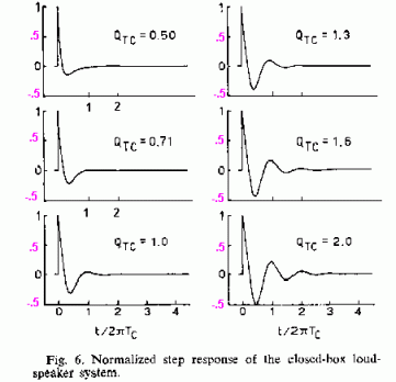

Putting aside in-room responsed for the omement, here are two charts for the step response of sealed and ported box alignments. Both are taken from Richard Small's articles. This will give some idea of the comparison of the two different systems.
First, the closed box chart.

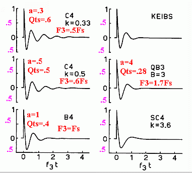

Next, here are the vented box charts. For reference, a, or a , equals Vas/Vb. It is used in many speaker formulas. So if you see a formula where a =3, then you know that the speaker is in a box that is one third the size of the speaker's Vas. If a =2, then the speaker is in a box half it's Vas.
The red printing is added by me, to try to make some sense out of the numbers in Small's chart in relation to the Thiele-Small parameters. I could not figure out all the alignments, so some are blank.
For just about all practical setups, the ported box alignments have more "overshoot" than for all practical closed box setups. However, some ported box setups can begin to approach some closed box setups.
As you can see, the trend is for tighter bass the smaller that Vb is in relation to Vas. Of necessity, the smaller that Vb is in relaton to Vas, the higher F3 will be in relation to Fs.
So in a certain sense, the more bass extension you sacrifice, the tighter the ported box response becomes.
