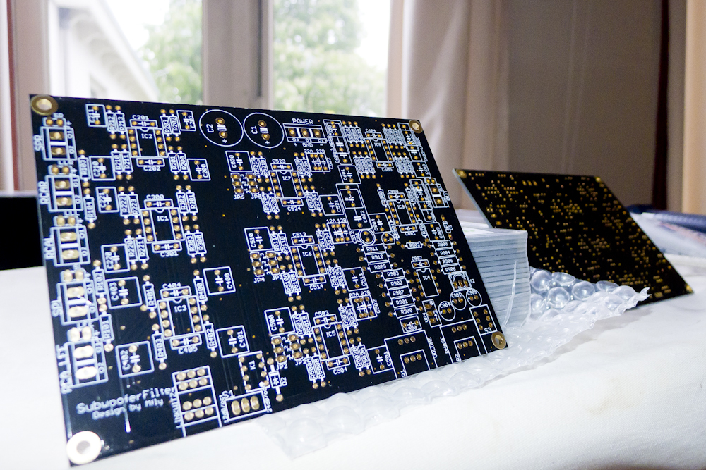

Nice work!What is the size of the board?
Thank you, you're welcome. The board is 140x100mm

Boards are in transit, currently in Germany and due to arrive at my doorstep somewhere tomorrow! I'll keep you guys posted.
Labeled all the envelopes and bringing them to the post office tomorrow. For all non European countries I put a customs label on there to (hopefully) prevent any customs issues.

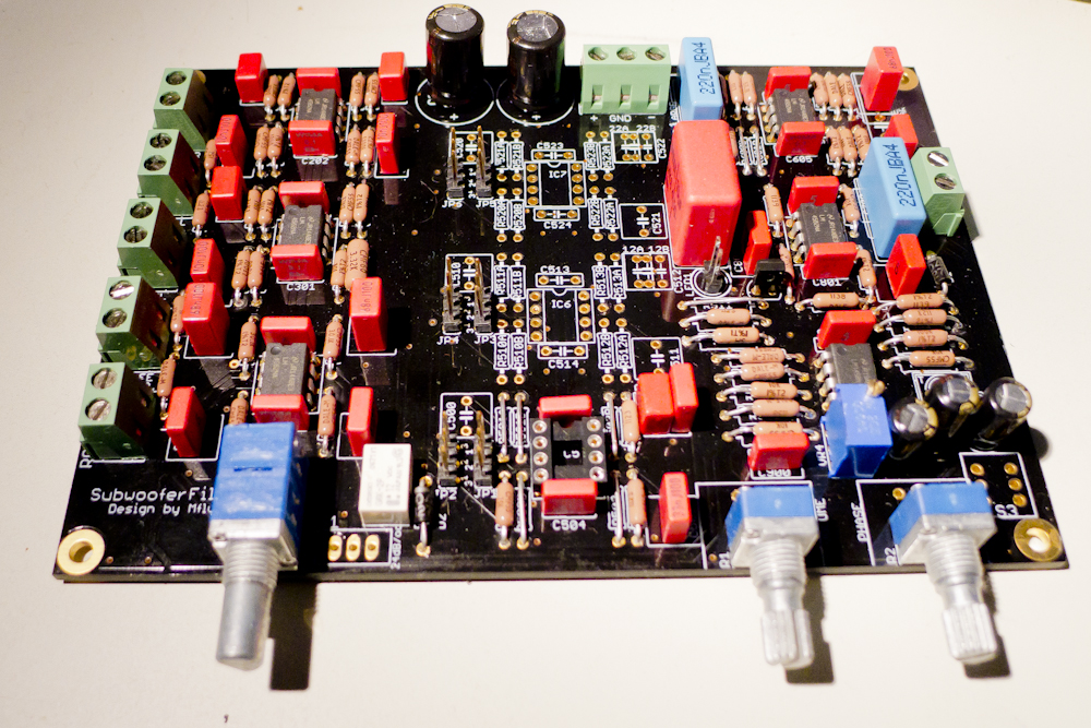

Also found the time to do some soldering. Haven't connected anything or tested it yet, but it gives an idea of what a populated board will look like:
