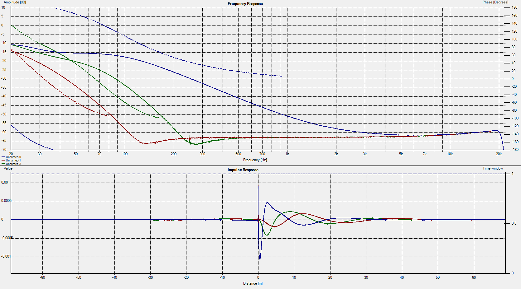

Drove some signals through te board yesterday, that part of the board seems to be working as advertised (frequency control, 12/24 dB switch, phase switch, phase control):
I haven't got the LFE circuit working yet though. Have to check the components. It worked on breadboard, so don't see any reason why it shouldn't work now. Keep you posted.
