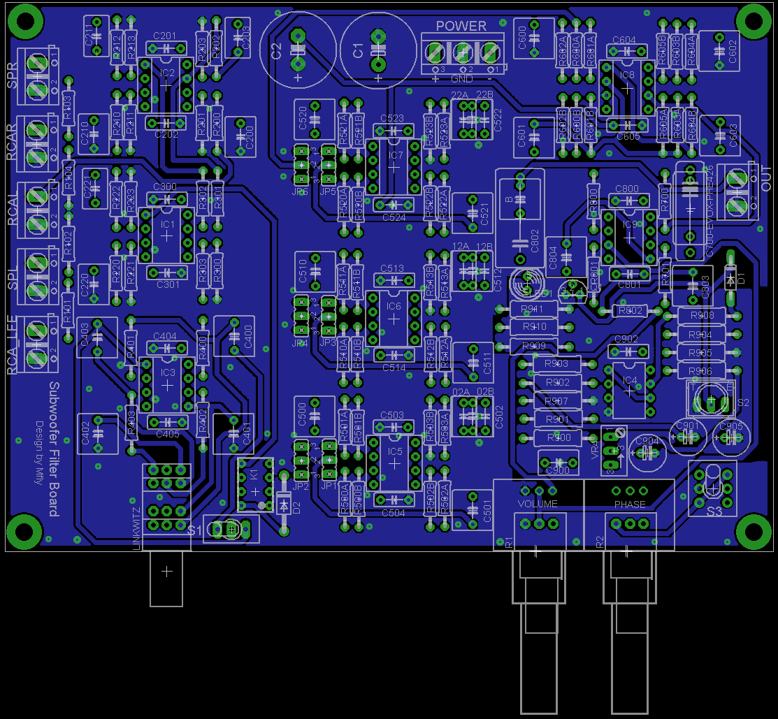

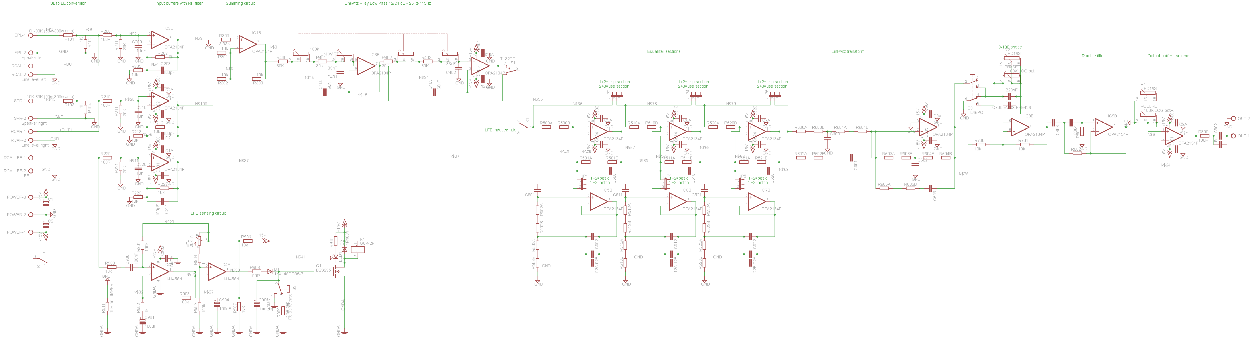

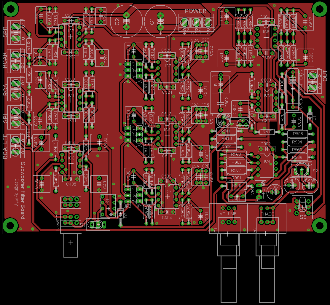

Here's the latest (and probably final) schematic and board:
Schematic:
Board top layer:
Board bottom layer:

Here's the LTSpice model again, now including input buffers (input buffers are +6dB for better noise performance):
View attachment buffer+summing+LR4th+Notch+LTransform+allpass+volbuf.asc
Update log:
-Ground pours in both layers
-Many ground via's for low impedance coupling of both ground layers
-Separate ground for sensing circuit (ties to ground via jumper or resistor (R911)
-Larger mounting pads (so you can actually fit your screw in there without touching any components)
-Replaced the phase switch with a smaller form factor (is off board anyway and the previous mounting holes were a bit large)
-Replaced all <90 degrees trace connections with ones that are 90 degrees or larger

Are the potentiometers connected the wrong way input/output or is it just me?😀
I think it's just you 😉 (except for the phase pot, which is debatable) 😎.
Some were connected the wrong way but in my latest post they are now connected correctly I believe, bear with me.:
In Eagle the board view is from the top (component side):
-The Linkwitz lowpass filter (left pot on the PCB): when the pot is in the left most position ('0'), resistance between the middle and the right leg (as seen in the PCB pictures, looking from the front side) is highest. In this case total resistance (including the 30k resistors) is 130kOhm. With a C of 33nF this results in X-over frequency of ~26Hz. When turning the pot to the right, resistance decreases to 30kOhm (only the resistance of the resistor, pot = 0 Ohm). With a resistance of 30kOhm, the X-over frequency is 113Hz. So turning the pot clockwise results in an increasing X-over frequency.
-The volume pot works as a standard voltage divider: the left leg is connected to ground, the middle leg is signal out (going to the + input of the output buffer, pin3 of IC9), the right leg is signal in (coming from rumble filter pin 7 of IC9). In the left most position, resistance between the left leg (ground) and the middle leg (out) is 0 Ohm, and the resistance between the middle leg (out) and the right leg is 100kOhm. This results in maximum attenuation. When turning the pot fully to the right, resistance between input (right leg) and output (middle leg) decreases to 0 and resistance between output and ground is at it's maximum. So turning the knob clockwise results in an increase in volume.
-Finally the phase: middle pin and right pin are connected. So turned to the left resistance is 0 Ohm. Let's take an arbitrary crossover point of 40Hz. When modeling the Phase in LTSpice this result in 80 degrees at the crossover point. To the right resistance is 100kOhm resulting in a phase of -80 degrees at the crossover point (range of 160 degrees). When switching the phase switch, pot in the left position results in -100 degrees at 40Hz turning it fully to the right: -260 degrees. So you have a total range of 320 degrees (full 180 is already sufficient). But for phase, it doesn't really matter where you start and how the pot turns. You could argue that with a centered pot, turning to the left decreases the phase and to the right increases it. Personal preference I think. Anybody suggestions / preference / 'correct way'?
Please check if my reasoning for the low pass and volume is correct.
