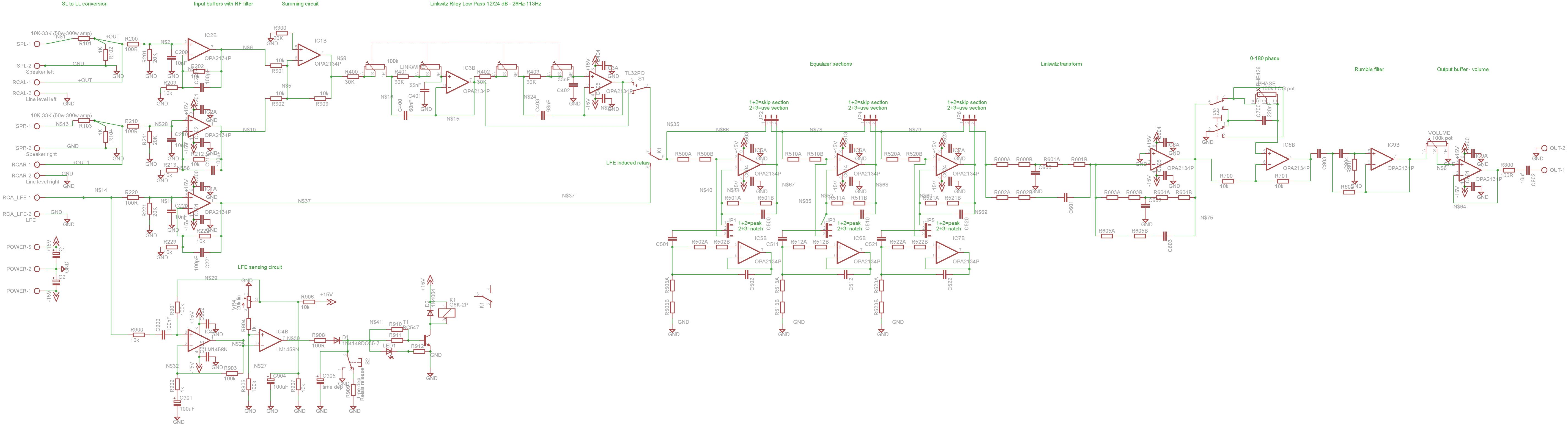

The new schematic. Changes:
-full phase switch (for > 180 degrees control)
-rumble filter

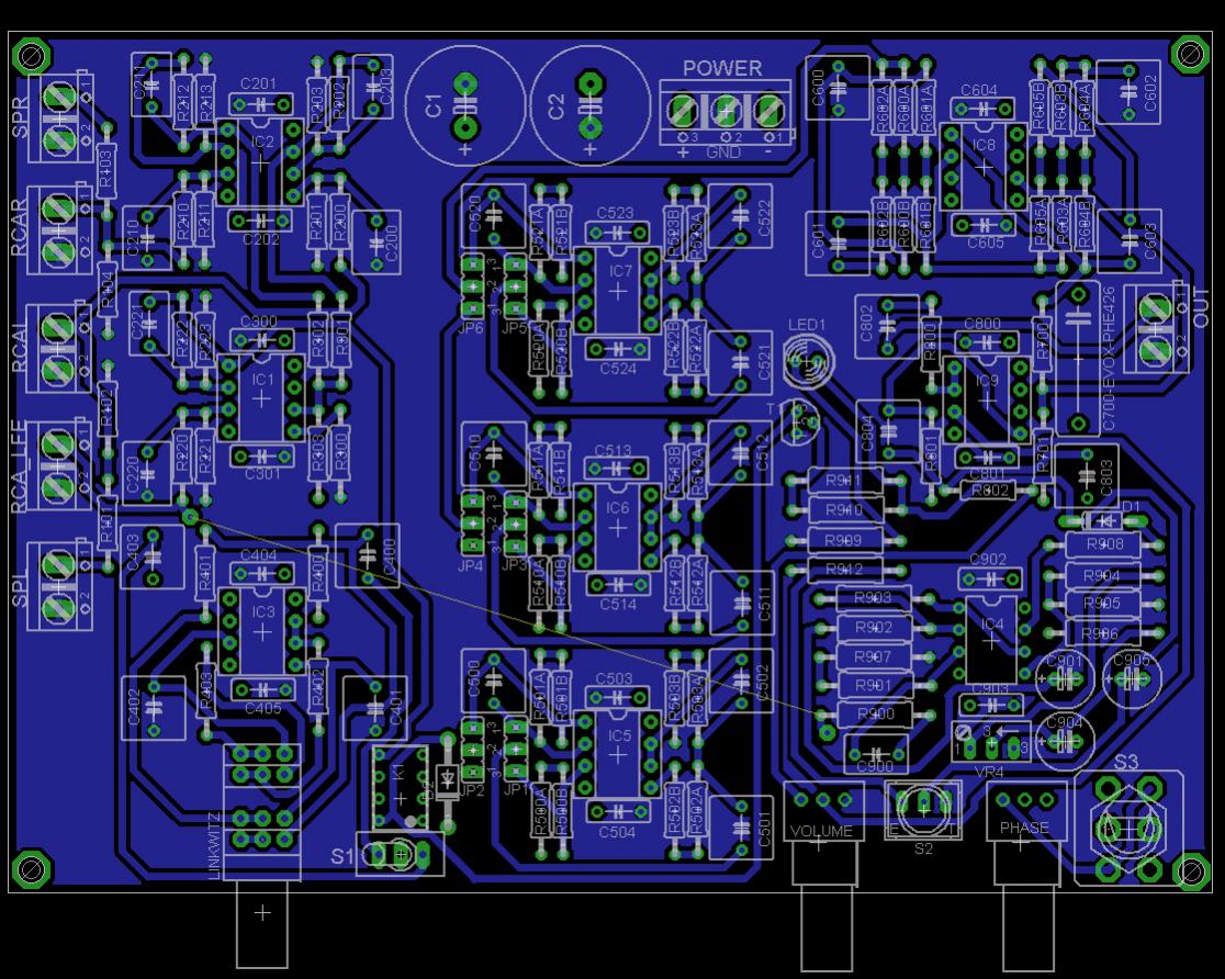

New top layer:
New bottom layer:

There are 2 spreadsheets in the zipfile, one is called 'Linkwitz Transform Calculator', this is a handy little tool I found to calculate the possibilities for the Linkwitz Transform section. This includes effect of the rumble filter, needed power, Xmax, and so on (credit to Mr. Linkwitz and mr. John L. Murphy).
The other is called 'Active Filter Four'. The sheet 'Notch and boost EQ' contain 2 different tools for calculating the equalizer sections (credit to mr. Bob Ellis).
Then there is the LFE sensing circuit. This is a design by mr. Rod Elliot, for a full explanation of the circuit, including values for timing:
Signal Detecting Auto Power-On Unit
Any other changes you would like to implement (range of the low pass section or range of the phase section), there are several tools easily found on the internet. I maybe have a LTspice model somewhere for the phase section. Let me know if I need to look it up.
I am still thinking about a solution to do the power supply lines all from the top part of the board, but haven't thought of something satisfying yet. If I think of something soon I'll let you know. Otherwise I'll go with this design (if any of you don't find any errors..)

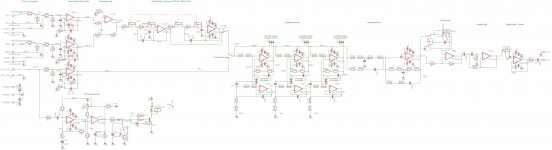

-rumble filter

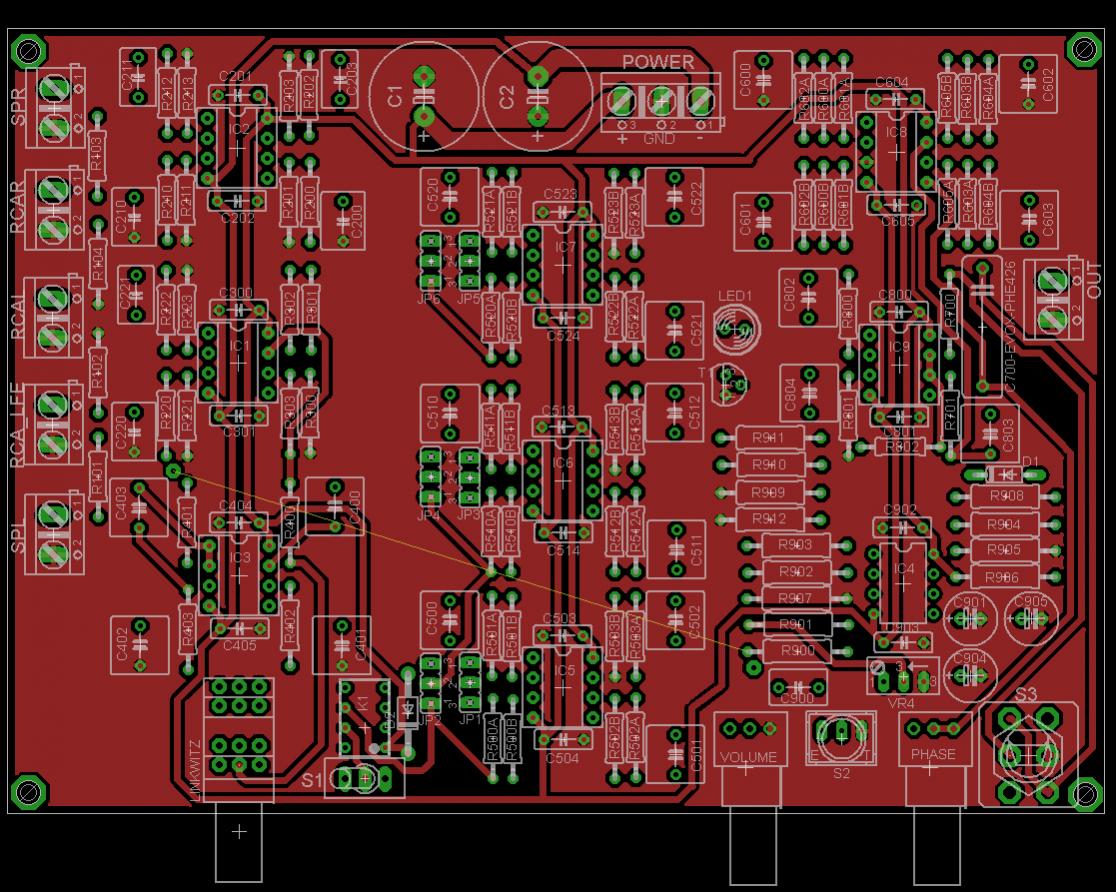

New top layer:
New bottom layer:

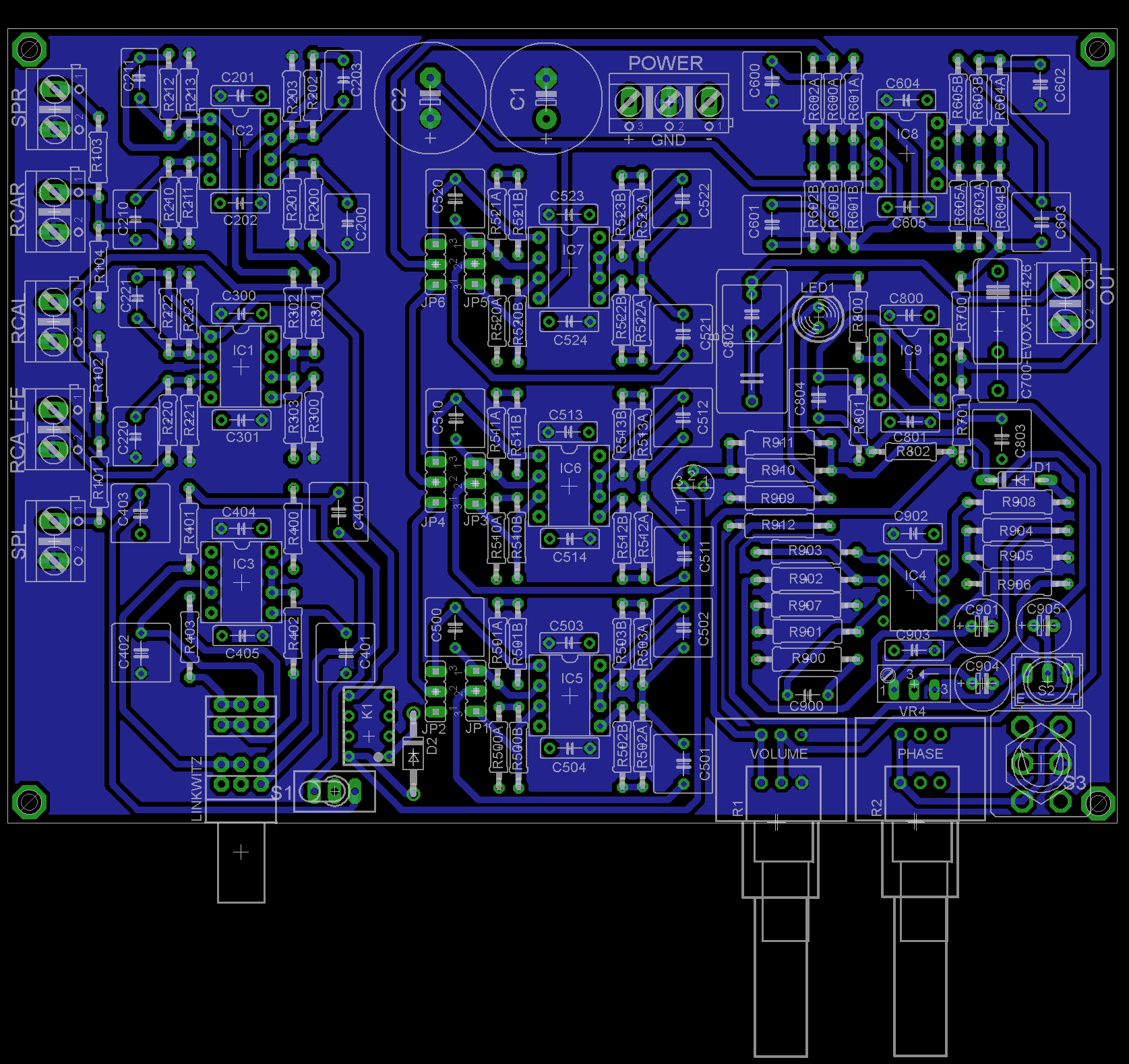

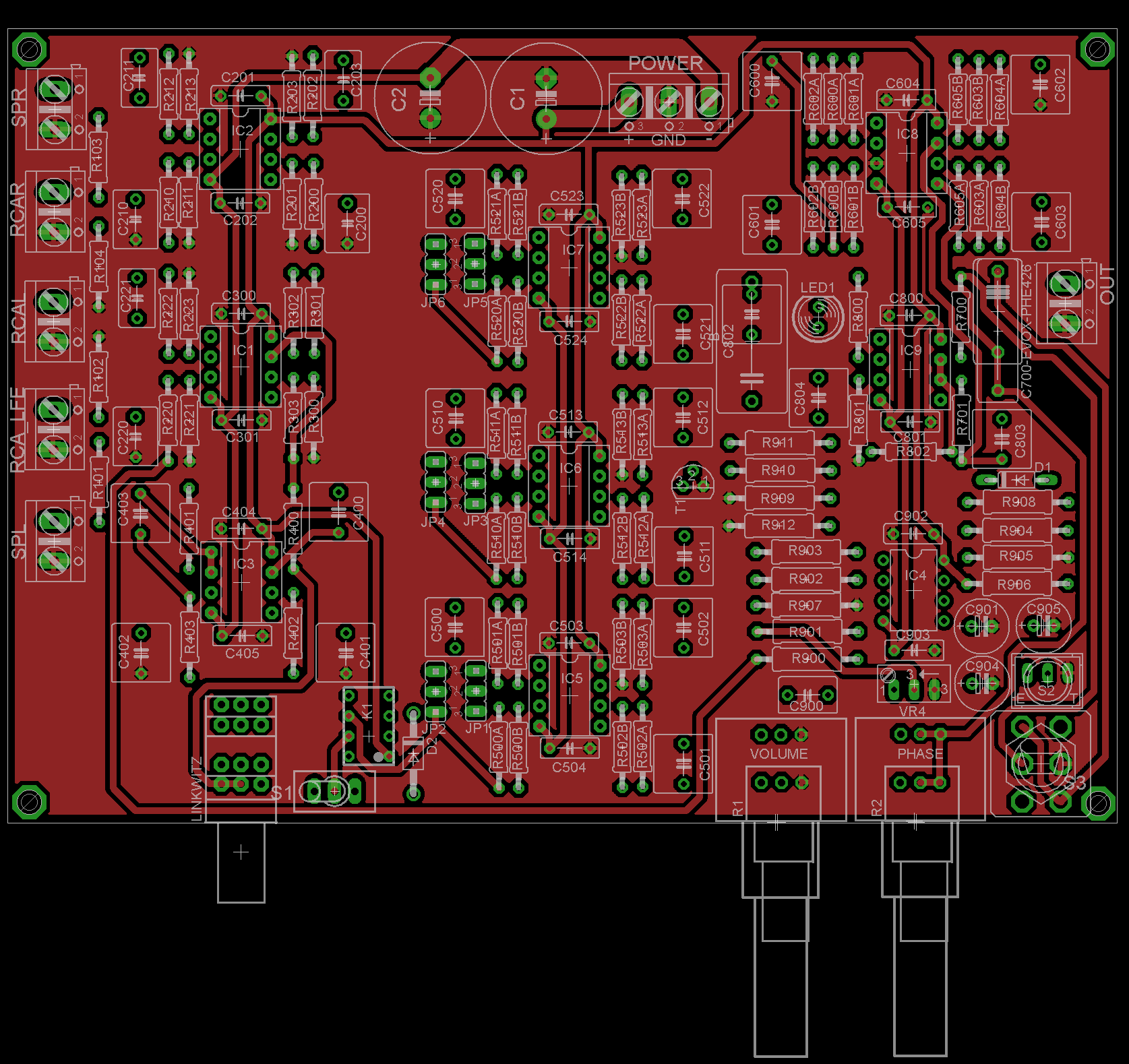

Changes:
-Better power supply lines (shorter and all from the top)
-Option for larger output capacitor (Wima MKS type (larger just wasn't an option on this board))
-Made it possible to use both types of EVOX capacitors for C700 (10mm base and 15mm base)
-Options for both Bourns 90 series, as well as 91 series for the phase and volume control (and many others if you put them off board of course)(the Bourns 904 for the filter frequency is still the only ready available 4-gang pot I have found so far)
-Removed the via and found an on board solution
The Top:
The Bottom:
