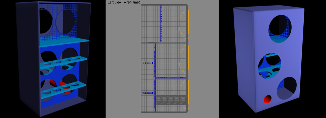

Simon & Quasi -- you two had it right. The general ringing was lack of bracing in the bottom. I ran a sweep from 20 to 100 hz and the box just lit up about 45hz--I thought it might do the out-of-level washing machine thing and just take off across the floor. Some bracing took care of that. I put carpet pad on two sides of the front chamber which got rid of some additional ringing. Thanks again.
Simon: I had a question about the EBS enclosure pictured in your earlier posting. Are those cubbies (square areas with partitions having circular passthroughs) tuned resonance cavities or just a way of doing bracing? Excuse my ignorance, but I've never seen anything like that.

Barton said:Simon: I had a question about the EBS enclosure pictured in your earlier posting. Are those cubbies (square areas with partitions having circular passthroughs) tuned resonance cavities or just a way of doing bracing? Excuse my ignorance, but I've never seen anything like that.
It's just a way of doing bracing, I followed the plan shown on the link above the picture. It's the EBS enclosure plan made by Adire Audio.
The same piece of wood can touch 4 box walls to prevent flexing, very good bracing.
Ahmad_tbp said:hi all
another design , w bracin ... ( a lot bracin !!! )
and maybe a bracin in woofer section ( i show it as wireframe ) ...
and with a left view to show the location of bracings ...
is it goooood ???
Yes, it's good, but I would use smaller holes on the big piece of wood in the center, so that the two braces behind have wood on each side, like in the picture I showed you. It will be stronger this way. I would also push the center piece a bit more in the center, it can be *almost* in the center like I said, just not exactly in the center. I'm a bit perfectionist you know, if you're already satisfied, I think it will sound right already...
You can add bracing in the woofer part if you want to, it can help. But in that part it's more important to use some kind of stuffing. Check around you to see what people use inside speakers for stuffing, stuff like polyfill.
When you are ready to build your box, you can tell us and we will help you calculate everything to remove volume taken by the port, speakers and bracing. Then, we can tell you the final port length. If you are good in mathematics, I guess you can calculate the internal volume easily...
